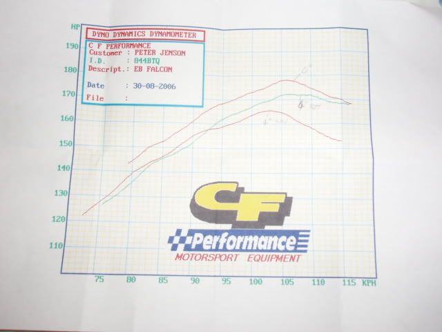

Firstly before i start some more work on my car a want to get it on a dyno again to see how it was running. when i got the cam timing setup they gave me a print out but with no info on it:
what do i need to ask them for (i've read a few times something about shootout mode?) to get the air/fuel, intake temp, gear, and whatever else.

I can't read the scribblings on the printout properly but I think they're all power curves, with the cam timing being advanced and retarted by 4* each way?
No other info shown on the sheet. Not really the best printout!

Does that top line read as 178HP at the rear wheels????

EdFairmontGhia wrote:Does that top line read as 178HP at the rear wheels????
top of the class for this guy. ;)

Commando wrote:I can't read the scribblings on the printout properly but I think they're all power curves, with the cam timing being advanced and retarted by 4* each way?
yeah i know, those are 3 different curves at 4 retard, 0 and 4 advanced. if i can remember the air fuel was around 13.5 i think he said. thats why i'm wanting to know what i have to ask for this time so i get what i want.
and yes it's huge 178@ the wheels........gay
