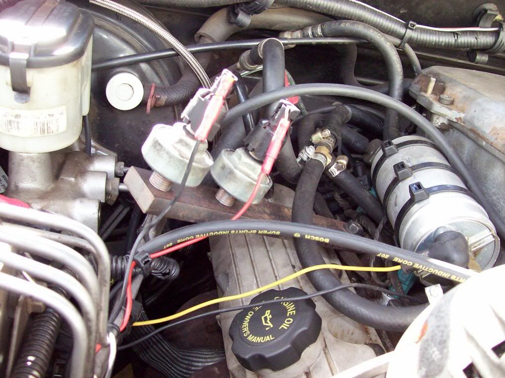

Spent the last few weeks chasing issues with false knock setting off knock sensors, retarding timing big time making it slow and misfire. Would stall up to 2500rpm easy with full timing but once in the low timing map it wouldn't budge past 1500rpm. Probably due to this poor old high km motor being clapped out and suffering some light rod knock and lifter noise etc. Seems I somehow got lucky at the drags as ever since then it would retard timing and generally act up. Ecu reset would fix it for a minute if your lucky. Tried all kinds of things, new sensors etc. Ended up mounting both knock sensors on a 10mm flat bar drilled and tapped and hanging off the bolt were the alternator bracket went to the intake manifold. Seems to have fixed the problem thank god. Obviously I don't care if this motor pops, disabling the knock sensors isnt the safest idea haha. Ecu must also freak out if it does not receive noise as leaving them cable tied out the way didn't work even when I earthed the knock sensors back to battery.
Seems to be going ok again now, might need a corvette servo as 1-2 change is still a bit slippy. Not limiter bashing but definitely struggling. Cracked a 5.8 0-100 just off the footbrake no stalling up which aint bad for a open diff. Got a mini spool ready to fit next.

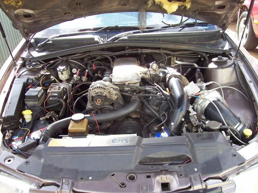

Postby turbo_will » August 13th, 2014, 3:50 pm : NUT347 Likes this post
Pic of relocated knock sensors
Engine bay, yes it is messy remember its just an RnD hack.
All checked over and ready for racing feels strong as just stalling it up. Gave it a quick spray of nitrous in the carpark bakes them instantly haha.
