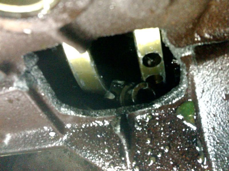

No 3. piston
No 3. with 2 others u can see the wear difference
ANd the main bearing caps,
No 1. Rod cap and bearing
And for those who like the gore, The blocks last way to attack me

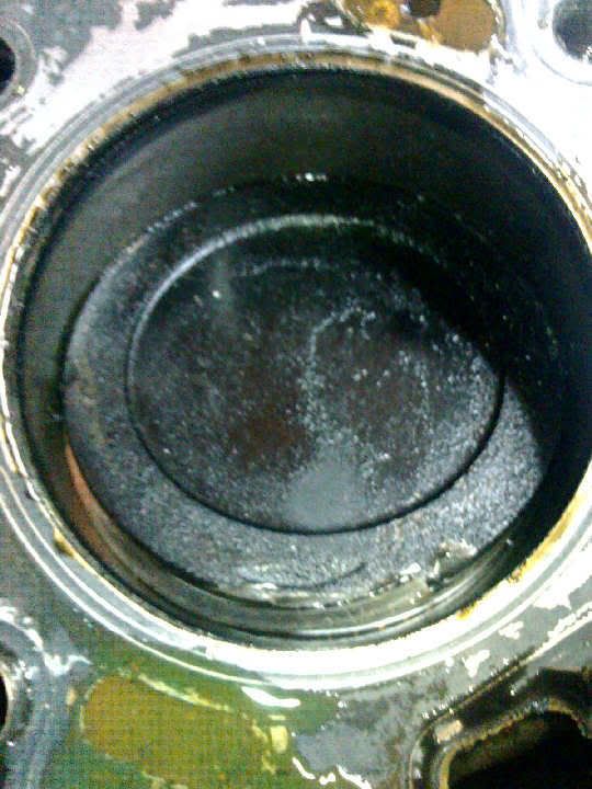

Postby misk » July 11th, 2010, 8:15 pm
well i didnt think my bottom end was fucked lol
but apparently it has other thoughts!
only slightly melted pistons, but the pistons are pretty loose in the bore also.
i put it back together today and it still has mad compression and goes hard, so we'll see how long it lasts with the turbo on it :)
theres about 4 pistons like this

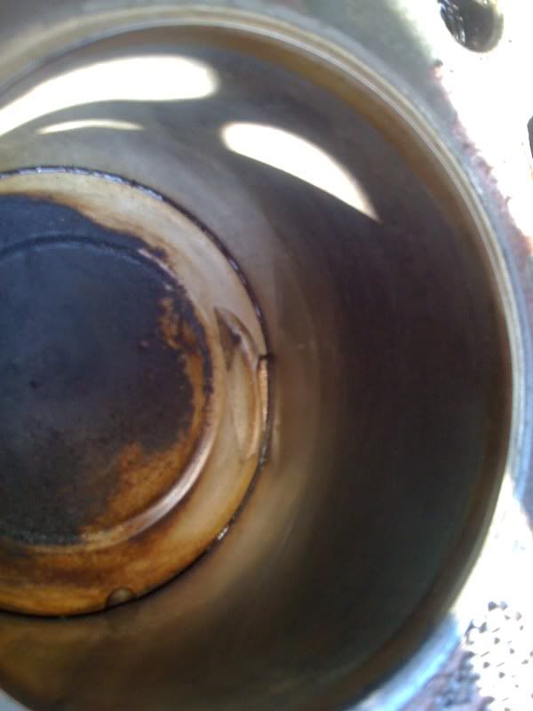

Postby Allen » July 11th, 2010, 9:20 pm
This is what my pistons looked like when I did it's headgasket a few months ago.
Currently its running on 5 cylinders, chewing through oil & generally being a piece of shit... :P

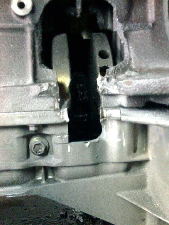

Re: How fucked is your 4L
Postby needfordspeed » July 12th, 2010, 7:21 pm
Posts: 5256
Been Liked: 417 times
1988 Ford S Pack
Postby Sunboost » July 12th, 2010, 7:39 pm
Gill that's fucked. You sure that would happen in a couple of seconds?

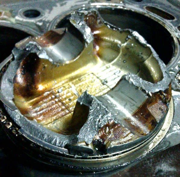

Postby Rollin » July 12th, 2010, 8:05 pm
WILDEB - Turbo AU engine + Shell fuel = Fail.

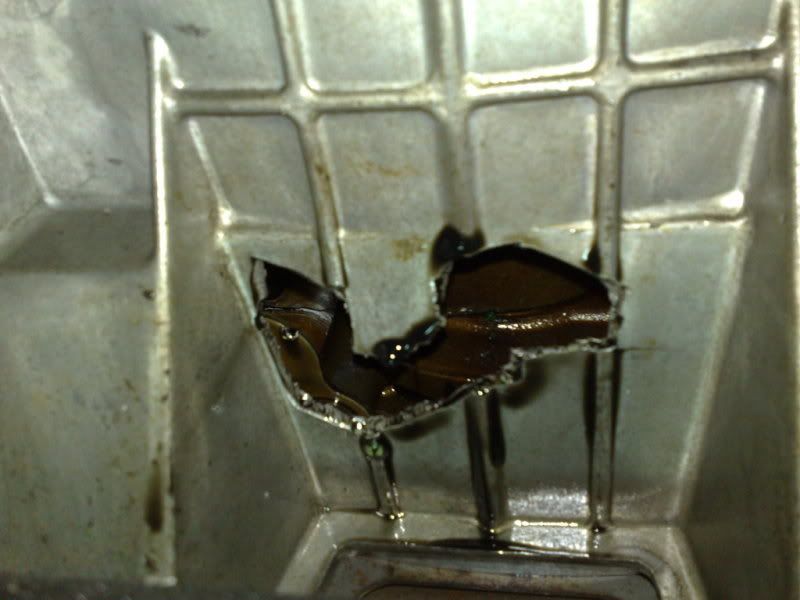

This is another of Gozzas engines, this one hydraulic'd due to an amazing combination of failed PCV valve in an AU motor fitted with a turbo and a log (ED style) manifold. Big revs then a lift off in gear meant it sucked a whole lot of oil into the manifold, then on the gas again and the turbo pushed all the oil into the rear cylinder. It wasn't pretty. The gudgeon pin was wedged against the crank so hard that we couldn't turn the motor on the starter or with a breaker bar OR with a starter and a breaker bar together, so we had to cut the side of the block out to turn the crank so we could undo the converter bolts....
Postby needfordspeed » July 12th, 2010, 8:31 pm
Sundeep wrote:Gill that's fucked. You sure that would happen in a couple of seconds?
From what you could see while it was in the block....id think it could. But once I pulled it out there's no way it happened in only a few seconds! RT reckons it's been running lean for ages, was a stupid thing to drive it so much untuned, don't know what I was thinking! Even if you kunts egg me on i'm never doing this again :P
Posts: 5256
1988 Ford S Pack
