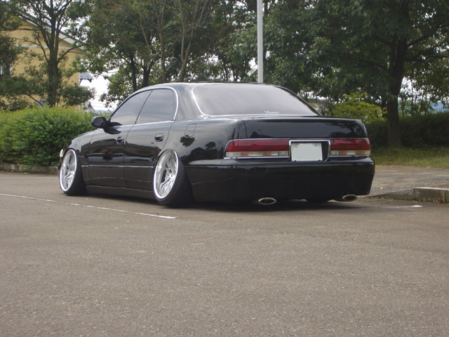

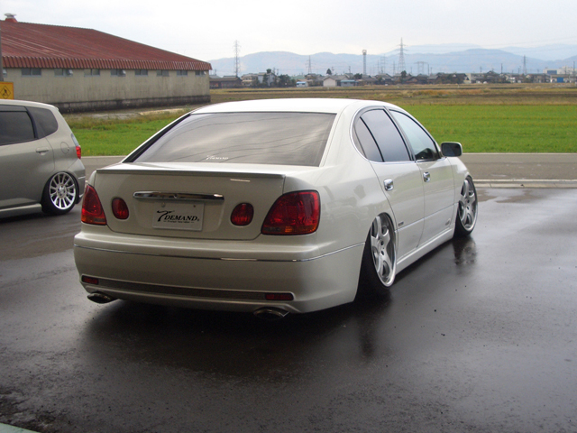

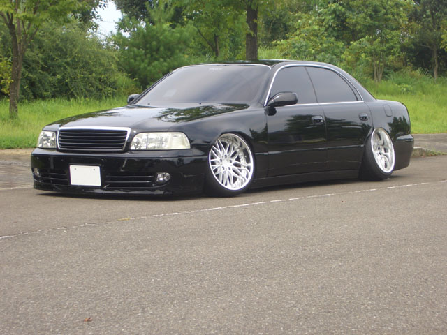

Postby pagey » September 12th, 2010, 7:27 am
...looks more like some car thief stole their springs.
Seriously though, has anyone else have/had negative camber before? Did you notice a big increase on handling?

Postby Rollin » September 12th, 2010, 9:14 am
Those cars look like they've been dropped from a decent height to me...japanese have some strange fads.
pagey - it depends on what you use the car for as to how much neg camber you should run. About 1.25 degrees (or 1 degree 15 minutes if the W/A machine reads that way) is probably good for a lowered falcon that gets driven with a bit of enthusiasm. If you don't punish the car into corners much then you'd want less, if you get on it all the time and have 15/16/17" tyres you'll probably want more.

Postby Troutman » September 12th, 2010, 1:59 pm
I think you'd find there is no functional benefit to the set-up in those pics.
