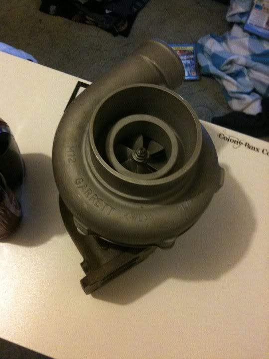

allright so when i picked up my turbo kit the guy said it was a garrett T70, i went and seen the closet tuner to me and he said it was a T04e and theres no such thing as a T70 its doing my head in how can i tell them apart? should i email garrett the codes off it?

Garret doesnt make a T70 so it is likely a T04e.
T70 is either masterpower or ebay junk.

Postby Malakai » September 18th, 2010, 1:26 am
Got a pic of it? Post it up.

didnt garrett do a proper T70 or T72 or something?
T04e arent a bad turbo, they come in a million different combos though, so just need to get the best wheel sizes to suit the build

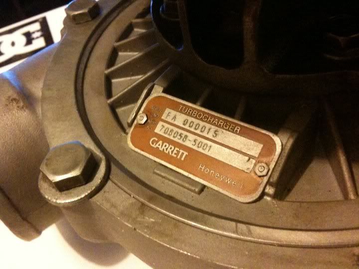

Postby EF ECTIV » September 18th, 2010, 6:31 pm
by chucking 706058 - 5001 into google, seems to be a t04e\58... Thats about all anyone could work out....

Postby Malakai » September 18th, 2010, 11:50 pm
Yeah I found this thread on another forum: http://www.ausrotary.com/viewtopic.php? ... 51&start=0
I imagine that is what EF ECTIV is referencing too.

Postby EF ECTIV » September 19th, 2010, 12:59 am
yep... thatd be the one... 2mins and the model number into google...
