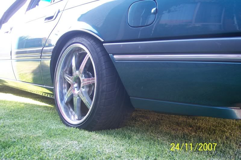

holmsy wrote:luxo has 10's on the back of his fairlane.
yep, 18x10 with 265/35/18's
18x8.5 with 235/40/18 on the front

Postby Mr_4.0 » December 8th, 2007, 12:31 am
i have a set of prostarts im using at the drags. they are the perfect offset for me. i have 265's on them, no guard lipping, and room to spare. not sure exactly WHAT offset it is though.......

Postby LUXO_8 » December 8th, 2007, 6:20 am
Mr_4.0 wrote:.
hey wayne, whats the offset of you 18x10's?
not exactly sure john, but they fit perfect with 35mm hub adaptors, so im tipping somewhere around +30 - +40.

Re: Wheel sizes
Postby krisisdog » December 8th, 2007, 9:16 am
supras had up to 50mm offset from the factory for the 9.5" wide rims.
18x10s are fekin tuff.
