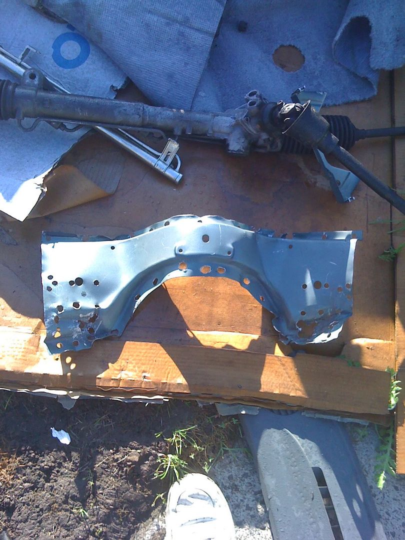

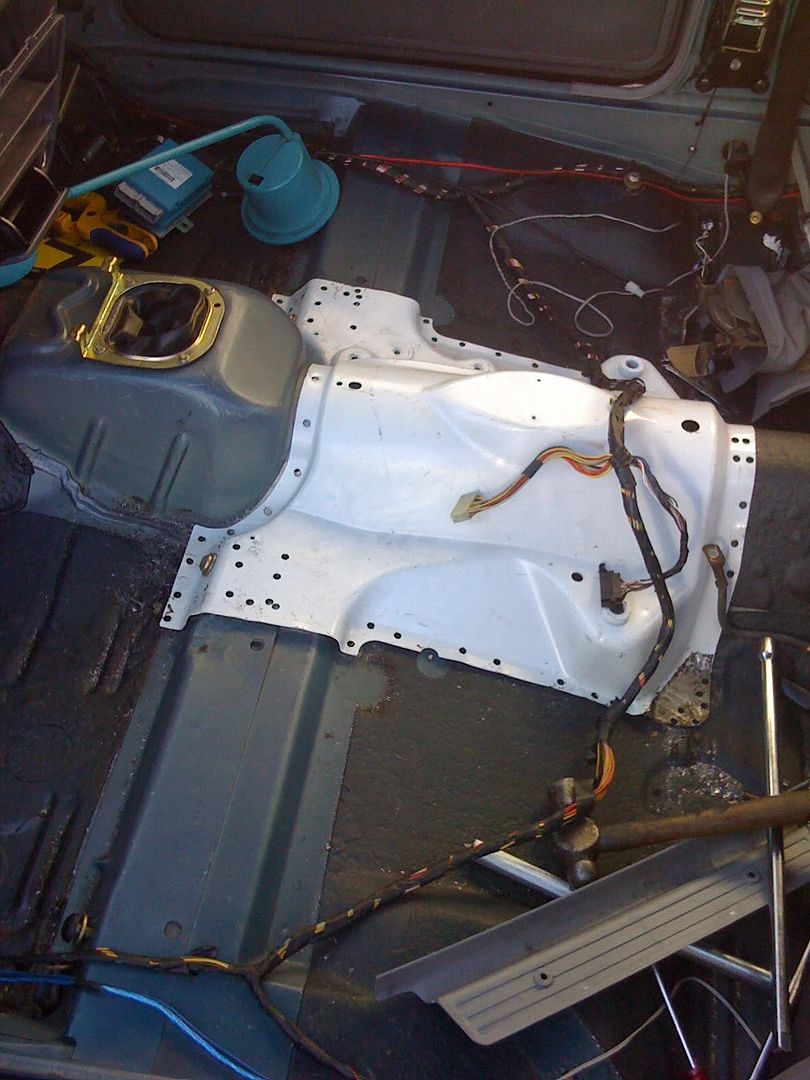

Here is the floorsection from when I did mine:
Old:
New:

The brake booster will bolt in without any dramas, but to fit up ABS you will need to use all of your brake lines from the EL and use an EL Diff, front brakes which you may want to consider a K Frame swap and take advantage of all the EL equipment. The ABS Unit will need to have holes drilled in to mount up. But if you use an EL Diff you will want to get the handbrake mounts off the EL and drill a hole in the floor, with the EL Floorsection in and the other associated equipment you can take advantage of the Floor mounted handbrake.
