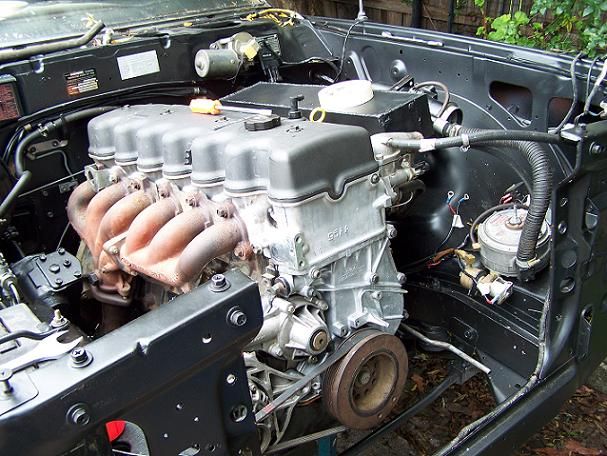

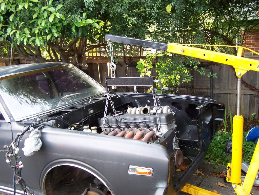

Postby datsonovic » May 23rd, 2012, 2:34 pm
So it has taken a little longer than first thought, But I have just done the first test fit of the EL 4.0 into uncle cedric (`78 Datsun 280C) and it seems that with a little engineering it should be quite a good fit.
I`ll have to make up a new sump and engine / transmission mounts as well as modify the drive shaft to suit the datto center bearing and "massage" the trans. tunnel a little.
I have decided not to run A/C or power steering, as I want to keep the engine bay as un-cluttered as possible. This leads me to my first question:
What are my chances of converting the EL 4.0 to run a V-belt instead of the flat (slurpintine) belts to run the alternator and water pump? I think I might have to run a different water pump as it is driven from the back of the standard belt and runs in the opposite direction to the crank and alternator.

I have decided to retain the standard pulley system and just use a shorter drive belt ( I wasn`t too keen on using XE-XF gear as I belive the el alternator to be a superior unit),
I have also decided to run a Davies Craig electric water pump and controller ( I have gutted the standard water pump and removed the drive pulley.)
I have ditched the idea of running a TCU and decided to try and get the standard ECU to work ( it will be only used for ignition control and transmission control) hopefuly it will operate with only TPS,MAP snesor, knock sensor, speed sensor, pwr/econ. switch?.
I have fabricated the engine mounts, transmission mount, trans tunnel, drive shaft, inlet plenum, oil pick-up, and sump plus a few other bits and bobs.
So most of the easy stuff is sorted now I have to try and sort out the electrical side of things, I`m hoping that i will just be a case of powering up the ECU and retaining the rest of the standard datsun electrics, but things are never that easy.
I have had a little bit of trouble with the sump gasket as I cut and shut the sump with the standard gasket in place and the only replacement gasket I could find was a cork three piece item ( 1-2mm) as opposed to the original one piece rubber one ( 5-6mm) and as such the bottom of the sump is hitting the oil pump and not sealing around the front of the motor. I think im going to have to massage the sump a little to get some clearance (Damn it!).
Does anyone know of a supplier of the original sump gasket, I have tried Repco,Sparco,Bursons, Ebay, I even tried Ford spare parts and they told me that it had been deleted.?
So with a bit of luck and a fair breeze I should have it running in the next few weeks.
Any thoughts or ideas would be greatly appriciated.
Cheers.
