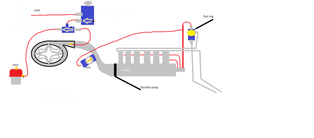

Postby xxxr6t » January 7th, 2012, 9:26 pm
im having a problem trying to connect my manual boost controller im not sure if i have done it right i have a picture i have drawn of how i have it set up how do i upload it
sorry still pretty new to this sit and turbo's

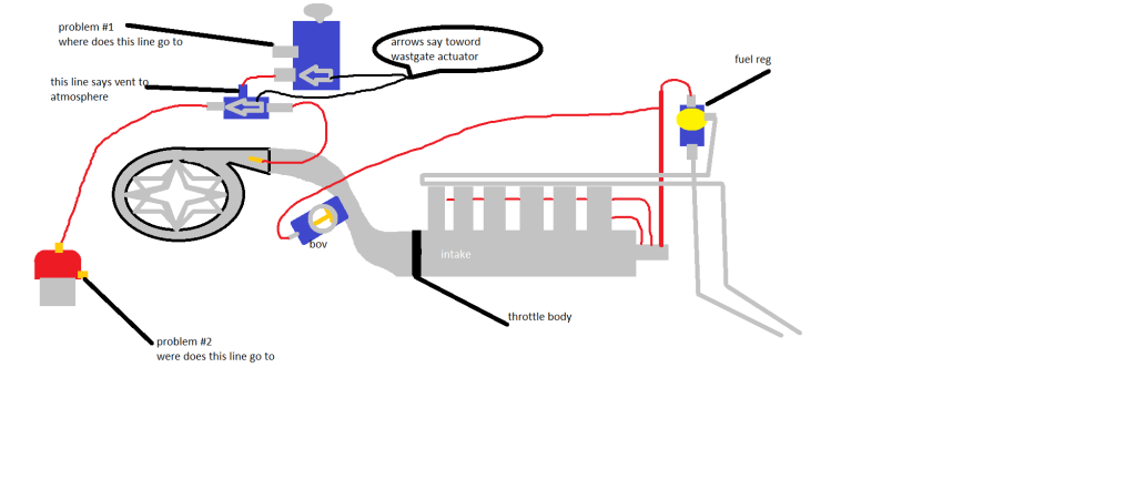

Postby xxxr6t » January 7th, 2012, 9:33 pm
is this correct if you click on the pic you can see where i have written and where my problems are

Re: manual boost controller set up
Postby TAXI » January 7th, 2012, 10:49 pm
yhe one on the top port of the gate move it to the bottom, and the line off the tee that has to go through the controller where you have it and the top of controller just run a hose away from the cab
Postby xxxr6t » January 7th, 2012, 11:00 pm
TAXI wrote:yhe one on the top port of the gate move it to the bottom, and the line off the tee that has to go through the controller where you have it and the top of controller just run a hose away from the cab
so like this
Postby TAXI » January 7th, 2012, 11:01 pm
yep
Postby xxxr6t » January 7th, 2012, 11:05 pm
the t piece says bleed to atmosphere do i just ignore it
Postby TAXI » January 7th, 2012, 11:08 pm
you are venting it through the controller
Postby TAXI » January 7th, 2012, 11:18 pm
yep thats how you turn up the boost more venting is more boost.
Postby TAXI » January 7th, 2012, 11:22 pm
dont worry about the top of the gate thats above the diapragm doesnt do anything
