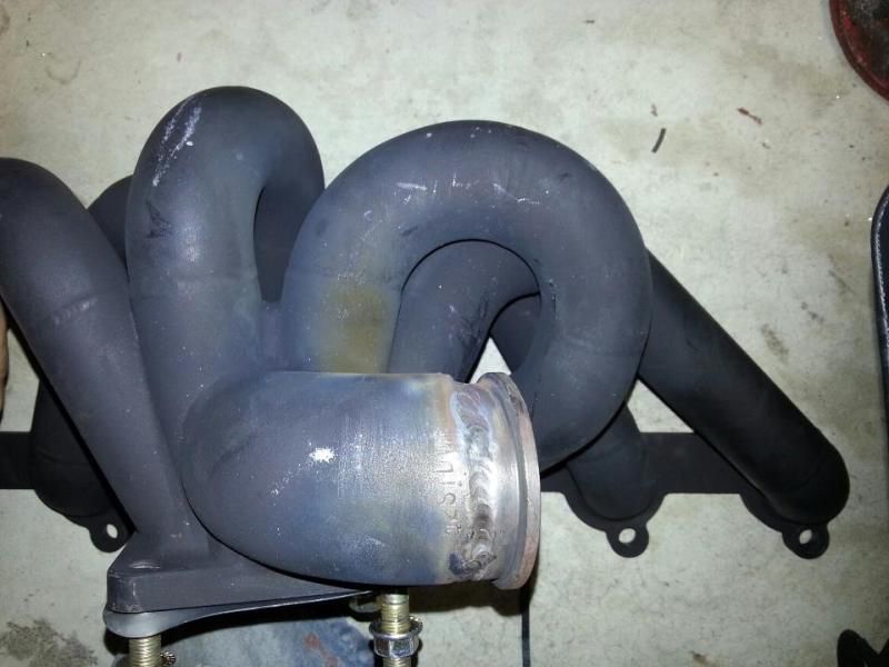

I've recently borrowed my uncles cigweld inverter stick welder which has a lift tig function to have a practice with.
I allready had the gas for mig ally. mig welds so much smoother with gas to, I wouldn't go back to gasless unless I was stuck.
so with only mig experience I watched a few youtube vid on scratch start tig techniques then had a practice on some 3 inch stainless exhaust tube, using mig wire as filler rod.
then my mate gave me the challenge of welding his tial wastegate flange to his new 6boost manifold and this is way I came up with.
I was quite happy with the results, and tig seemed pretty easy to pickup

beign a welder i wouldnt bother fuckign around with that for the price of a dc invertor you might aswell go buy one.
I also wouldnt bother miging alloy unless it was 10mm thick or a big/repetitive job.
Also i'd avoid welding stainless with a scratch tig and MS mig wire unless it was your only choice
