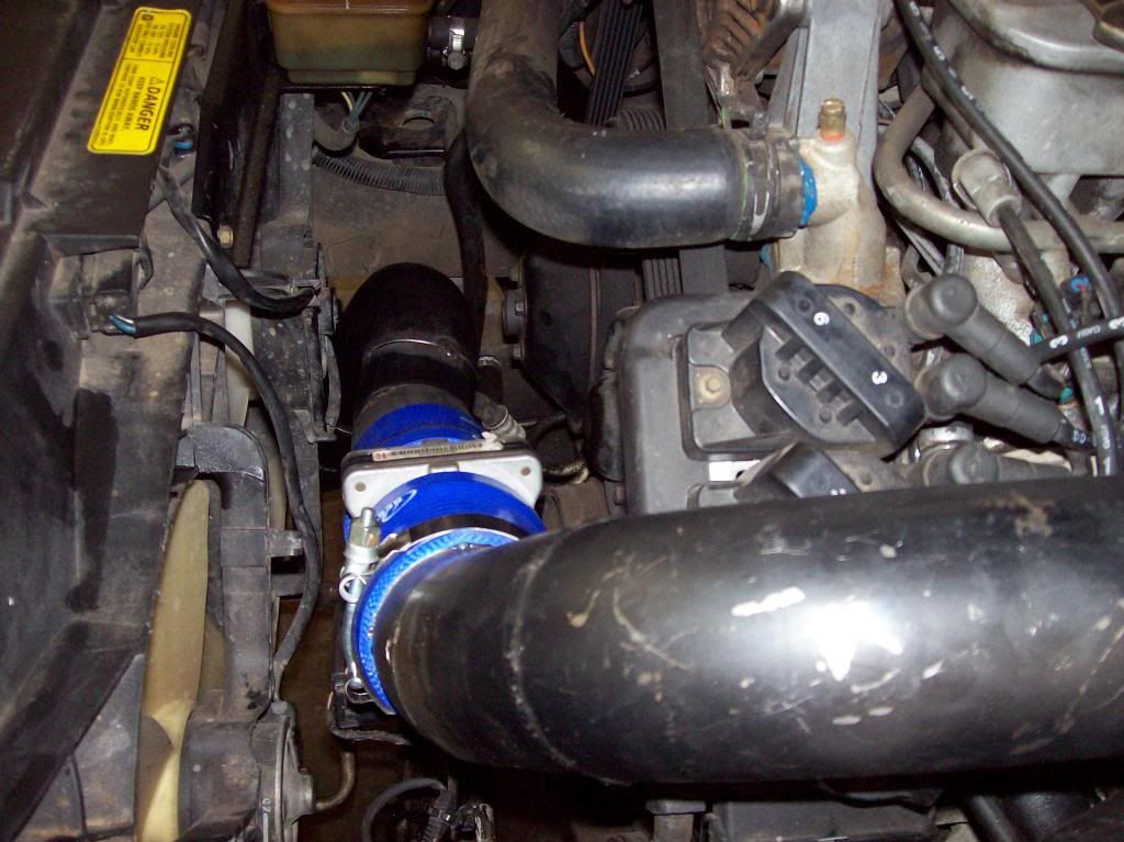

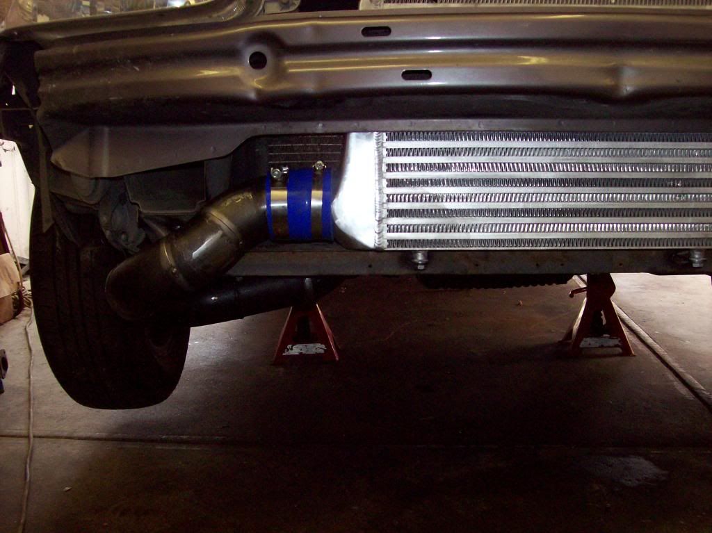

So I have another project, seeing as its a commo I thought id put it in here.
The car is just a base model, auto, 250K kms and in rather average condition but hey it was cheap and a perfect car to use for an R&D mule. Not planning on going overboard spending big coin on brand name parts this will all be all about keeping it cost effective. Plans are simple really, develop turbo kit to the point of a 12.99 or better as a start.
Motor and trans will stay stock for a start. Rear main seal leaks so that will need doing first. Plans will be to push standard parts to find the limits. Ill look into some kind of shift kit for the auto aswell.
Turbo hardware will be carried over from our falcon kits so it shouldn't be raising a sweat in the VT shooting for 12s with ecu probably being the limiting factor. Turbo is positioned roughly like this.

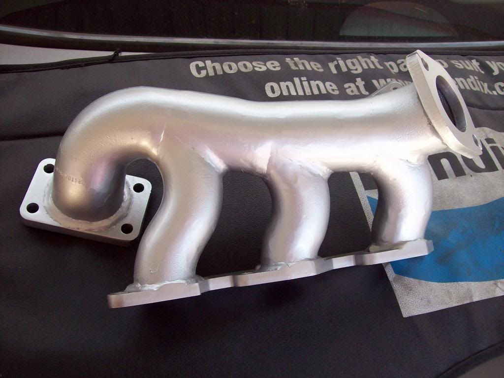

Trying a simple fabricated passenger manifold as the stock LH manifold sits in a crappy position with no room for an up-pipe and dump pipe so has to be a fabricated jobby.
A/C actually works in this car so its staying although ditching it would make life so much easier with added room. Not sure on exhaust probably make up a cheap 3" single muffler system. Ill be sticking with the stock ecu and playing around with other means of getting desired result such as fuel pressures, extra injectors, water injection and maybe e85 at a later date. Ive read its possible to use the l67 tune/injectors (supercharged v6) which may be a good option as no doubt it would run less timing on boost and we all know its too much timing that kills ring lands and melts holes in pistons. Been there haha. Anyway keen to get cracking and race the tyres off this thing. Still have a crap load to do but ill keep updated on how this all goes, should be fun, im super excited to have a new car to mess around with and learn new things on. That said im still working on the ef its just at a point were its ready to race but no racing for few months.

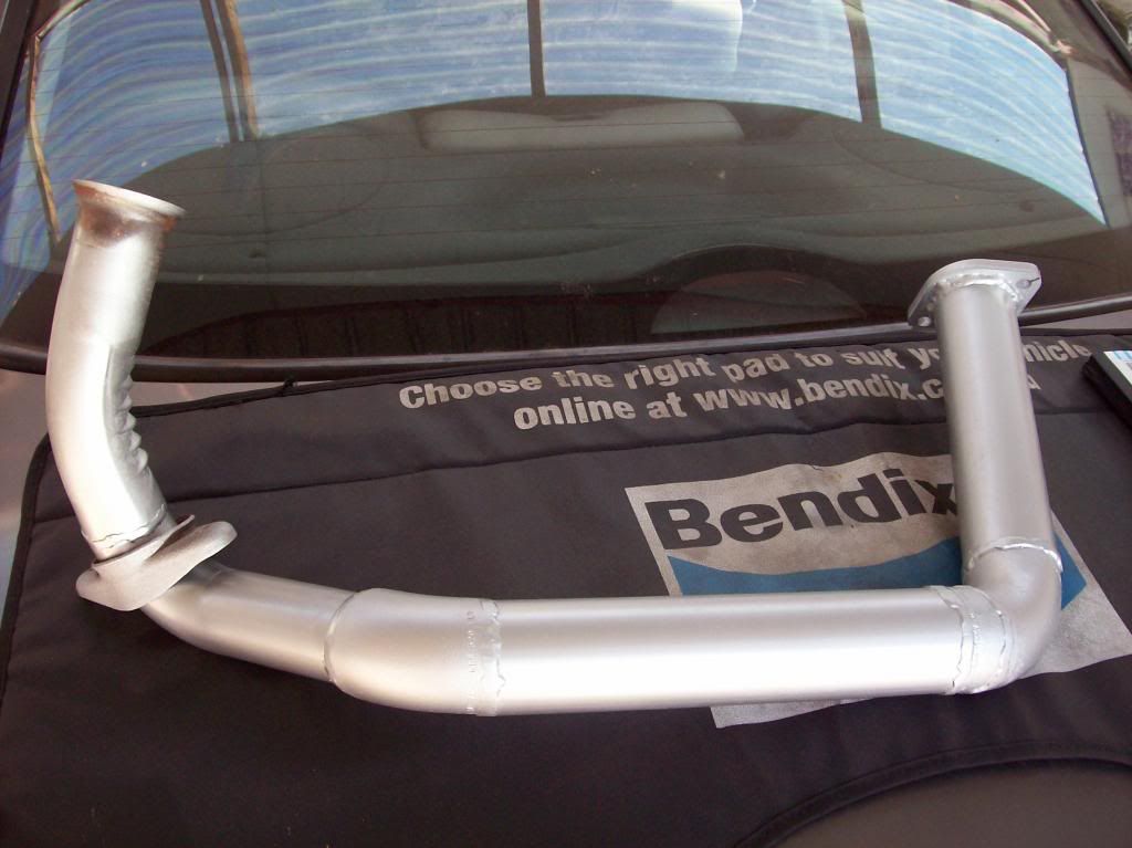

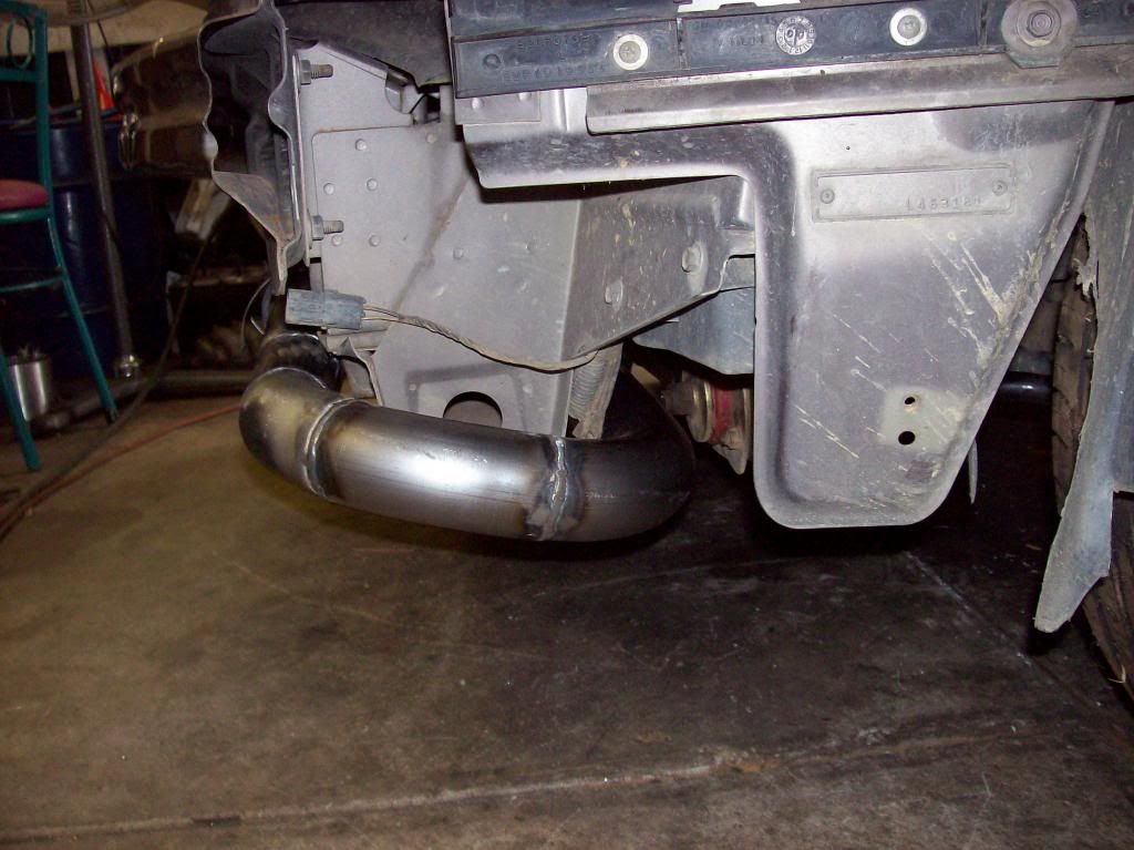

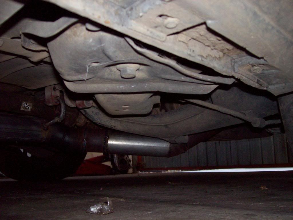

Made up a dump pipe today in 3inch and got the w/gate mounted were it will work for screamer and plumb back. I also started messing around with cold side cooler piping ended with this. Im going to try going over the coil pack with a 90degree silicone bend off throttle body and see how that turns out, might look neater and be shorter.
Also forgot to post timed increments for this car when it was 100% standard. 0-100 8.39sec, 1/4 15.79@89mph, 90-140kph 7.78sec and 140-150 took 2.89 just for a laugh. Definitely needs more power!
Cheers Guys

Yea they are heavy cars the VTs around 1600-1700kg apparently. Manifolds can be reversed but the drivers side ends up hitting power steering and passenger side points too high and forward as well as spark plug clearance issues. The plenums can be cut and shut to be reversed but I will leave it standard for now I reckon. Certainly a lot more **** to set up than the falcons haha.

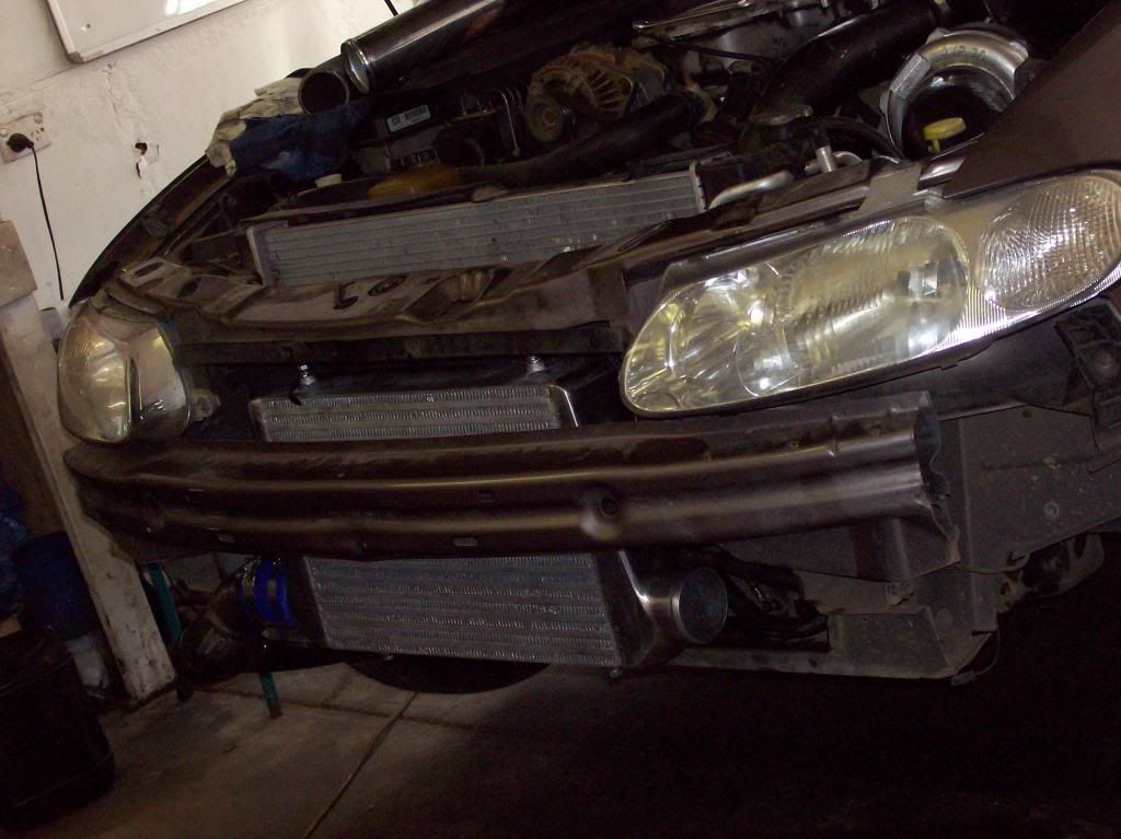

Postby galapogos01 » January 5th, 2014, 3:02 pm
Nice project, look forward to seeing this do some runs!
See http://pcmhacking.net/forums/ for some info on cheap tuning for Commos.
Swapping the plenum inlet to the drivers side would help with cooler piping a lot eh!

Postby turbo_will » January 5th, 2014, 3:55 pm

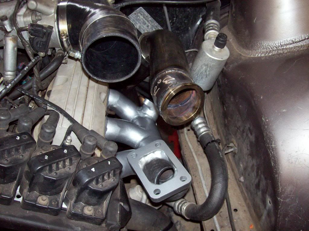

Yea your right guys reversing the plenum would be a great idea with shorter piping away from heat and easy enough. Its just a lot of owners probably dont want to have to change to a reversed plenum just to run the kit, just setting it up like this as a start.
Cheers Jason ive checked out all that gear a while back still cant find a bin and def that match for a vt v6 auto all tables just comes up as zeros. For now ill be keeping it simple and running stock ecu/tune with a few psi just to keep rollin happy :grin: If its lean then fmu or extra injector will be added. If its knocking water injection, l67 chip/injectors or e85. For a start ill probably just run a yellow 4psi tial spring. NFI what timing they run.

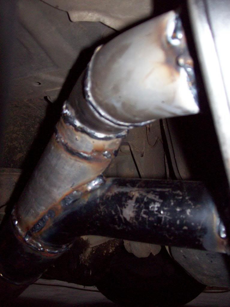

Got the manifold and dump pipe welded today that is all, too hot haha.

Postby turbo_will » January 19th, 2014, 1:50 pm

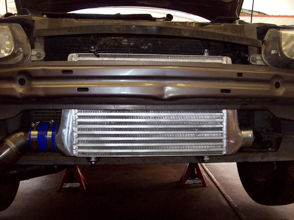

Got the cooler mounted using the smaller 450x300 core for this project, ill probably paint it black should blend in nicely. It fits without any cutting of the rad support or crash bar etc. Had to unbolt receiver dryer and move it over, tweak ac lines and remove trans cooler and move it up all prity basic stuff. Tacked together the cold side piping from scrap left overs in 3", it has plenty of clearance for engine rocking/limiter bashing. Going to do hot side in 2.5" soon.
turbo_will

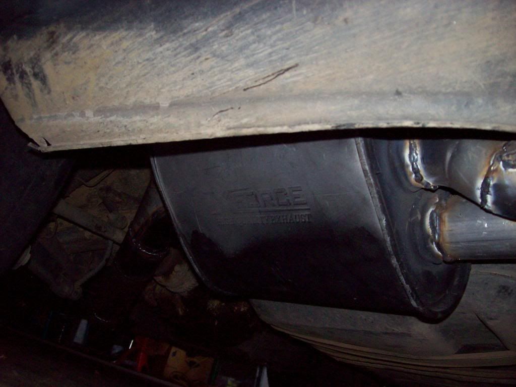

Postby turbo_will » February 2nd, 2014, 7:37 am : misk Likes this post

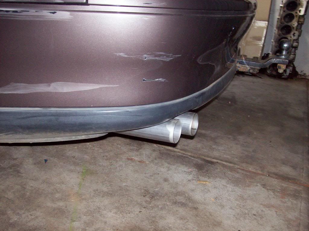

Made an exhaust yesterday from what I had laying around. Single 3" from dump pipe to under drive shaft, then splits into twin 2.5" through a straight through x force muffler off a BA xr6t chopped up to fit and mounted were rear muffler used to go. Fits alright and should still be fairly quiet being turbo. Most of it was aluminiumised pipe which welds shithouse bit like galv, got a few burns from splatters laying under the car welding haha.
turbo_will

Postby turbo_will » February 9th, 2014, 7:17 pm
Finished the turbo manifold and made up a crossover pipe today. Got it running too, first time in a while which was good and burnt all the shit out of the new exhaust. Haha forgot to put the dipstick back in so didn't rev it much as oil would splash out but seems to sound ok and still prity quiet at idle. Still need to make hot side piping, heat shielding and screamer pipe then its prity much ready for a lung full of boost.
turbo_will

Re: Project 12s Turbo VT V6
Postby justa6 » February 9th, 2014, 7:34 pm
That's a neat looking manifold dude , well done.
477rwkw 24psi. 9.80 @ 145mph
justa6
Posts: 2986
Has Liked: 88 times
Been Liked: 525 times
1999 Ford xr6 ute
Postby EBOOST » February 9th, 2014, 8:07 pm
Yeah really good job mate looks fantastic.
Get Stroked!!
AU Stroked 5.6L Ghia.
EBOOST
Posts: 3506
Has Liked: 437 times
Been Liked: 93 times
Postby Rollin » February 9th, 2014, 9:21 pm
I hope you're going to heavily shield that AC pipe!!
Postby turbo_will » February 10th, 2014, 5:33 pm
Cheers guys, tried to make a simple design that would still flow ok. Yea rollin that ac line, coilpack and the bottom rad hose will all need proper heat shielding. The Ac line is in a bitch of a spot on these.

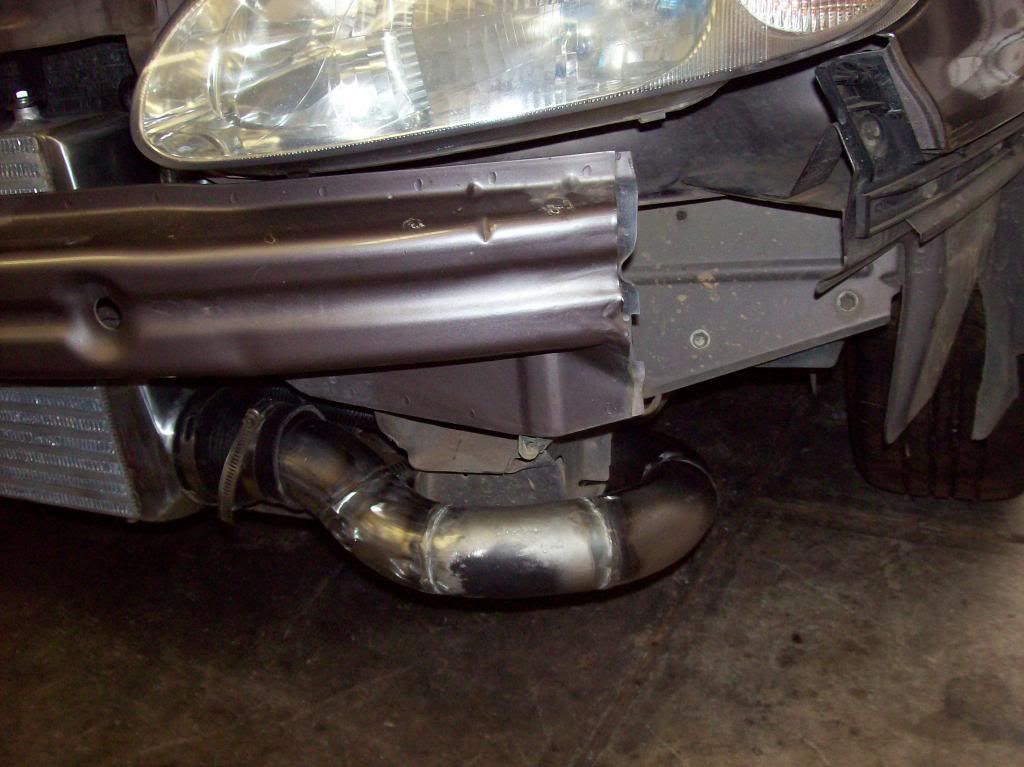

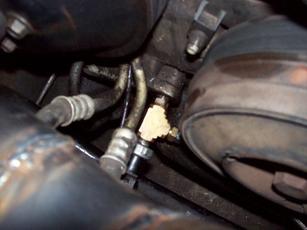

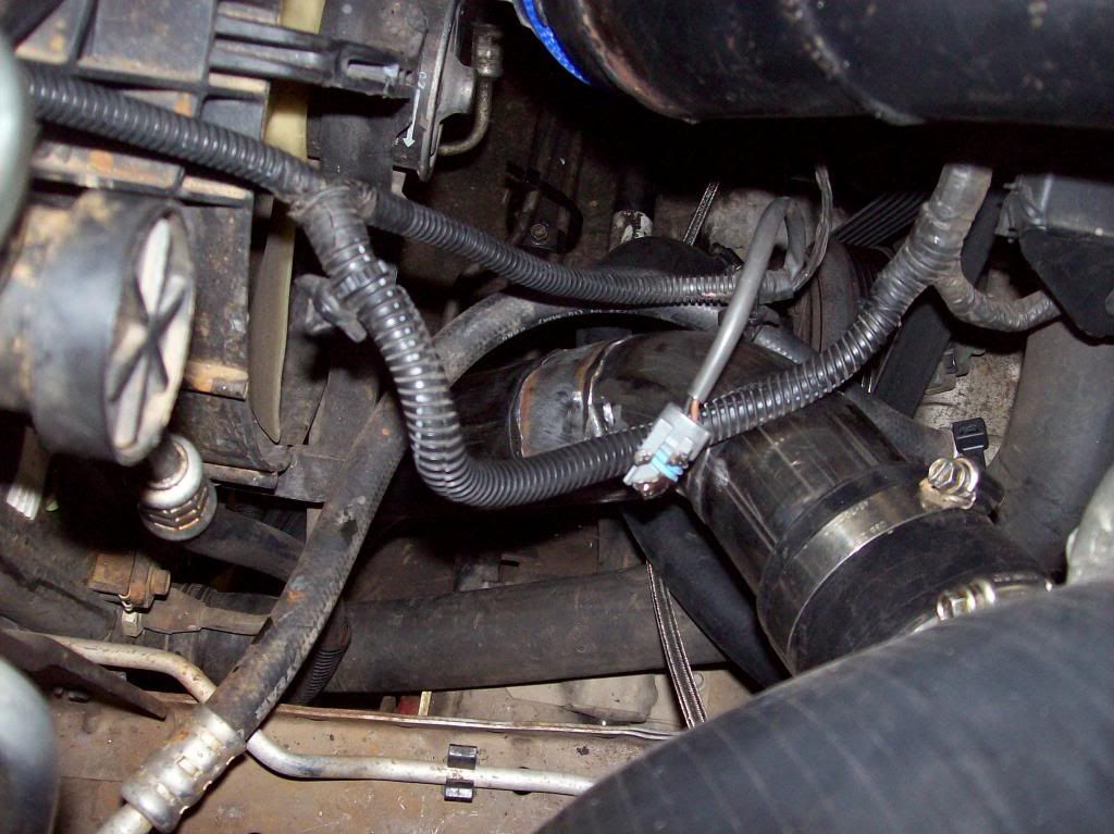

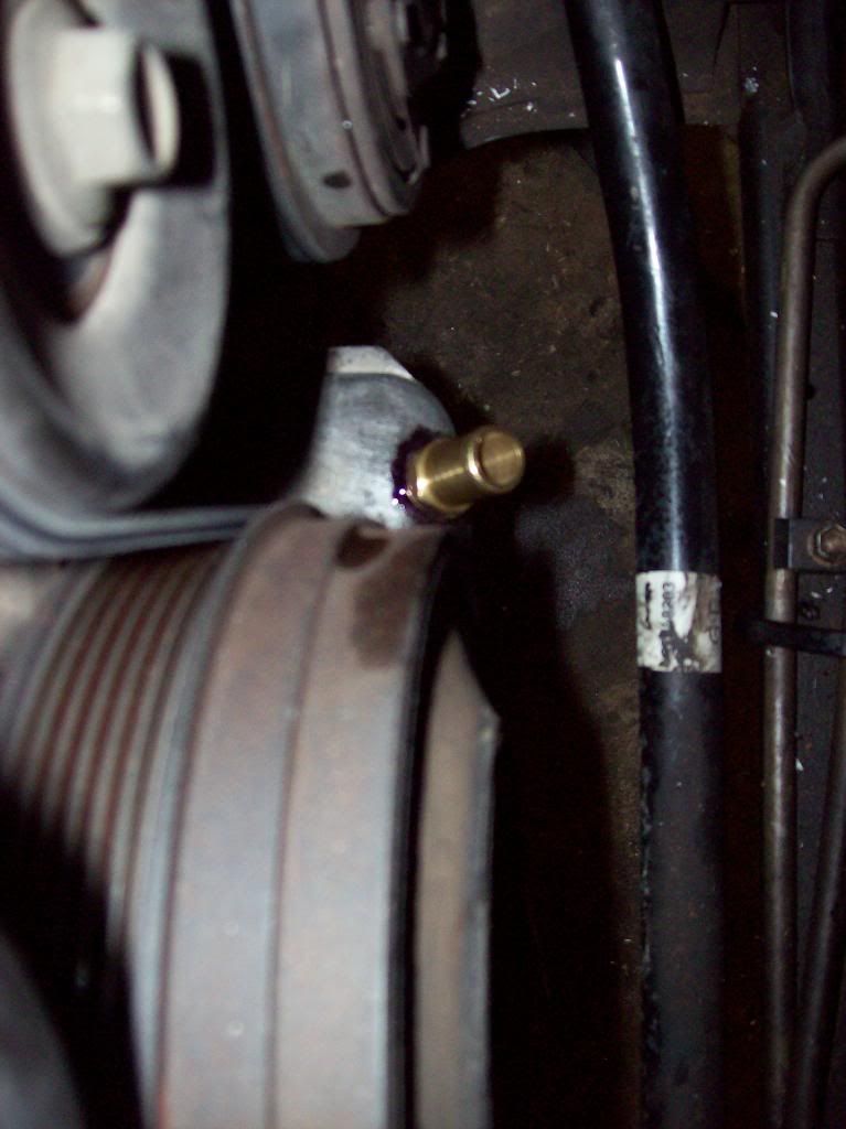

Postby turbo_will » March 23rd, 2014, 6:08 pm
Got this almost finished just needs fuel system/heat shielding stuff. Had it running makes a few psi on the brake prity easy.
Tapped the sump for the drain.
Tee piece for oil feed
Hot side piping done in 2.5" still needs painting
Also picked this up cheap the other day, vx ls1 berlina. Has few issues, abs module dead, radiator leaks, oil leaks etc. Will be boosting this as soon as ive fixed all the problems with it.
