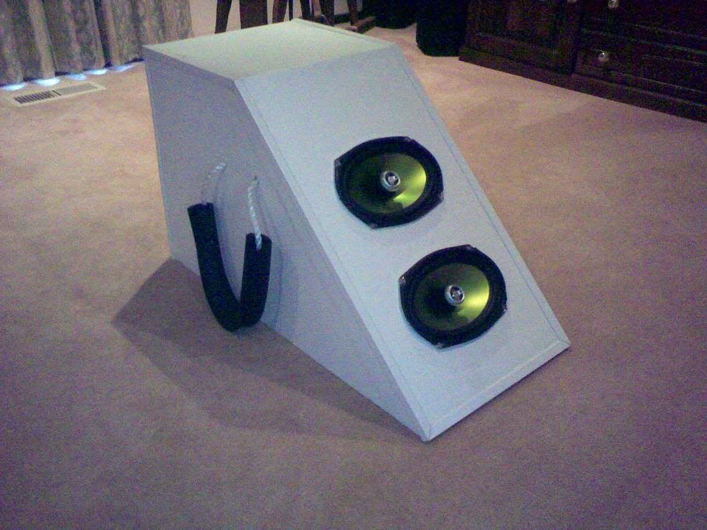

Postby Hybrid34 » January 28th, 2009, 5:02 pm

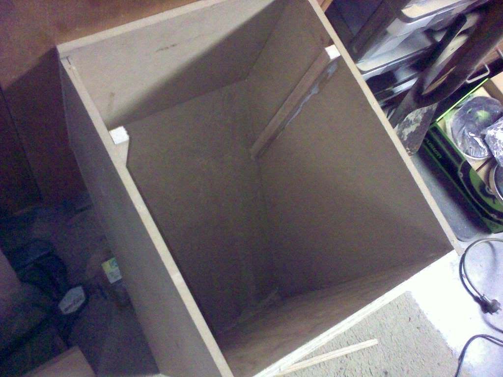

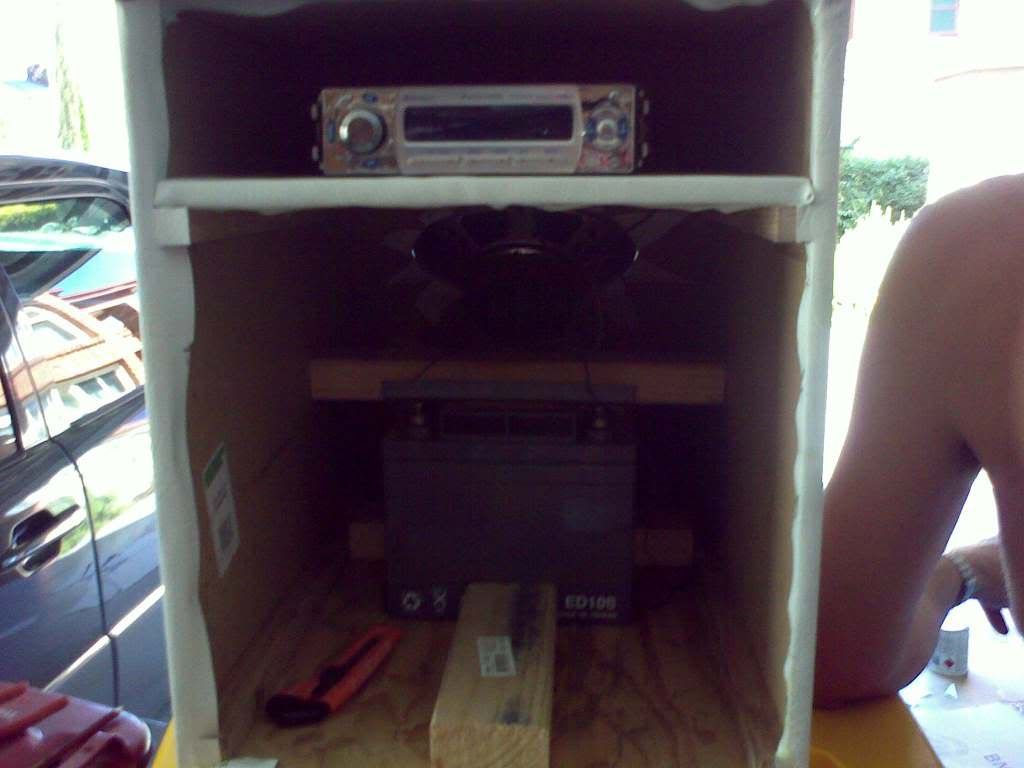

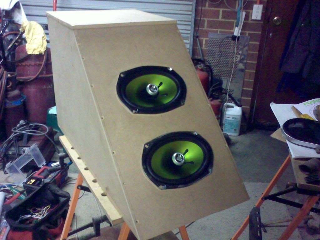

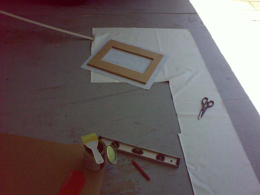

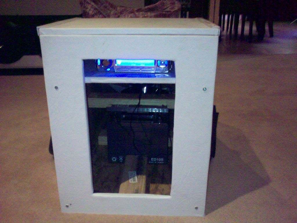

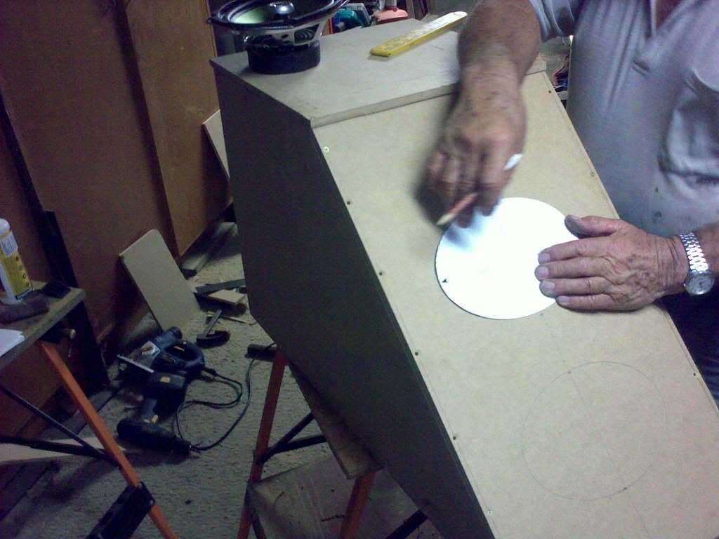

I finally got around to building my home made 'Ghetto Blaster', took a day n a half to complete, since its to hot to be outside today (42degrees) I thought i'd tell ya'll how i did it.
Inspiration came across when sitting at the beach wanting to listen to music (like all of us do), your typical mobile phone sound is pretty shitty quality) and those portable cd players eat through the D size and C size batteries like an abbo with a maccas meal. So I thought I'd come up with something a bit more powerful and long lasting (yet not so portable for a single person to carry).
Consists of:
12mm MDF wood (6 Pieces)
20MM Particle board Screws
Nails
2 Metres of 12mm Rope (for handles)
White Vinyl Sheeting to cover the wood
PVC glue
Adhesive glue
2 6x9's 240watt Fusion Speakers (got em on speical $25)
35A.H Gel Battery
Panasonic H/U Mp3 player
Ipod / mp3player conector
Aligator clips (to clamp onto battery).

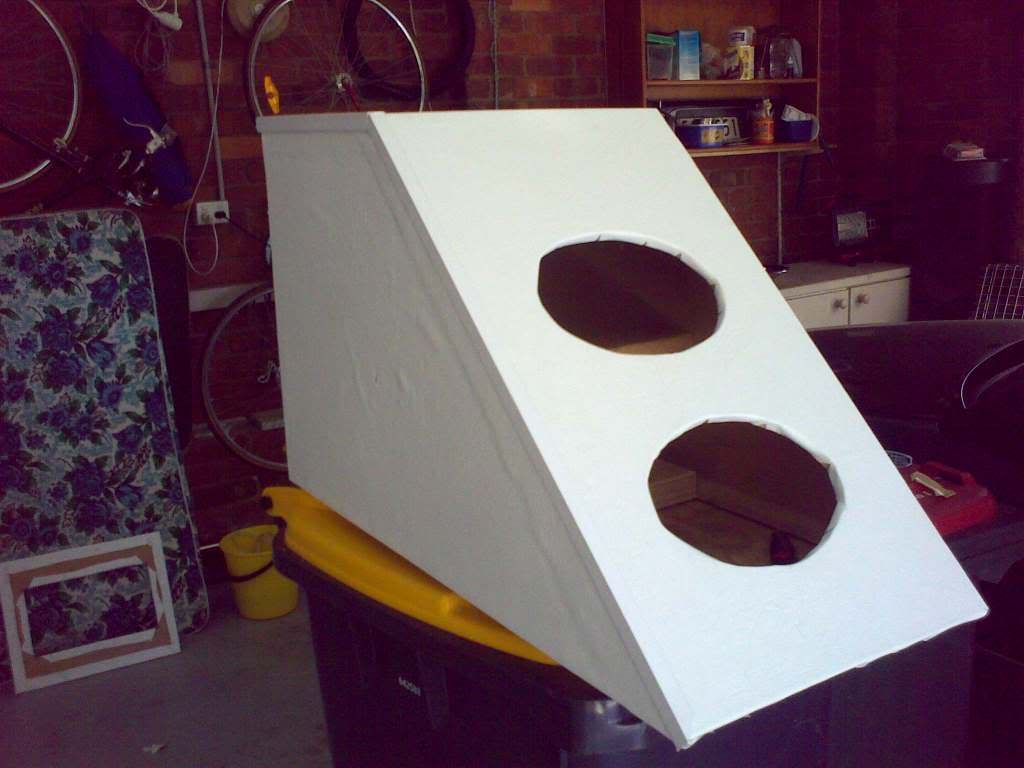

First made the box up
Having a top shelf to place the headunit on
Templates for the speakers
Glue the Vinyl together
Make some wood blocks to support batter...Insert battery, mp3 cables etc..
And Presto, your own beach chick magnet :D ...Hope you guys like it

What's the sound like out in the open?

Postby Hybrid34 » January 29th, 2009, 5:59 pm
Bipolar wrote:What's the sound like out in the open?
Its pretty good, knocks the socks off those portable cdplayers..
