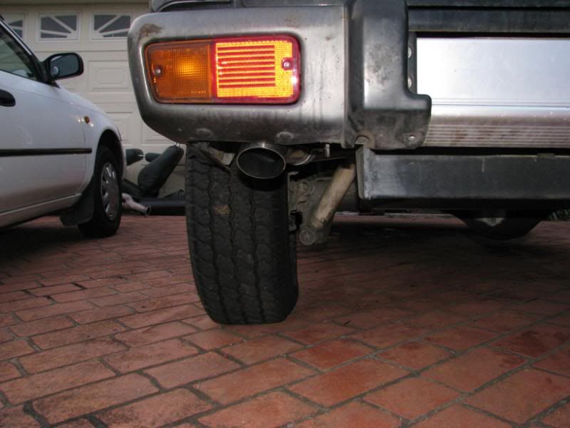

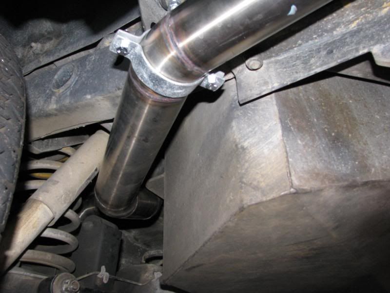

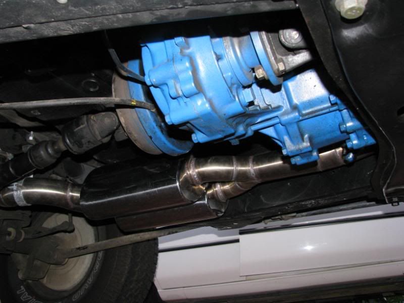

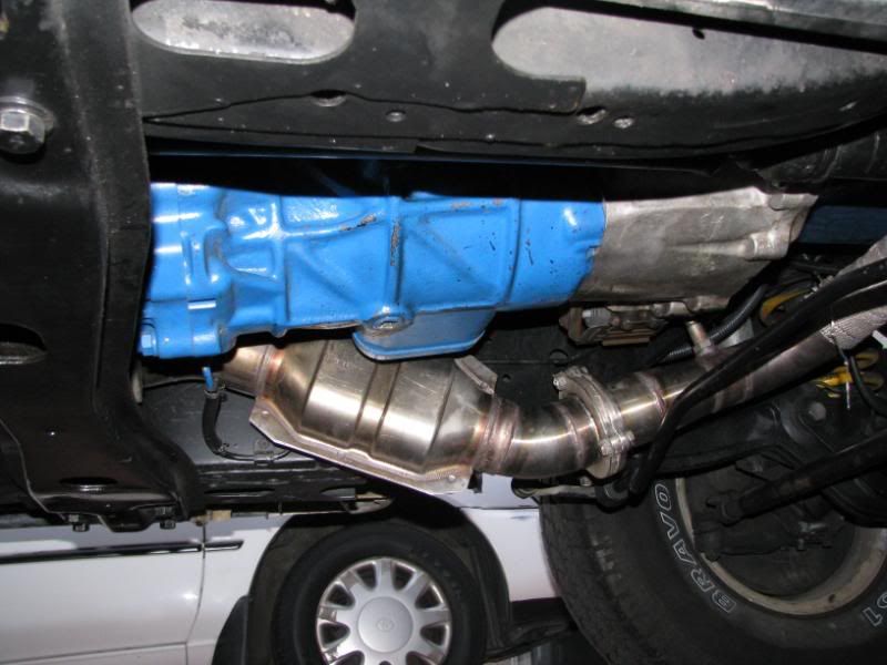

Exhaust is crossed over under the motor. At the moment the dump pipe is "just" scraping the exhaust wrap of the pipe, so i will make a rectangular box to keep the flow, and give another half inch clearance, which is all it needs.
Dump pipe has changed since this pic was taken, but you get the idea......

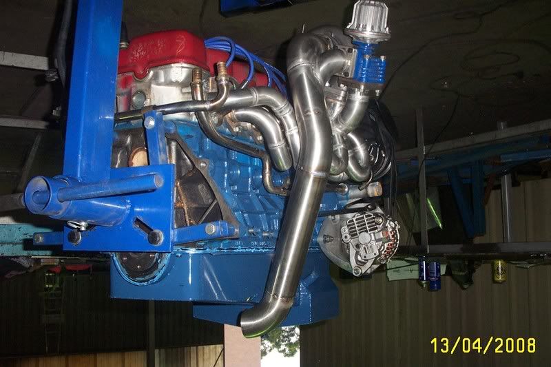

That pretty much sums up the conversion, as you can tell it's not a backyard job, so if you dont have access to some decent machinery,it will be time consuming, to say the least.
I had it tuned 2 weeks ago. How does it go??? like a freight train. I think if this motor was in a Cortina or even a Falcon for that matter, you would have to be very impressed. I got 227.5 rwkw @ 14 pound boost. I have low boost set now at 9 psi, and high is 13ish. Guy that helped tune it said it's fecking scary on the road.
