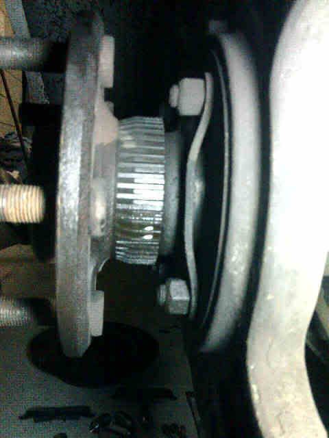

Postby bentls » May 7th, 2010, 6:46 pm
first chance to work on it....
new diff coming soon lol...

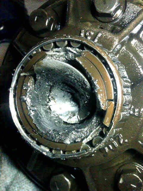

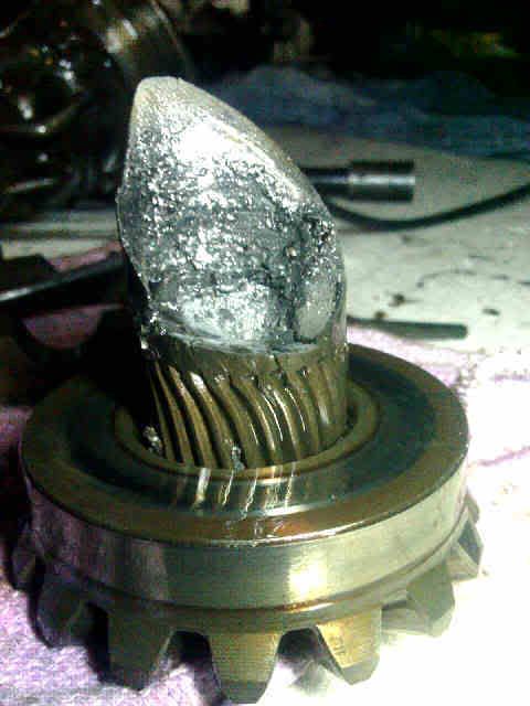

Postby bentls » May 7th, 2010, 7:14 pm
end exploded. its semi welded in, the other end of the axle has worn through the spool end too, and the RH axle has a fair twist through the splines...
so yeah new diff going in, and after the car is rwc and in my name etc i might think about putting in another spool with 31 spline axles etc etc...

Postby josh_ef » May 7th, 2010, 7:21 pm
best option, but expensive option
full spull and 31 spline axles, i got qouted around $1200 for my ed, so be similar for a bomb on door :grin:
i would say the spool is still intact there pretty hard to break but its a pain in the ass pulling centre out to knock the broken piece out.
cheaper option is keep ya 28 spline axles and mini spool, get a white magic marker or soemthing, draw a straight line down ya axle before ya put them in, and every 2/3 months or depensing how much ya drive it, pull them out and see how twisted the line is, if its around a semi circle bin it and change the axle before it breaks.

Postby Rollin » May 8th, 2010, 2:38 pm
josh_ef wrote:
dylby1 wrote:
misk wrote:nah man
axles from the wreckers are cheap as ****
edit - $30 to be exact lol
ah k fair enough.
your right in a sense dylby, 20 axles lates and ya have paid for 31 spline billet items, my mates xd had a modified ed v8 diff fitted (converted to leaf spring) with the intent to get 31 spline set up but for temp solution he had a 28 spline with spool and only went through abut 7 axles in 2 years of regular burnout competing and street cruising, he also got axle swapping down to a 20 minute job so he didnt both with 31 spline set up but it is a pain in the ass if your our crusing and snap an axle
That was also my plan when I broke my first E-series axle. Mine shattered the bearing collar in the center and made me almost change lanes, which was fucking dangerous. It also killed the end of the diff where the bearing sits so the housing and center were fuct.
I put an AU diff in (which = SICK wheel fitment) but it seems AU axles are made out of chocolate. I was swapping them on a monthy basis (after every drift night or trip to willowbank, or even just thrashing it on the street) and it got old REALLY fast.
I doubt many others will have the same problem, but I'd suggest at least checking the axles periodically, maybe after a really big skid sesh or trip to the drags. Better to swap them when they start to twist rather then letting them snap and repairing the carnage.

well said rollin, i thought au axles would be same as eb in non irs?
yeah there easy to change and keep an
eye on them, like rollin said keep checking them and if ya do the line trick you know how bad they are getting.
