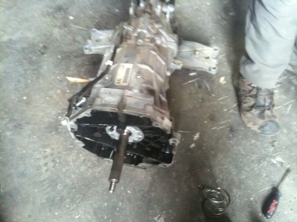

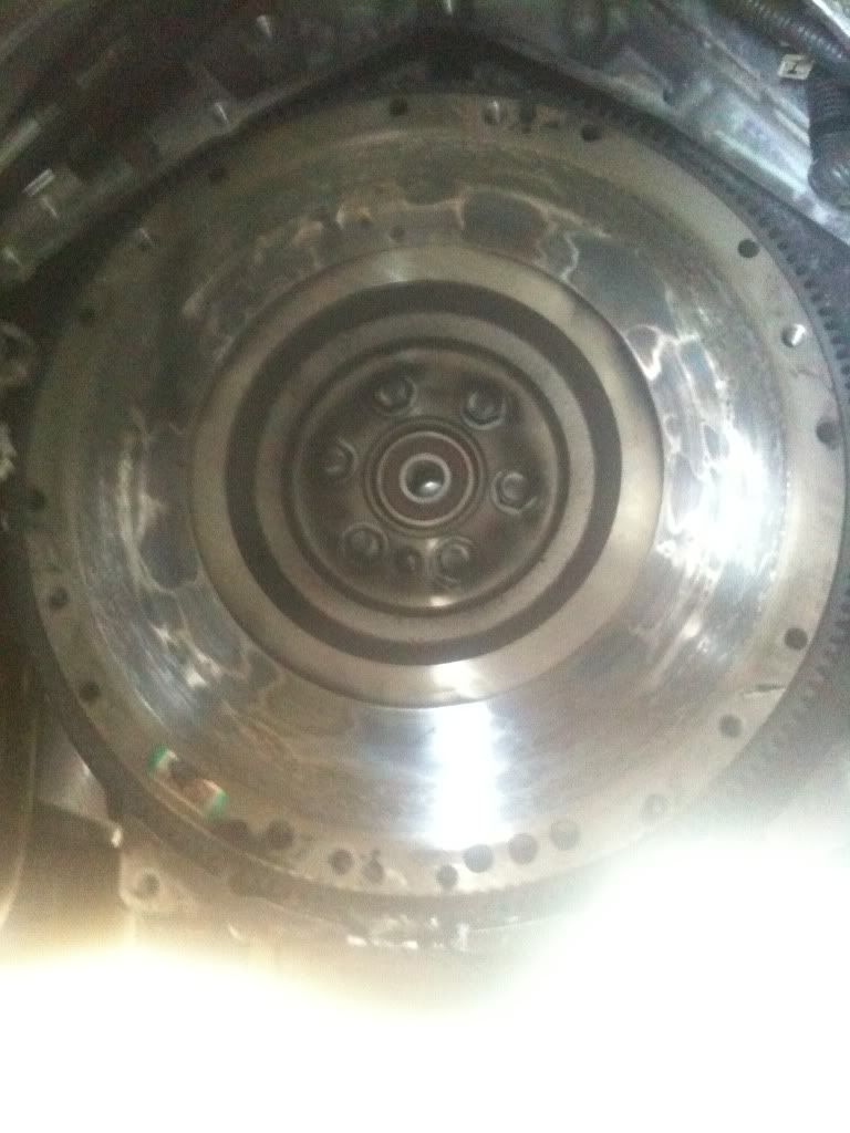

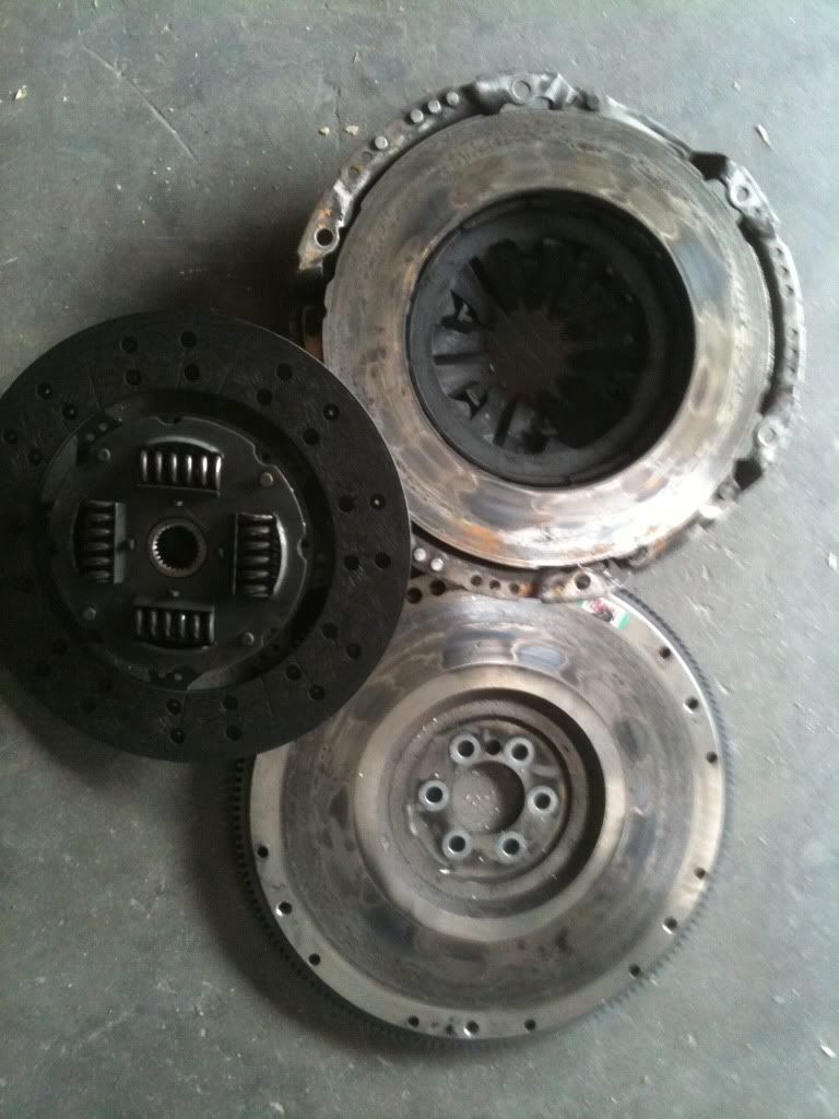

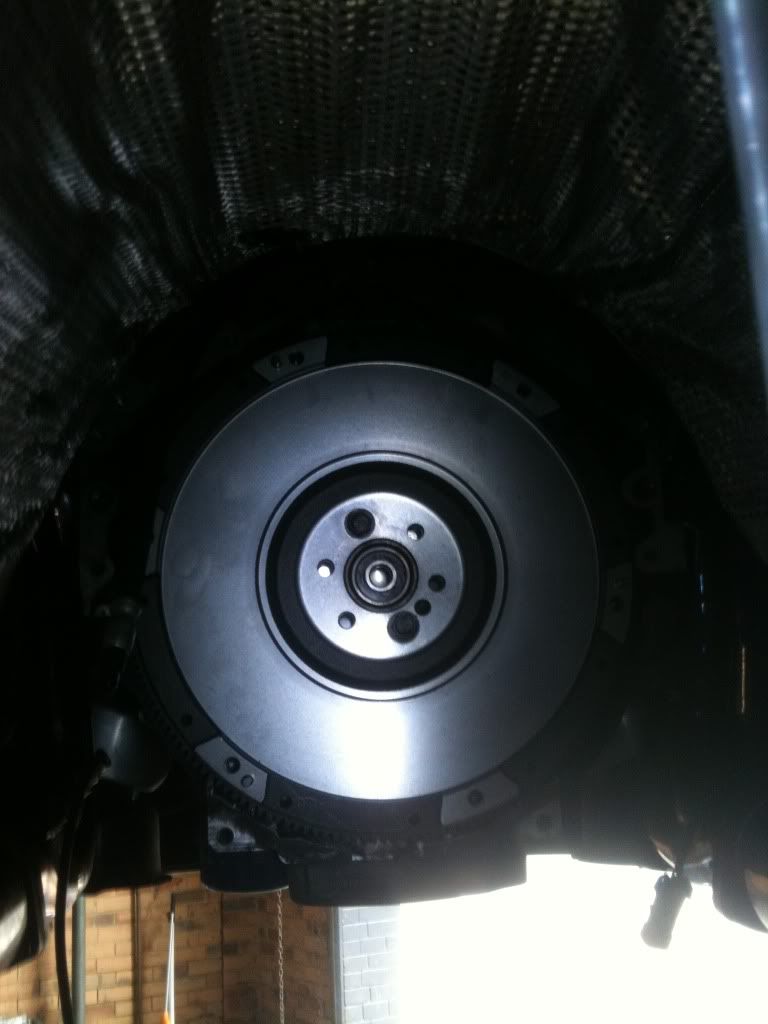

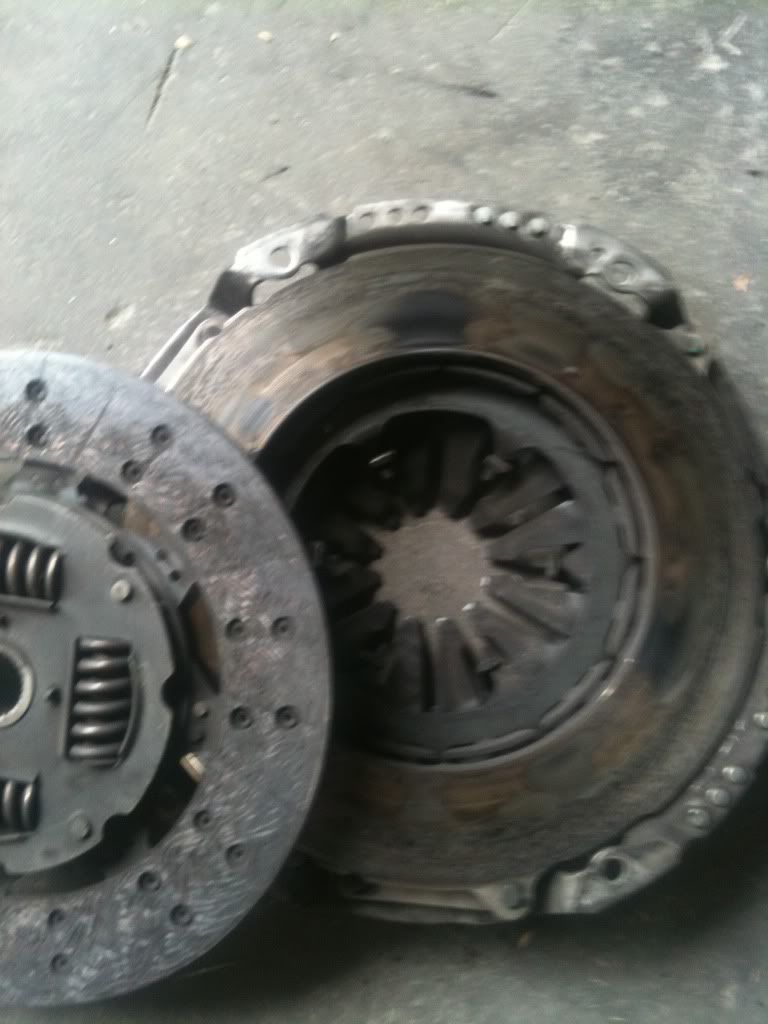

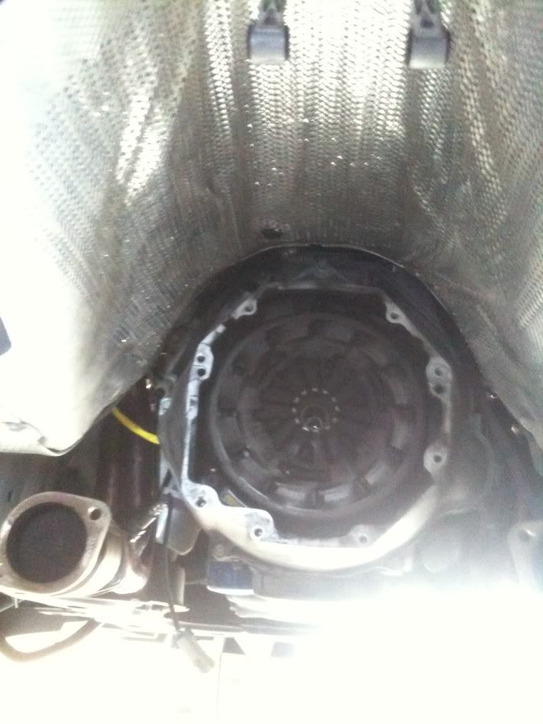

so i was very busy over the holidays working flat out on my tbird. and then i had to swap the clutch over. this was alot easyier than in my ba. got the box out fine.
then as pulling the box out the slave fell aprt into like 6 pieces. it was shagged big time.
the pressure plate and flywheel had a lot of hot spots on it. clutch plates still had a fair bit of meat left on it. so with a machining of flywheel and p.plate i could of reused clutch. but opted to use my new one to be safe.

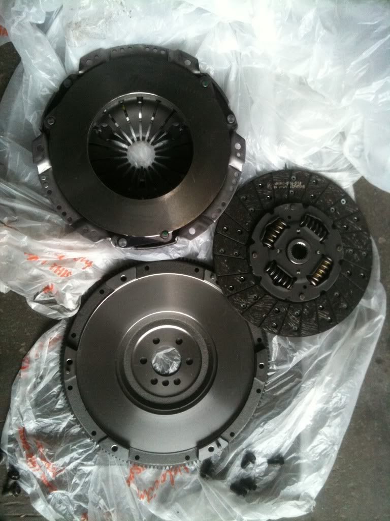

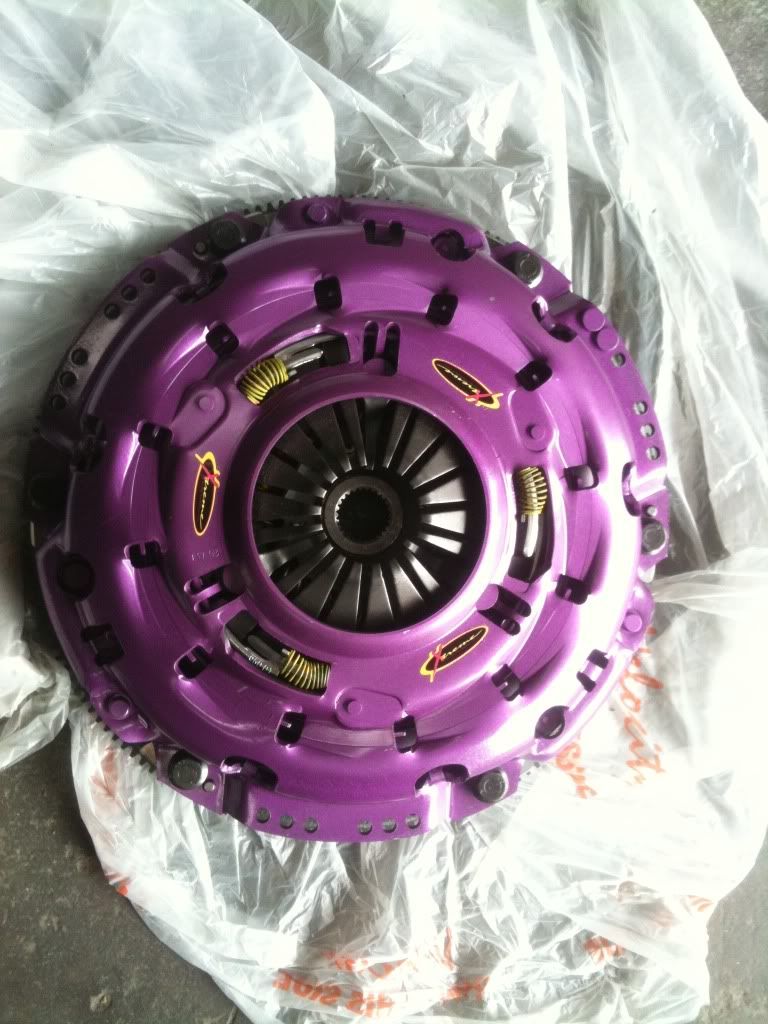

Postby LOW_XR » January 20th, 2011, 9:22 pm
justin- went for an extreme. C+a use them and have no problems with them.

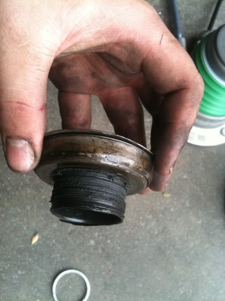

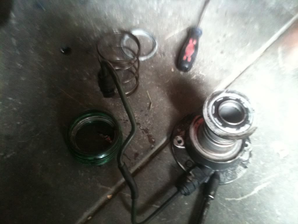

so with massive thanks to scott, brad and tristan we got the box in and all going again. after 2 weeks of driving a shitbox laser, was good to drive this again.
the bleeder on these are wayyy better than on a ba. the bleed nipple on this sticks outside of the bellhousing where my ba sat in a few mm and i didnt know when putting it together you need to put a small socket on the nipple so it doesnt lean against the b.housing. then if its hard against the b.housing you cant get a socket over it to bleed it, if that makes sence lol.
old
new
new and old
and not sure how it happened but it did. this is part of my old slave

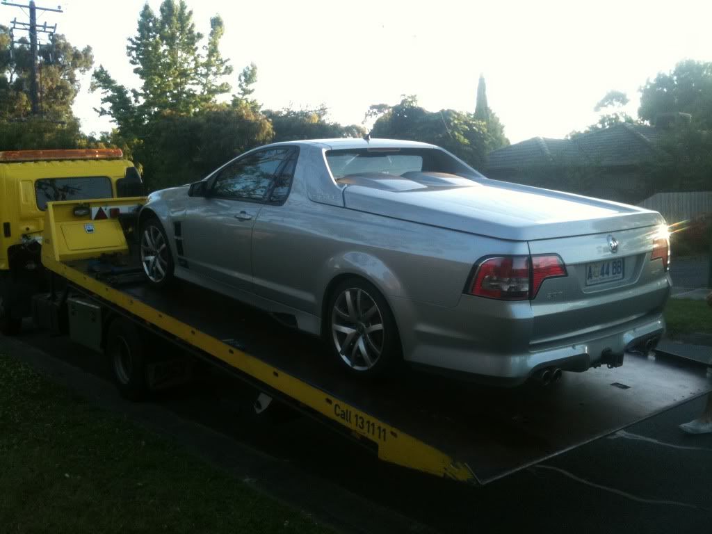

ok so i went on a cruise yesturday with the hsv club. good cruise and some bloody nice cars too.some of the boys loved my ute with the work thats been done to it .did almost 400kms yesturday alone. heres a few pics:
then
YEP!!!!!
on the way home, almost asleep , 30 seconds from home if that- these boys spotted me doing 19kms over.
top cops really,i stuffed up so im happy to cop it. he looked over the car and said how nice it was.(after following me into the car park with the ute idling like a pig lol.)
was all good, got my fine and points and they jumped back in their car to take off.
then he pulled up beside me and was like- "hey dylan? this car isnt registed!"
ive had the rego canclled on me too! so pretty bloody expensive sunday :banghead:

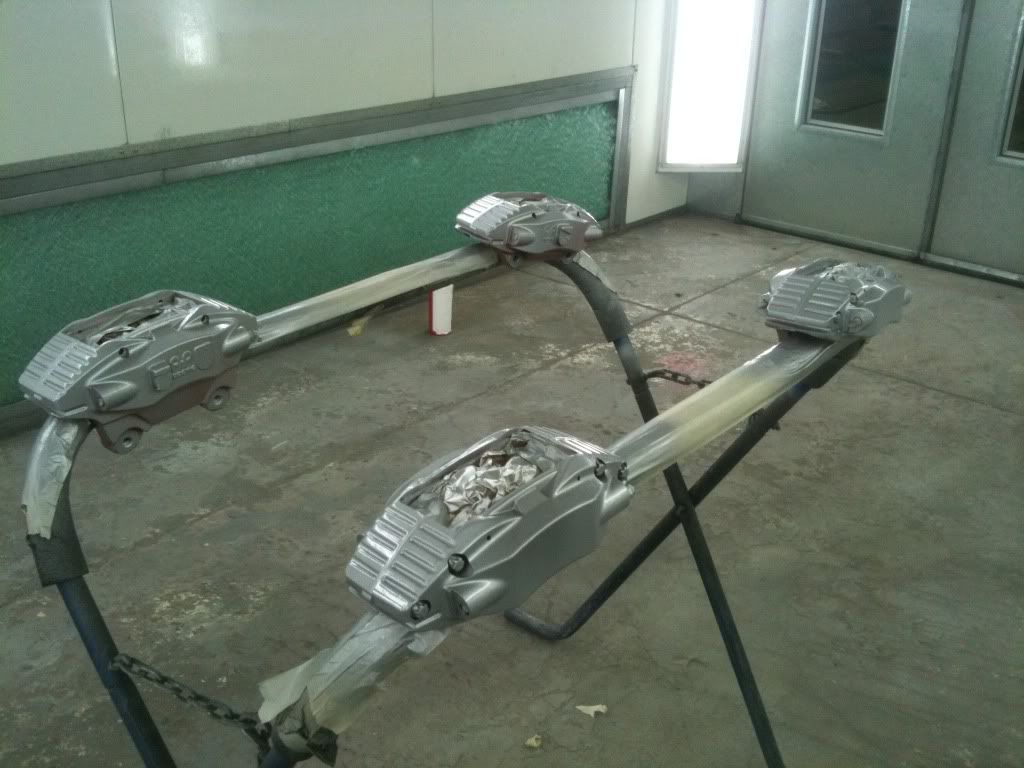

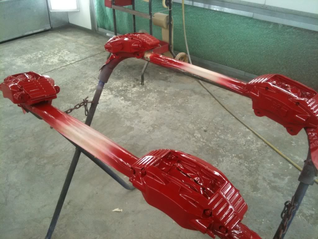

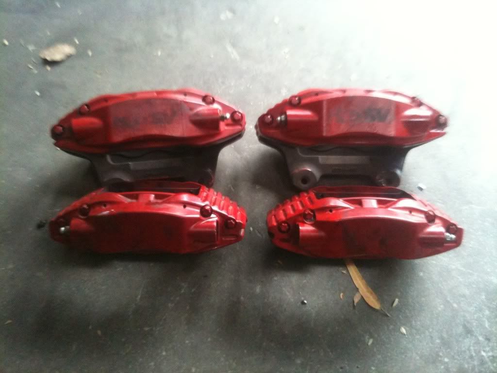

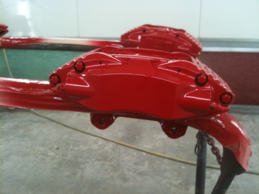

Postby LOW_XR » February 1st, 2011, 8:36 pm

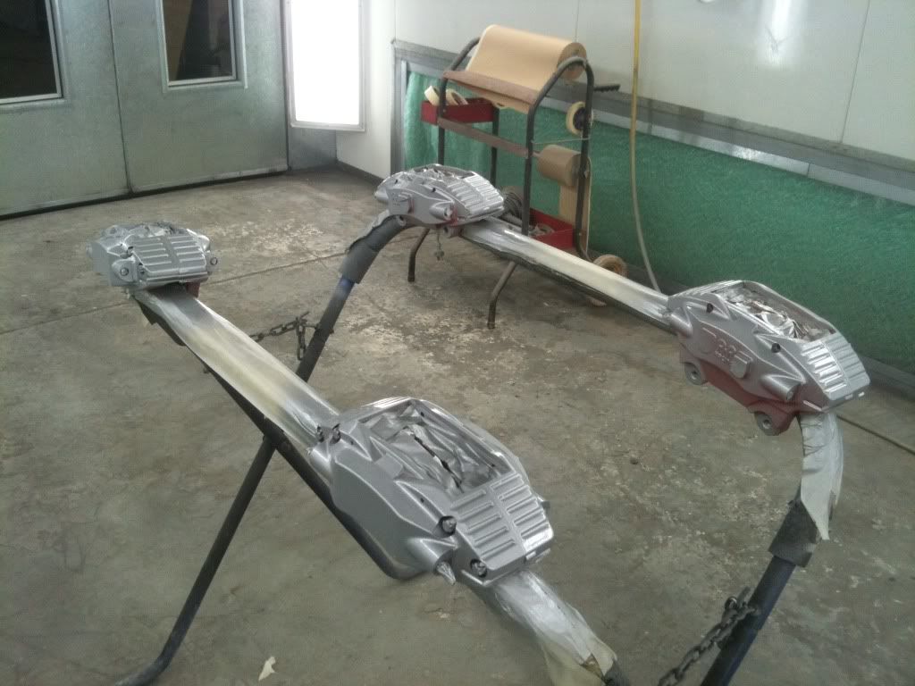

also when the car was on the hoist while i was doing the clutch, i painted my calipers and discs.
i hated how they were that faded red before.
it actually took a bit of work to do these right. i didnt just hit them with a spray can :drinks2:
all stripped down ready to prep
the kit i used. pretty good kit for $63
This is just a rust proof coating you put on before your top coat. and it helps with coverage too.
top coat!

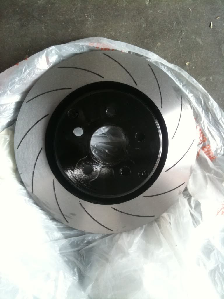

Postby LOW_XR » February 1st, 2011, 8:39 pm

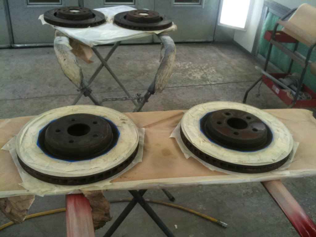

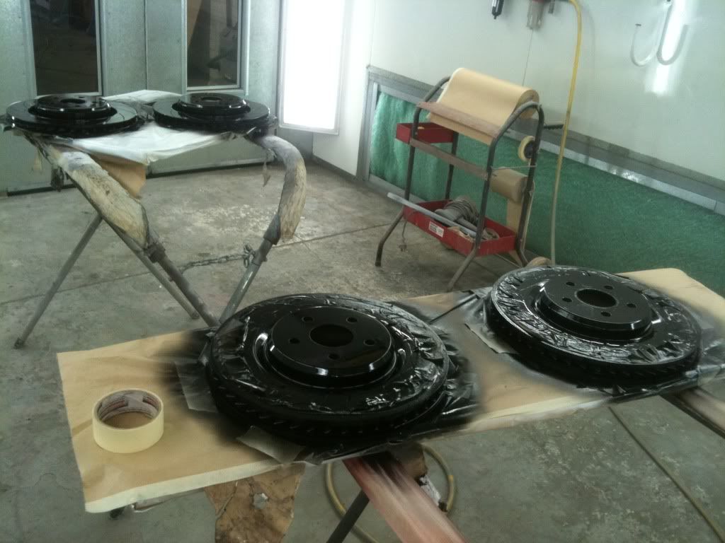

also the disc's
as you can see i painted them black. i was going to paint the hubs silver but as i plan to go gts wheels i think it would better all black.

lol i did that on the rears as i had them machined and it saved me masking them up lol.

yep. id already had the fronts machined so i had to mask them up lol
