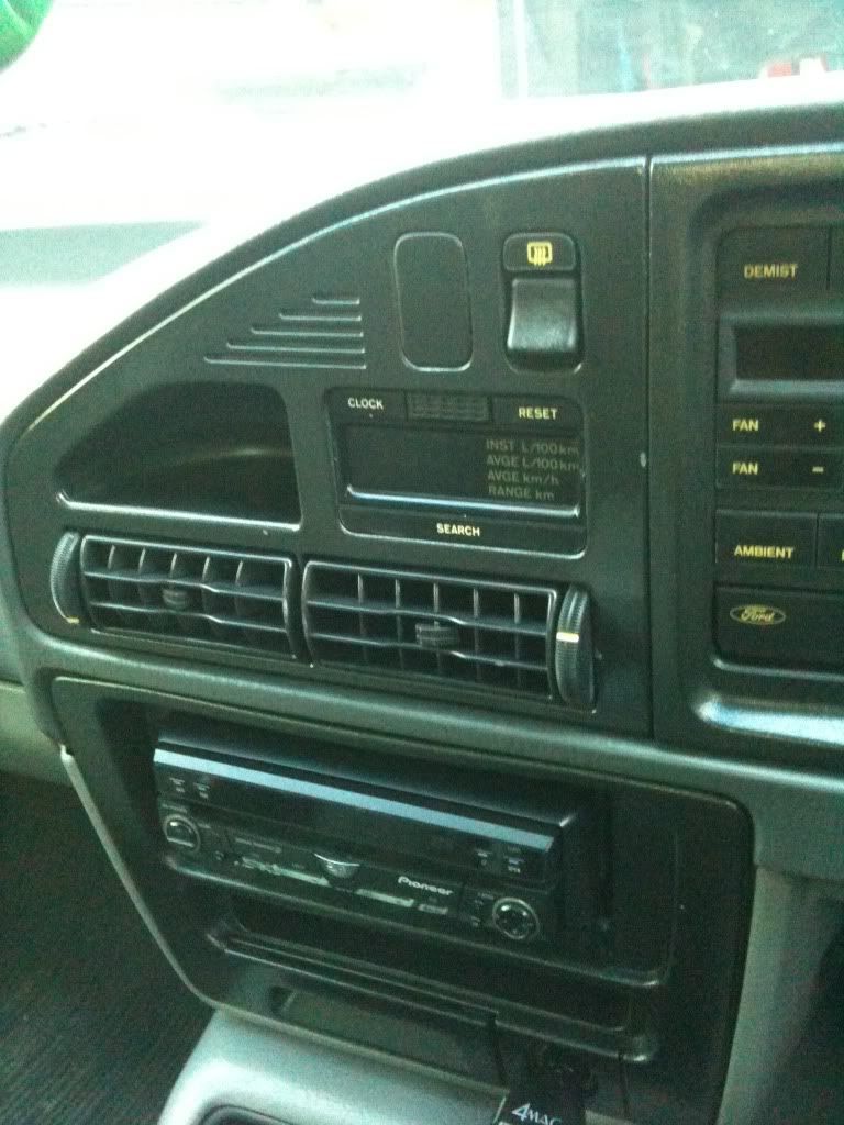

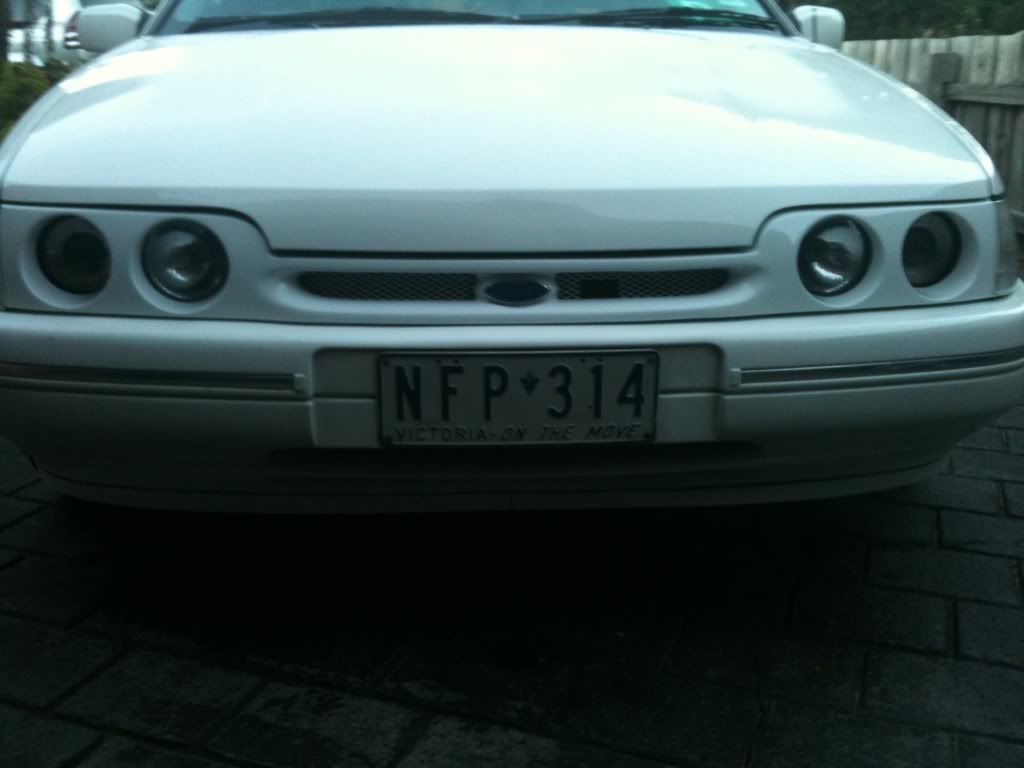

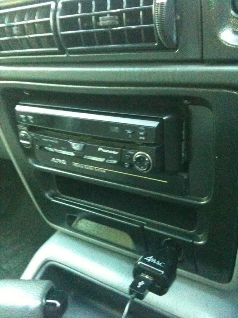

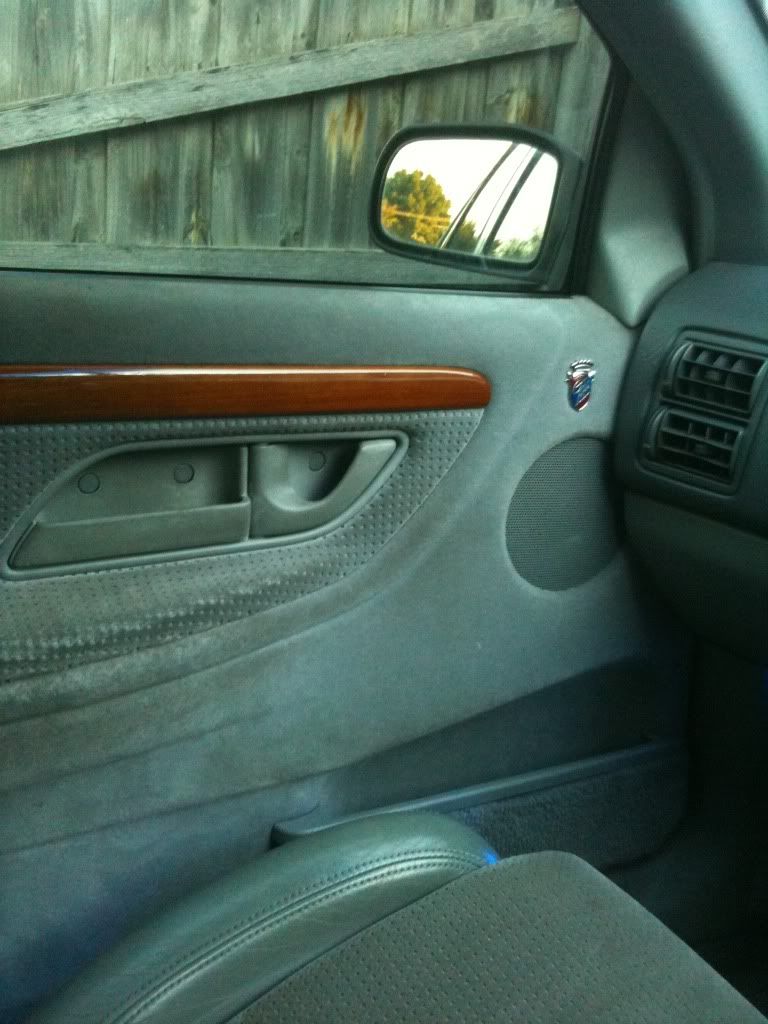

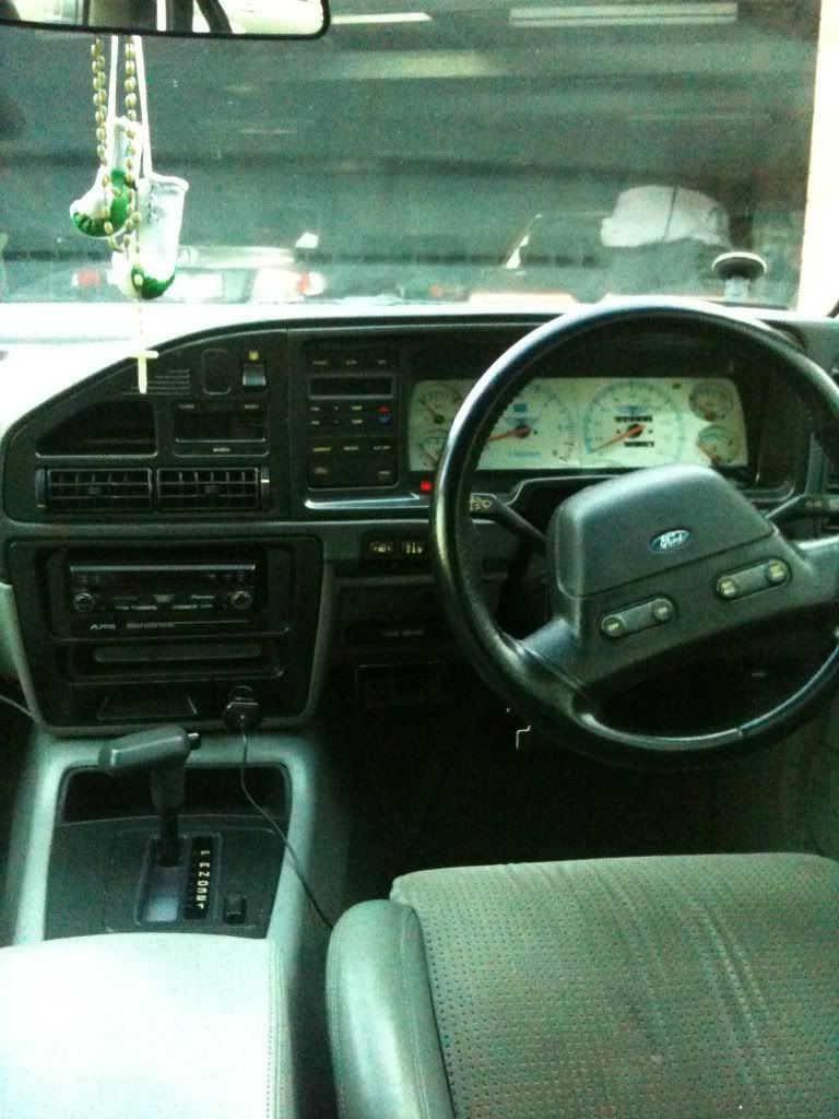

Ok guys after some time I hav just taken pics of interior it's all original leather/velour with woodgrain door trims(no way am I changing interior or selling) as u can see I have customized the speedo and I have changed the interior lighting from yukky orange to blue;). U may not be able to tell but also the front dash panels gve been sprayed with metallic grey and clear coated so it will always have a clean look to it.

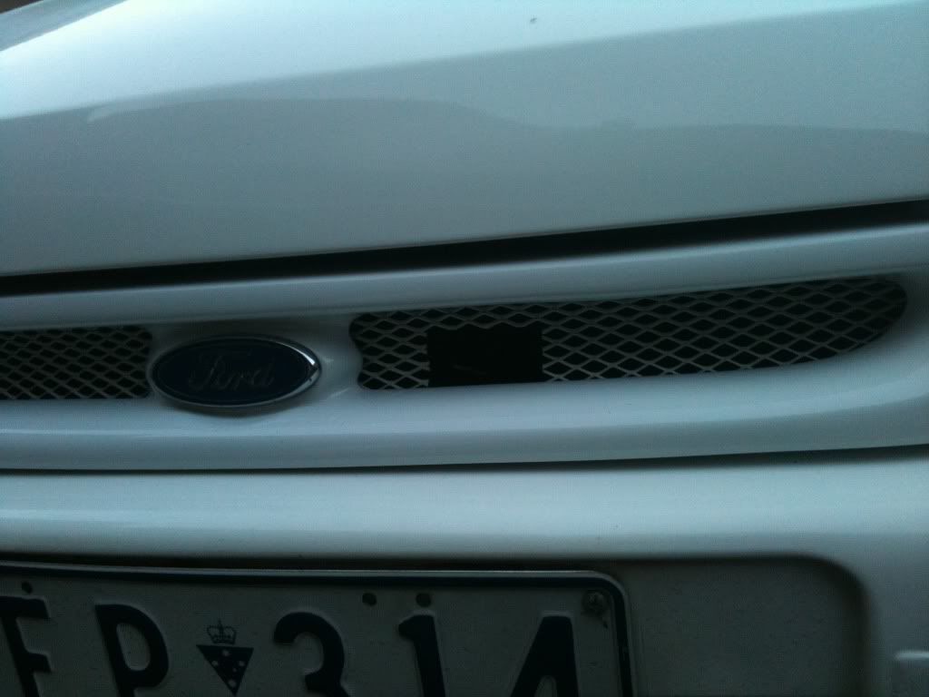

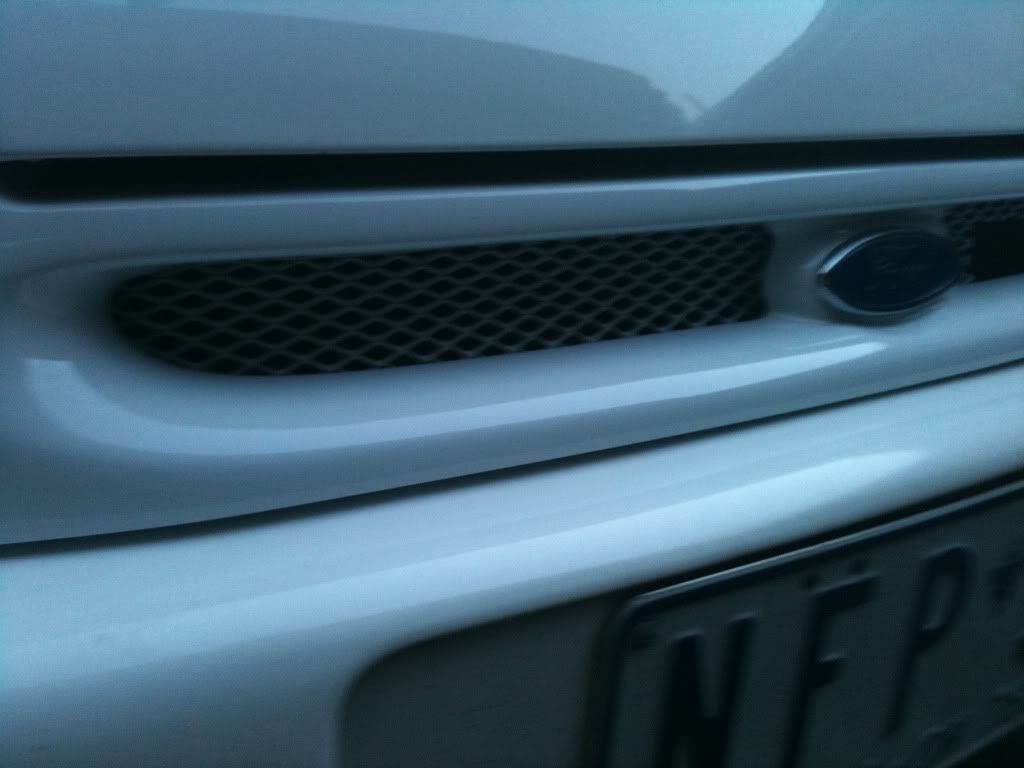

Also guys I was looking at the Xr grille I put on an I thought something was missing. I added some mesh to the grille tell me what u reckon. I had to leave a hole so I could get to the bonnet hinge tell me what use think

Postby dikyby » July 25th, 2010, 6:00 pm
mesh looks pretty good. is there a way to relocate the bonnet catch lever? the hole for the lever just ruins the effect. be good if you could set up a different release for the catch...

Postby mattsEB » July 25th, 2010, 6:10 pm
Buhh??
Doesn't bother me I'm used to it now, until there is research on how to do it I'll leave it mesh took 10 mins to do

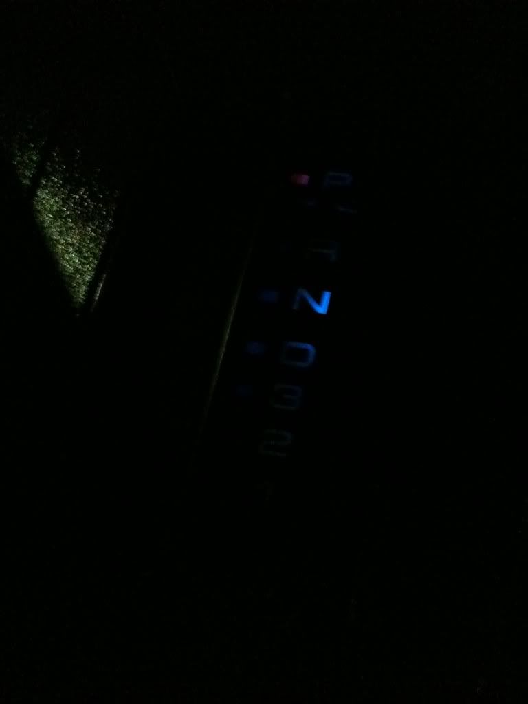

Here are some with the interior lightS

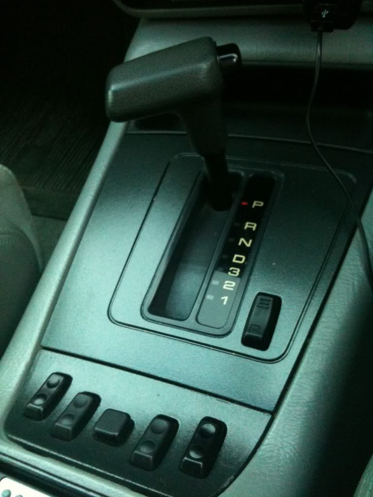

If u can't tell that's the where the gear stick is

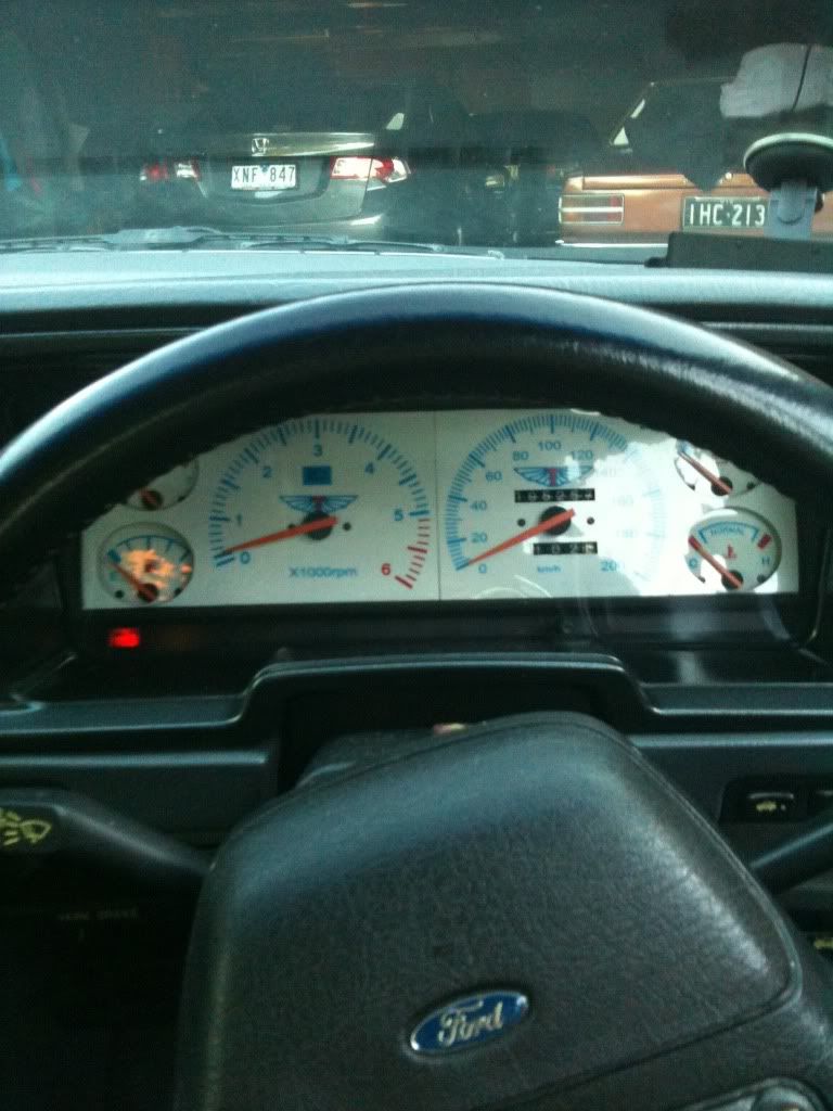

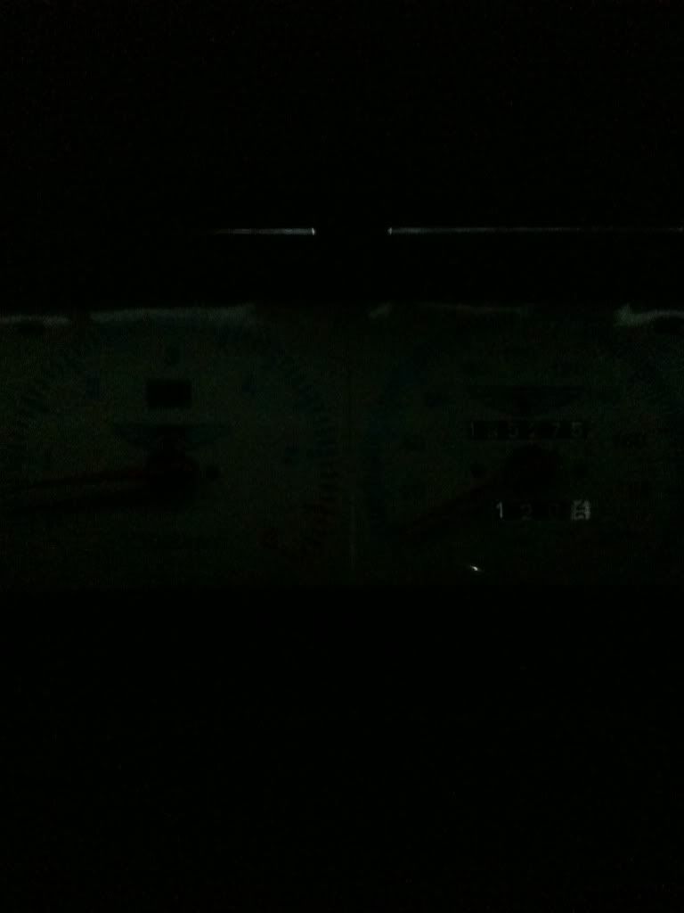

And this is my speedo which is hard to see they are white lights which emitts blue looks awsome but it's a shame u can't see it

Postby SNR » July 26th, 2010, 8:09 am
Should buy the manual conversion I have for sale ;)

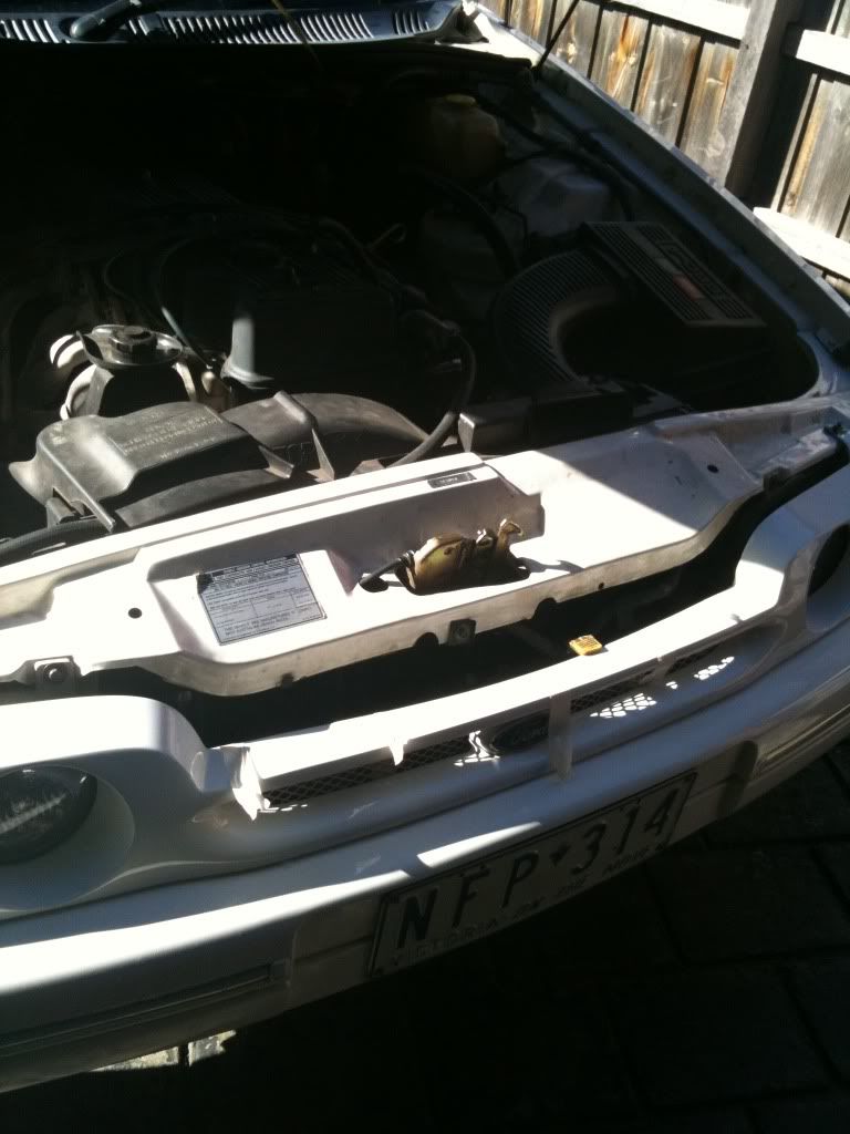

Postby DEVLXR » July 26th, 2010, 7:00 pm
EL series 2 wagon's got a flush fuel door that bolt straight onto box cars without the need to modify it. Rare to find tho but I got lucky.
Also you can modify the bonnet catch lever so it sits on top of the grille with 2 pairs of locking pliers,just put two bends in it,one up and one flat again. Adjust the bends till it opens nice and sits nice. Will take ya 5 minutes to do it and you wont have to have a crappy hole in your mesh!
Car looks good too.

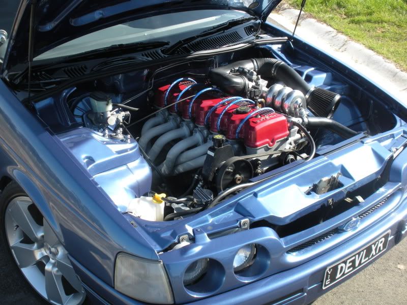

Postby DEVLXR » July 26th, 2010, 8:03 pm
No worries, you can see what I did in this pic...

Postby mattsEB » July 26th, 2010, 9:07 pm
Yea that's good idea. Mate u gve a clean ride man fkn love it:D

Postby LOW_XR » July 26th, 2010, 9:09 pm
lol any excuse to post a pic or your engine bay hey braden :P

Postby mattsEB » July 30th, 2010, 1:44 pm
Done..
Thanks devlxr
