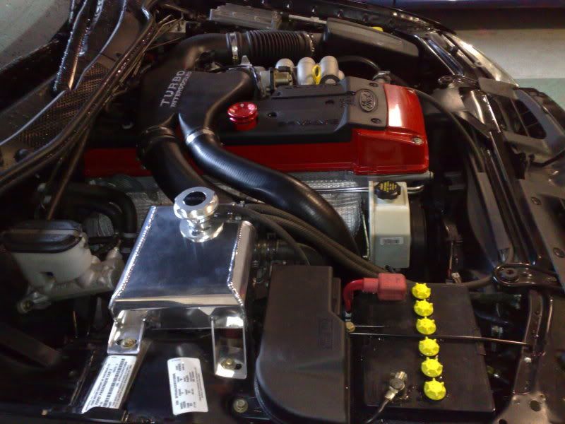

Picked up a alloy coolant tank off ebay.. it was $190 and looks like a copy of the pwr ones. Seems pretty good for the price, way better than the old brown tank that was there!

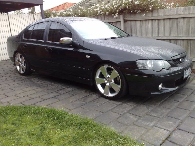

Postby Parfrey » August 18th, 2009, 10:43 pm
thanks! yours is coming along very nicely too ;)
i've been thinking about getting BA GT 18s like dylan used to have... anyone no if they fit over brembo's? guessing they do?

Postby Kenaz » August 19th, 2009, 8:03 pm
Parfrey wrote:thanks! yours is coming along very nicely too ;)
Yeah good choice of wheel! I'm 99.9% sure they fit over Brembos.
Geez I wish I held out and got a black one :(

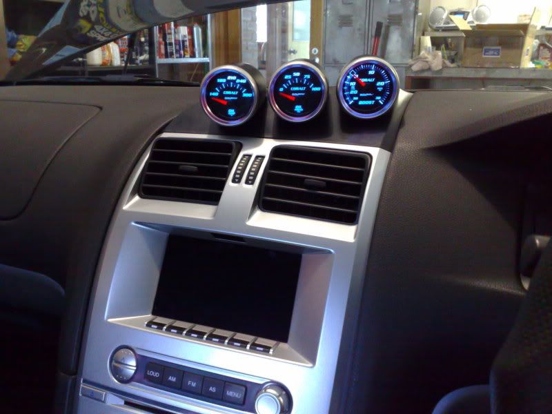

Postby Parfrey » September 3rd, 2009, 2:07 pm

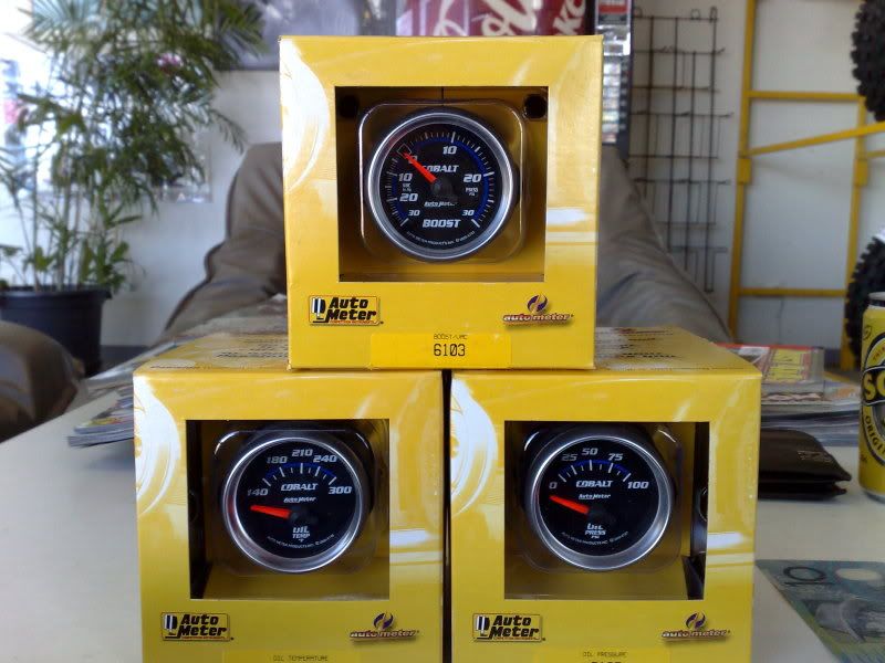

Been busy spending hard earned cash on this thing! Lol. got a 27mm whiteline front swaybar and a 22mm rear. Only fitted the front so far and its heaps good! Handles alot better :)

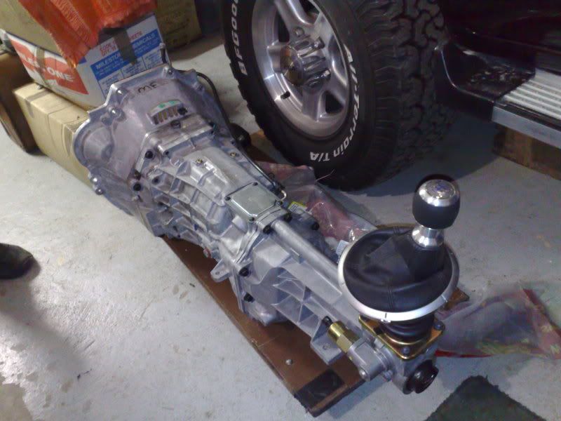

And i got some autometer cobalt gauges just waitin for the gauge holder.. Also the T56 should be going in as soon as i get my mal wood option 3+Clutch :) yay no more auto!

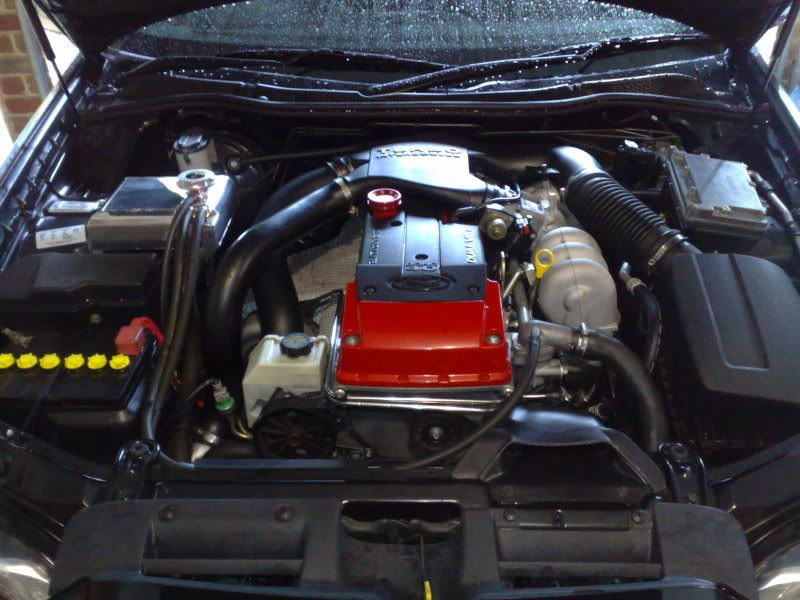

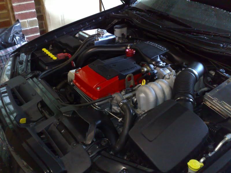

Postby Parfrey » September 5th, 2009, 10:35 am
hmm not sure, once its all out i'll probably sell of the other bits so i'll let you no.
here's a couple of pics...
painted my fpv cooler silver again... stands out!

Postby Parfrey » September 5th, 2009, 4:38 pm
thanks :)
well i would be puting pic's up of my gauges installed and working except i got supplied with the wrong bolt for the middle of the sandwhich plate :banghead: so no oil pres/temp for now. man i hate it when i get given the wrong parts.
also i have 1 cobalt oil pressure and 1 cobalt boost gauge same as in the pics, that i'll be selling if anyone's interested..

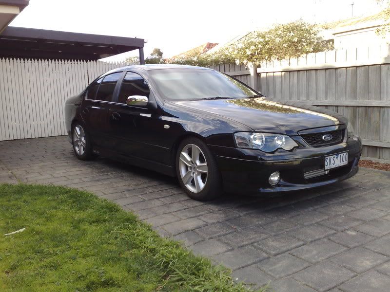

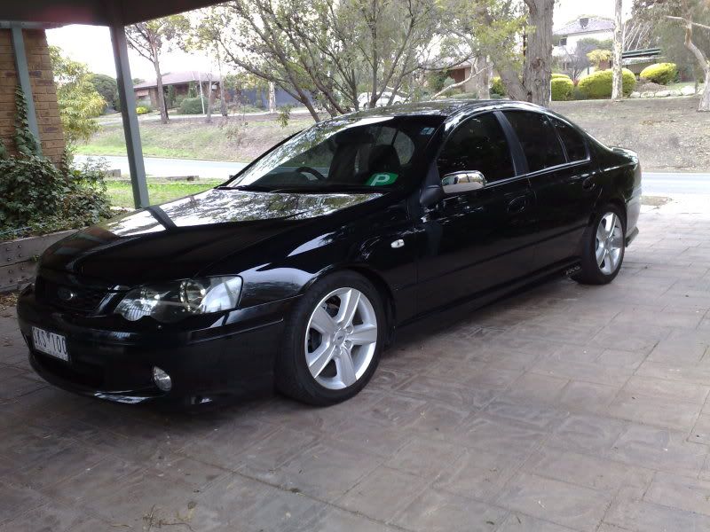

Postby Parfrey » September 14th, 2009, 11:00 pm
T56 is in finally :) After getting fucked around once again... wreckers gave me an xr8 box :thumbsup: lucky schmee came to the rescue! went and grabbed a F6 box off him and i was back in action :)
now i have to get the flash tuner done again because it didn't work the first time. the car is currently speed limited to 45kph as it thinks the auto is missing..
Oh i also got some 19inch GTP's ;)

been driving her around smashing gears and stuff, loving the manual :)
opt 3+ clutch is heaps lighter than i expected too. seems to bite in pretty hard aswell. just need more power now! oh and brakes haha.

What did you need to do to put the 6 speed in? What did you do with the Tailshaft? Asking cause I'm about to be assisting in a T56 - BA conversion
67rce
Posts: 4073
Has Liked: 170 times
Re: My XR6T
Postby Parfrey » September 29th, 2009, 11:11 pm
a few people have done it on fordxr6turbo...
wasn't too hard, i only used a tailshaft half not the whole thing. the slip yoke and length are different.
then there's the box, clutch + flywheel, crossmember, shifter and surround, pedal + master cyl (went in easy i didn't change the peddle box just cut the brake pedal down to regular size.) mmm might be more..
