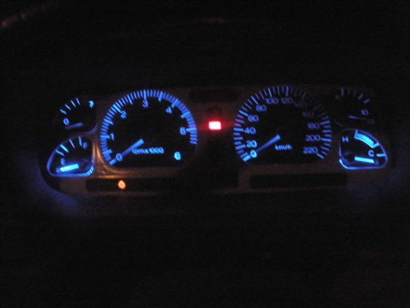

Postby t1MMy » April 14th, 2009, 9:56 pm
Did the LED conversion a while ago now but only just got some pics of it.

Postby skewy_33 » April 14th, 2009, 11:30 pm
hey man how long did it take you to do the led conversion

Re: t1MMy's car over time.
Postby krisisdog » April 15th, 2009, 12:05 am
I think one of your LEDs aint workin there Timmy.
Pretty bright blue too, mines a deeper blue than that by a fair amount, either way beats the ol orange!
Postby t1MMy » April 15th, 2009, 8:34 am
skewy_33 wrote:hey man how long did it take you to do the led conversion
About 1 hour.
krisisdog wrote:I think one of your LEDs aint workin there Timmy.
Yeah, the LED globe on the top right doesn't bother me too much coz it's just the battery gague, still works but it's a little dull.
Postby skewy_33 » April 15th, 2009, 10:30 am
did it take long to pull apart the dash to get to the leds?
Postby t1MMy » April 15th, 2009, 10:34 am
Don't have to pull that cluster apart at all. Just remove the standard globes at the back of it and replace them. Hardest part was removing the wiring loom from the bottom rhs of the cluster without snapping the wires.
Postby krisisdog » April 15th, 2009, 11:56 am
I think it takes me all of about 15 minutes to pull the dash down, cluster out, swap lights and put it all back together now lol!
Postby t1MMy » April 15th, 2009, 12:37 pm
LOL i've done it a few times too, and have mastered the art of pulling the dash out. It does only take about 20 minutes to do once you know where all the screws are and how everything fits into place.

Postby krisisdog » April 15th, 2009, 12:54 pm
skewy_33 wrote:krisisdog, thats pretty quick if ya do mine ill give ya money for it lol
Lol practice buddy, practice. I've had mine apart over a dozen times, and a couple of other cars apart a dozen times between em.
Theres only like 8 screws or so plus the 4 on the cluster, and then a few plugs to clocks/trip/demist and to the cluster, not a lot of there when you think about it..
Postby FOR.0EL » April 15th, 2009, 1:30 pm
freaking your dash looks awesome, i bought a set of the blue LED's only to realise you cant just bull the EL bulb holders out and replace the globes in them, there all soldered in and shit :S:S:S::S:S i no there is a tutorial but far out i just wanna swap all the bulbs over
Postby t1MMy » April 15th, 2009, 1:34 pm
Get an EF cluster then.
Postby FOR.0EL » April 15th, 2009, 1:37 pm
do you no if the ef bulb holders are compatible with the el cluster?
Postby t1MMy » April 15th, 2009, 1:42 pm
FOR.0EL wrote:do you no if the ef bulb holders are compatible with the el cluster?
NFI mate, all I know is that the size of the globes are T5.

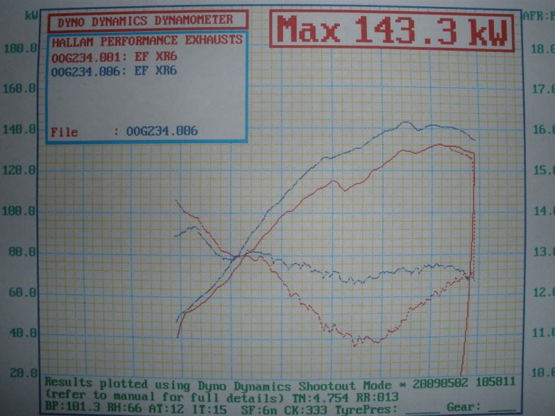

Postby t1MMy » May 2nd, 2009, 10:27 am
You're right, I was at CVE this morning and we chucked it up on the dyno.

Postby EFFalcon » May 2nd, 2009, 10:56 am
nice gains from the tune.
the J3 chips are showing their worth!

Postby LOW_XR » May 2nd, 2009, 10:57 am
good work mate. what mods is that with?
im sure it says it somewhere but cant remember lol.
very nice.

Postby t1MMy » May 2nd, 2009, 10:58 am
I only have full exhaust system and T5. No cam, no air intake, nothing. Pretty much a stock AU XR motor.

Postby travs ea-xr6 » May 2nd, 2009, 11:00 am
how much power did it make before the j3 chip

Postby t1MMy » May 2nd, 2009, 11:06 am
Shows it on the red line, it's was making about 132kw's

Postby LOW_XR » May 2nd, 2009, 11:09 am
feel heaps better to drive?
next up is cam? i got stats of my old cam . was awesome lol
Postby t1MMy » May 2nd, 2009, 11:18 am
Yeah it's a more smooth power delivery for sure. S/C will probably be next.

Postby ClassicAU » May 2nd, 2009, 5:30 pm
C'mon mate, that seems a bit down on power for a boosted 6! :drinks2:

Postby galapogos01 » May 2nd, 2009, 7:00 pm
Great result in the midrange there. Very surprised it ran so rich in the midrange with a stock cam!
PM me your details so I can add you to the Owners Gallery - http://www.tiperformance.com.au/owners_gallery.php !! Can send you a sticker too if you like.

Postby t1MMy » May 2nd, 2009, 7:28 pm
galapogos01 wrote:Great result in the midrange there. Very surprised it ran so rich in the midrange with a stock cam!
Yeah mate tell me about it. One of the reasons I had it tuned and chipped was because of how rich it was running. After putting the foot down hard and pulling up you could smell unburnt fuel and it was strong!!!
