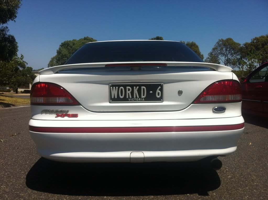

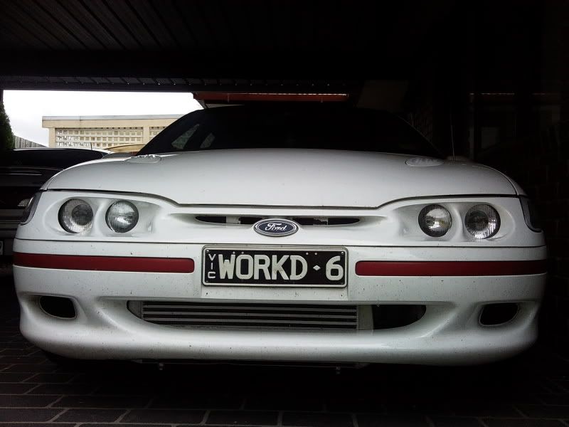

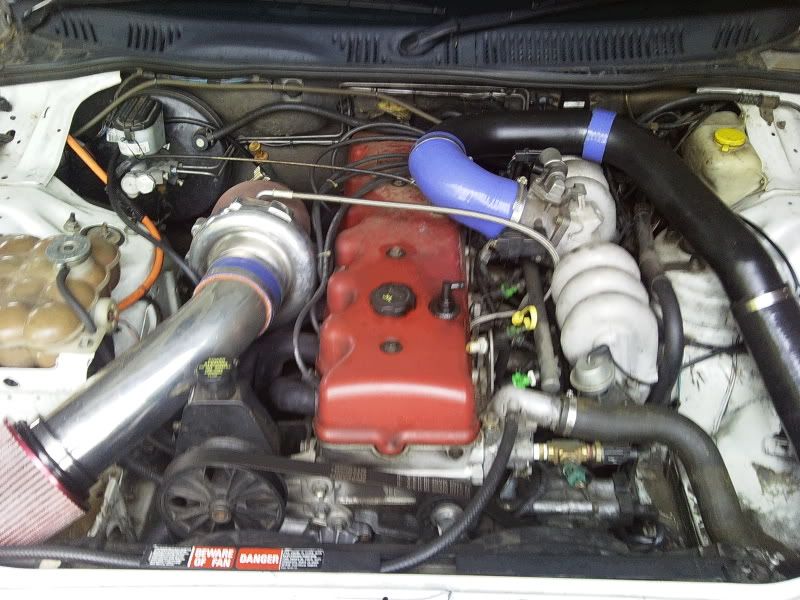

Postby obriza » November 14th, 2011, 11:35 am : Rmyers Likes this post
ok quick update... After the last 2 years progress has been very slow as have had alot of other things to pay for. But finally have got the new setup on and the front bar has been replaced with an EL XR bar. Heres a couple of pictures of how it looks now. Cooler is off center and quite low as I wanted to keep the air conditioning as this still is my only car. Sorry its a bit dirty.
From front
Also a GT42 has now been installed after being N/A for so long, feels great to have boost again. Currently is just running off the waste gate at 5psi as haven't had the boost controller installed yet, will be on soon enough. It currently has 182rwkw at 5psi and feels very responsive and power comes on pretty early, around 2000rpm. Aiming to be boosting it up as soon as the controller is in. Heres a photo of the engine bay.

Postby obriza » November 25th, 2011, 12:27 pm
quick update, this week I've had a little work done, finished off the 3 inch exhaust as before it was 3 inch till diff and back to 2.5" for some back pressure as there was quite little boost going through.
So now it has 3" all the way through, also finally had turbo timer and boost controller fitted and after playing with a couple of settings, now once it comes on boost i have a pipe coming off every time. Getting fixed tonight as it just looks like the pipe was missing the weld spots to hold the silicone piping on better. Still have to get it tuned for higher boost though, so its still running 5psi for now, hopefully to be tuned next week.

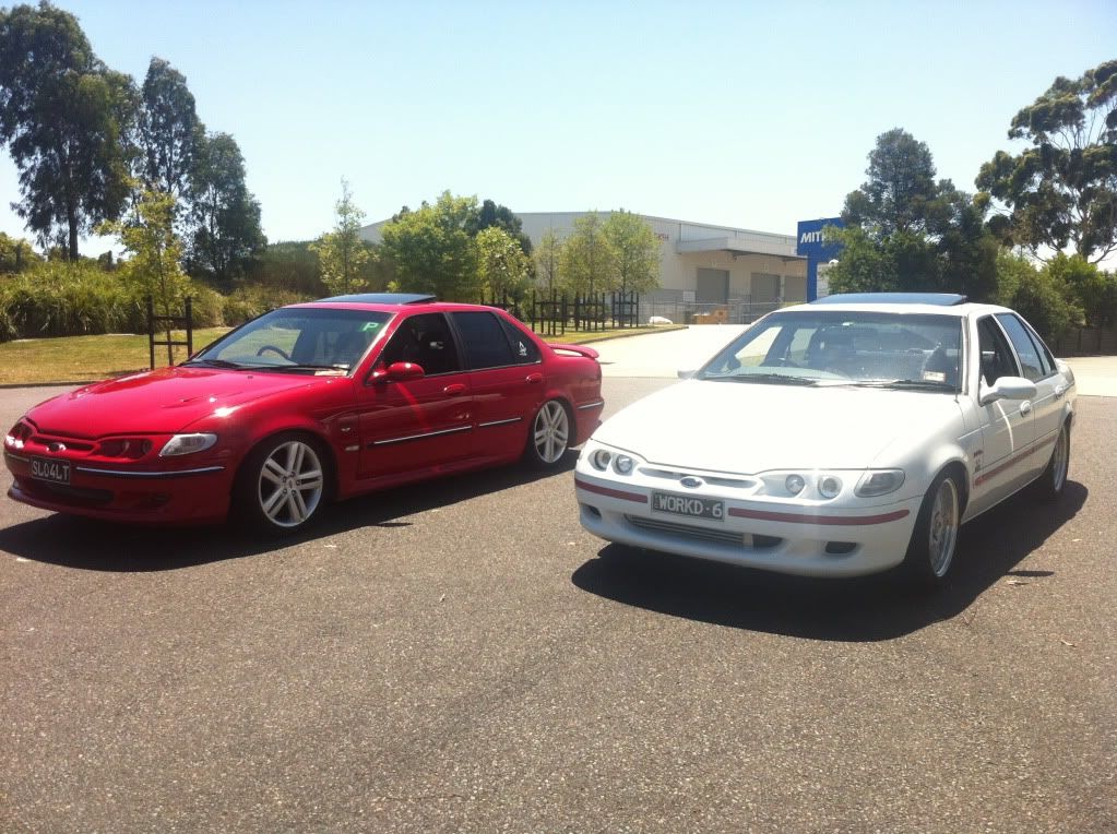

Postby SLO4LT » January 24th, 2012, 6:41 pm
Some pics taken on the weekend :cool:
Project[SLO4LT]
Daily - BA XR6T Uterus
SLO4LT
Posts: 771
Has Liked: 113 times
Been Liked: 80 times
Re: WORKD-6 Now with GT42
Postby XR_Lightning » January 24th, 2012, 8:39 pm
both mint examples of e-series! :good: :thumbsup:
