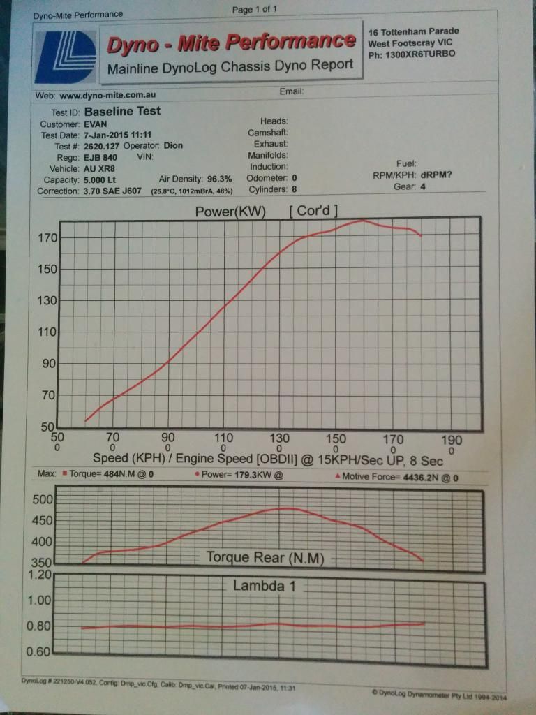

Postby ClassicAU » January 7th, 2015, 11:24 am : FTW-302 Likes this post
Ha! Don't think anyone is buying it mate! :lol:
Anyway, done at Dion's already. Pretty happy with the results. The gain was not as much as I though, but it's a healthier engine than I gave it credit for. Base was 168rwkW and end was peak of 179rwkW. However the biggest gain was the torque, as it picked up 40nm in the mid range with a peak of 484nm after the tune. Probably not much, but enough to clean up the tune and hopefully the motor will last a bit longer. I'll have to wait till later to check the bum-o-meter as it's already like 33 degrees outside!
