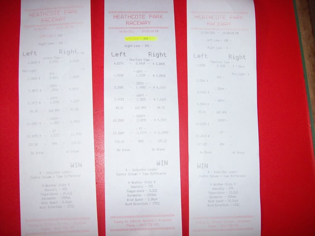

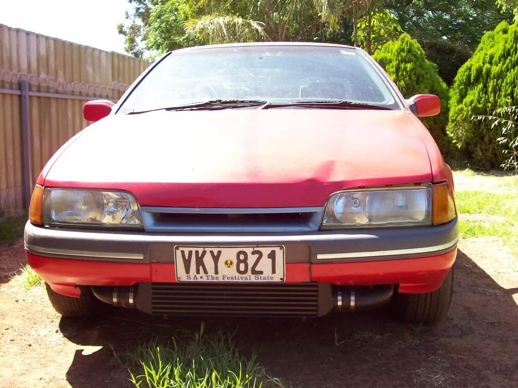

Thought its about time i threw up a thread on my eb fairmont. Some of you may already no but we are the manufacturer of the turbo kits avaliable on a certain internet auction site. The car is nothing special to look at but it goes better than its appearance. Its suprised a few people, essentaially it looks the same as when i bought it for a grand sum of $200 haha. So far were just over 5grand all up inc the car and have just broken into the 11s with the mach 2 turbo kit at heathcote for the AFF drag nationals. Its the first time weve raced the car as SA has no drag strip :banghead: The car is registered and gets driven a heaps with a lot of r&d and testing purposes so it has a hard life but loves it.

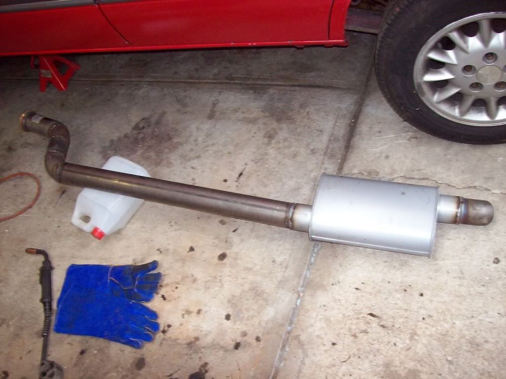

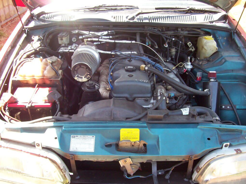

It still uses many stock parts with only the essentials changed. The motor is a stock 236000kms eb bottom end with a 1.5mm decomp plate between 2x au headgaskets, stock ef head, crow double springs, wade 1521a cam, stock eb intake manifold with 60lb injectors, 044 copy fuel pump, el ecu with j3, 3" exhaust, stock btr auto with s3and4 removed, stock stall convertor with trans cooler, stock ignition, stock suspension and brakes, stock 3.23 diff gears with mini-spool, WI, full interior street trim inc tow bar. Best et was 11.9 best mph 117 and best 60ft 1.84. Best 0-100 on the street has been 4.6

Unfortunatelly its just self tuned and im no expert on that, timing was left at 16degrees on boost so nfi how much more it would take its to loud to hear any pinging. I suspect it needs way more down low to bring more boost on the stall, comp is prob 8:1 maybe a tad lower even. No idea on power at the moment should book in soon to recheck afrs etc. Last dyno was strapped down and pulled 240rwkw on 11-12psi with 2.5" flanged exhaust, no cam or springs etc. Haha this turbos still the original its been a slut this is the 3rd car its been on and its been happy on 14psi for a while now. Had up to 17psi but it was too lean as the pumps maxed out. Car is still on bp 98 too we get 100 octane e10 here might try that stuff soon. Wish i had some det cans it would make life a lot easier.

Its a steel 1.5mm plate, were also throwing in about 400cc of water per min on boost so i suspect it will take more timing but not sure on the stock bottom end, one ping and bang boom :lol: Turbo is nothing special just a plain bearing t3 flanged t70 on a log style manifold. Think im going to book some dyno time with a shop using det muffs and see what happens adding a bit at a time. Might by 20l of c16 and dial that in so i no for the future if i want to run it again, bloody expensive fuel though. We went through nearly a full tank of 98 in 21 passes over the weekend but thats with a lot of idling around waiting. I wish i had bought a stally, i was only leaving the line on less than 5psi most passes and about 6psi on the 11.9 pass at 2000rpm.

Funnily enough the exhaust is a bit loud and drones haha
