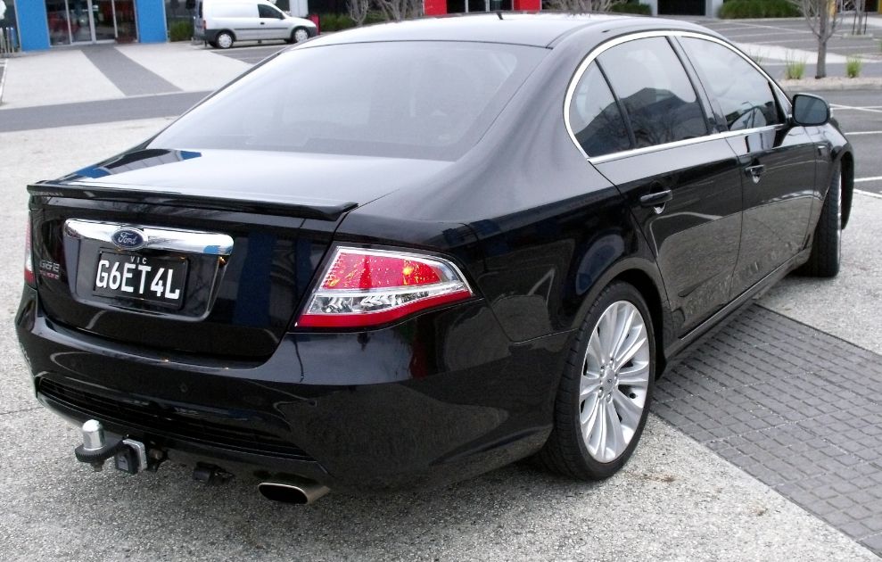

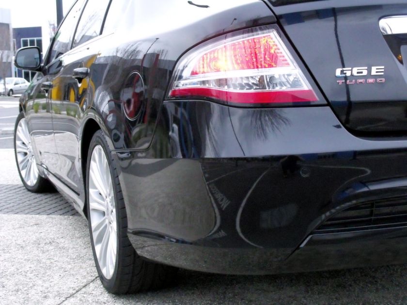

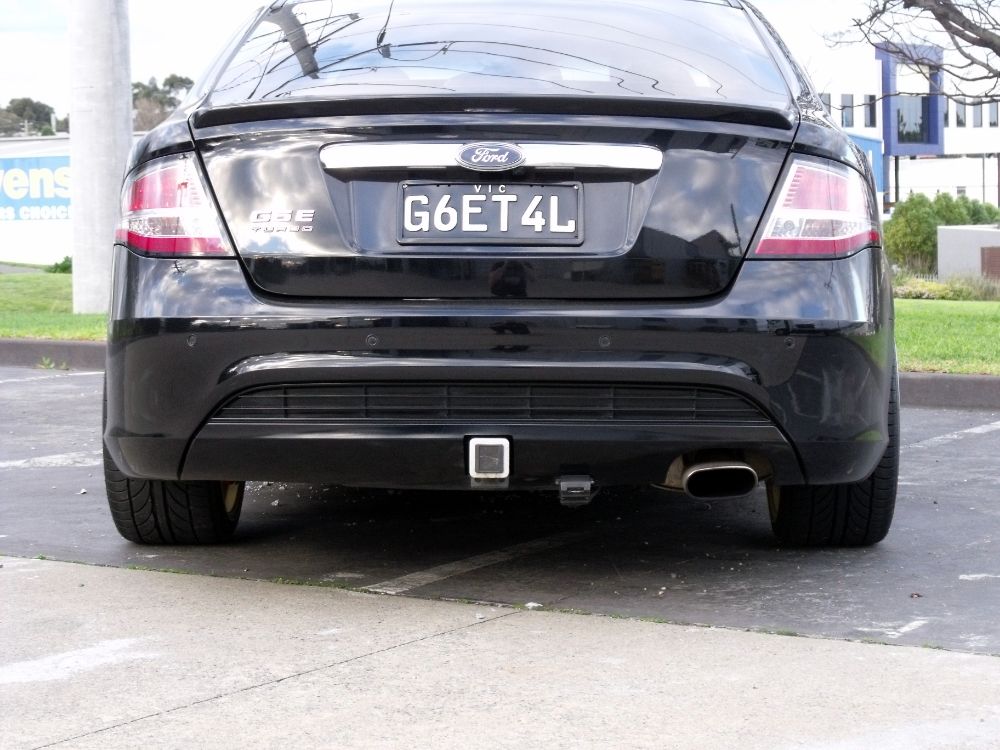

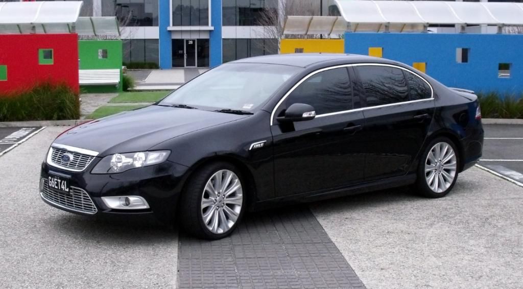

i picked this up last saturday, a 2010 G6ET :yahoo:
there's no sunroof & it's not a V8...... but it ticked all the other boxes for me.
silhouette paint, charcoal grey leather & black interior, sat-nav & the tow bar always comes in handy from time to time.
pic's after i bought it.......

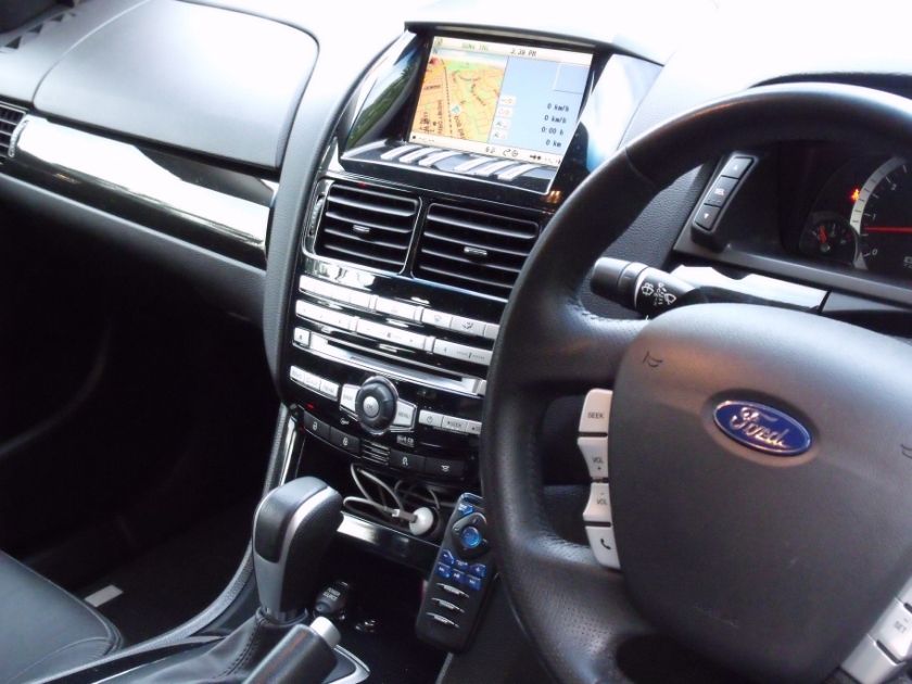

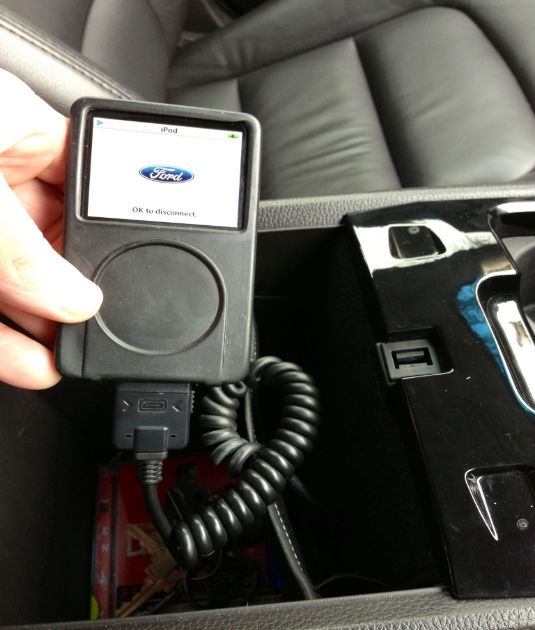

my old i-pod has a new home now....

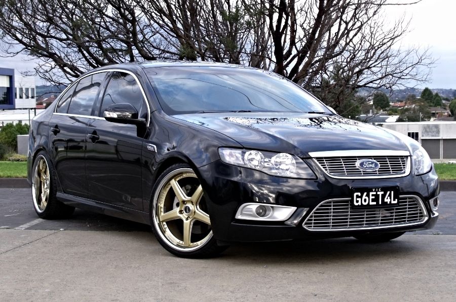

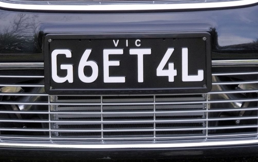

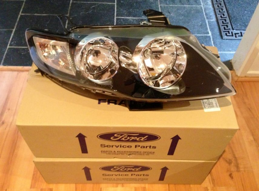

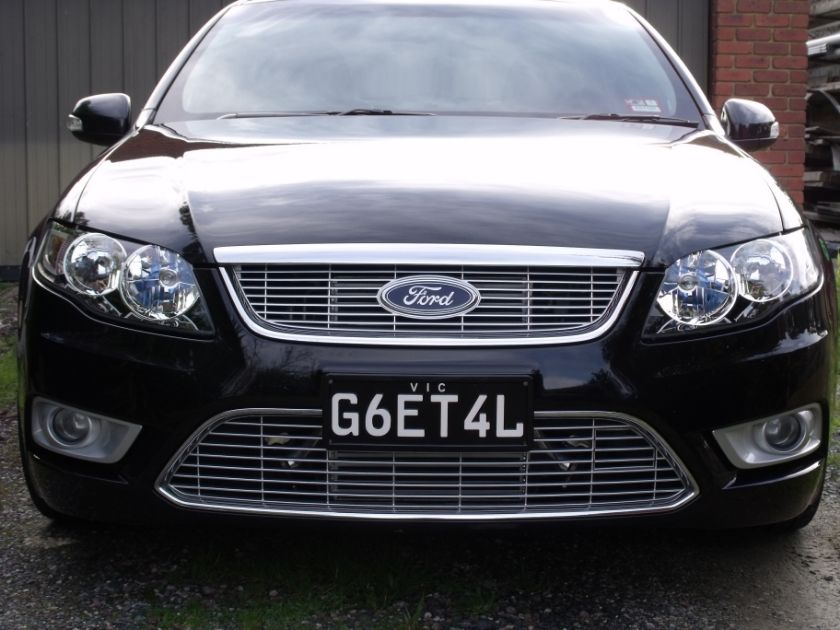

so one week on and have got my plate's for the car, along with some black headlight's (thanks to kyle) :good:
i also got a bigger cooler, but after to chatting with the tuner i realy dont need it for what i want from the car.....but while the front bar was off to do the headlights i put it in anyway.

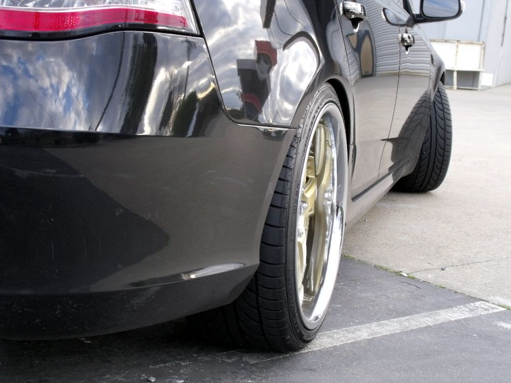

a set of super low spring's are also on the way...(i cant go to low due to driveway issues) :roll:

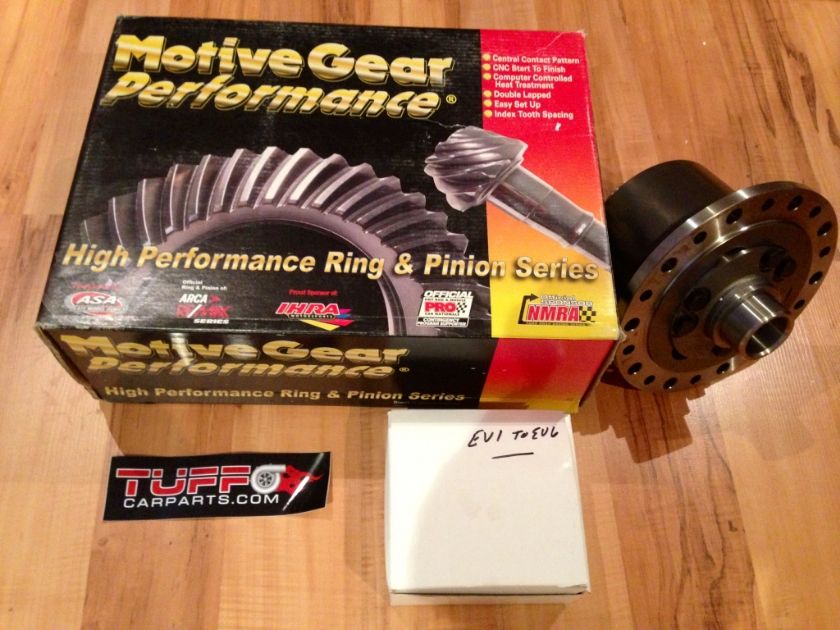

Postby SLY5LT » July 29th, 2013, 1:38 pm
cheers guy's :good:
got some stuff from you today justin ;)
bigger injector's, a TRU TRAC (as these have an open diff) and some 3:73's to liven it up a bit

Postby Parfrey » July 29th, 2013, 1:42 pm
Looking good mate! don't mind the black headlights either.
Jealous of you modding it so soon! :-P I want to do mine eventually.
Any reason for the 3.73 gears? Might need to get them to tune it to take off in 2nd all the time with the diff gears done.

Parfrey wrote:Any reason for the 3.73 gears? Might need to get them to tune it to take off in 2nd all the time with the diff gears done.
to be honest i bought the gears thinking that the stock ones would be 3:23
but later found out they are 2:73 :shock: i have seen on a couple of threads people running 3:73's so will see how they go.
Sundeep wrote:What's the tru-trac worth and how hard are they to install? Single's sucking the big one with so much power.
i'm sure justin will do you a good price on the tru-trac ;) it and the gears are still to be installed, it'll be done after the tune (cant get it done before)...as i pre booked in at blue power to get there july special.
who knows, i may keep the std gears & just put the try trac in ? :idea:

Parfrey wrote:Looking good mate! don't mind the black headlights either.
they make it look more angry !!!! :lol:
i'll also be redoing the grill's and fog light's a darker colour but still keeping the chrome surround.
a bit like the 50'th ann model's.... so they dont stand out so much & will blend in better.

Postby Sunboost » July 30th, 2013, 8:51 am
3.7's are what the manuals run, you sure you're not getting confused? Who is installing the Tru-Trac? Or you doing it yourself? Does it fit in the standard diff case? 10 years of fucking with cars and I still know nothing about diffs.
Re: My first "boosted falcon".
Postby crusty2 » July 30th, 2013, 2:46 pm
Sundeep wrote:3.7's are what the manuals run, you sure you're not getting confused? Who is installing the Tru-Trac? Or you doing it yourself? Does it fit in the standard diff case? 10 years of fucking with cars and I still know nothing about diffs.
Was going to ask the same thing,25years of fkn with cars here and a diff just does skids for me,would like to know how different the centers are to ef?.

Postby Parfrey » July 31st, 2013, 12:40 am
Looks like you've got some mint plans for it, should be nice and pokey with the diff gears but you would probably want some decent rubber on the rear to tame it down lol.
The diffs are a different setup to an EF being IRS.. and a bigger unit too. (bigger gears etc). Tru trac will go into the stock diff housing as long as its for a Falcon as I think the cheaper ones from the US need to be modded to fit?

Postby SLY5LT » July 31st, 2013, 1:43 am
yup, the LSD will fit straight in :good: kyle had one of these in his BF 'lane.
i'm still to sort out when it'll be fitted and if i'll stick to stock gears or slide the 3:73's in at the same time, i'll do some more research on the gears (should've done it first) :glare: ....
as i don't want the car to be a pig to drive with normal everyday driving.

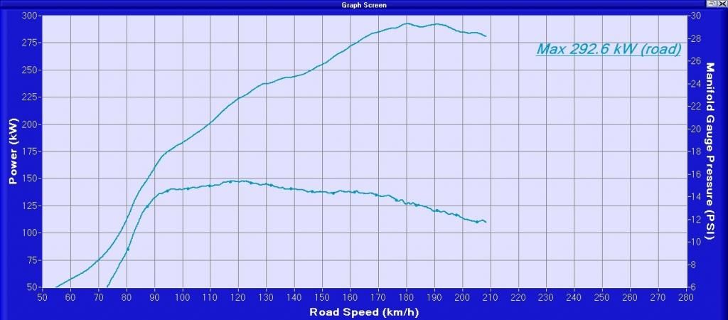

BLUE POWER worked their magic today and the result is.......... 292 rwkw's :drinks2:
i did hope for 300.... (the high end of the scale for those mods).... but are happy as pig in poop with the figure and how it drives.
292 rwkws isn't much for some on here, but it's the most i've had at the control of my right foot :P
not a bad gain..... around 70 rwkw's over stock for $2,700 spent !
the diff gears wont be going in, as a few have said before....there not needed after giving it a run tonight.
just need to fit the truetrac & then off to heathcote to see what it'll do :cool:

Postby SLY5LT » August 22nd, 2013, 2:03 am
i got some 550cc bosch injector's from TUFF CAR PARTS, Blue power fitted them along with a venom 5" hi-flow cat and i also got their CAI box....... which was free (july special) with the tune.
the power it's making seems to be around average for what's been done.

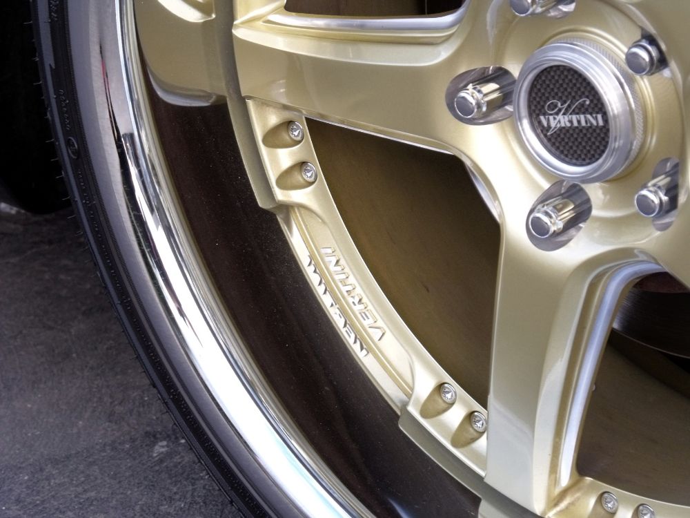

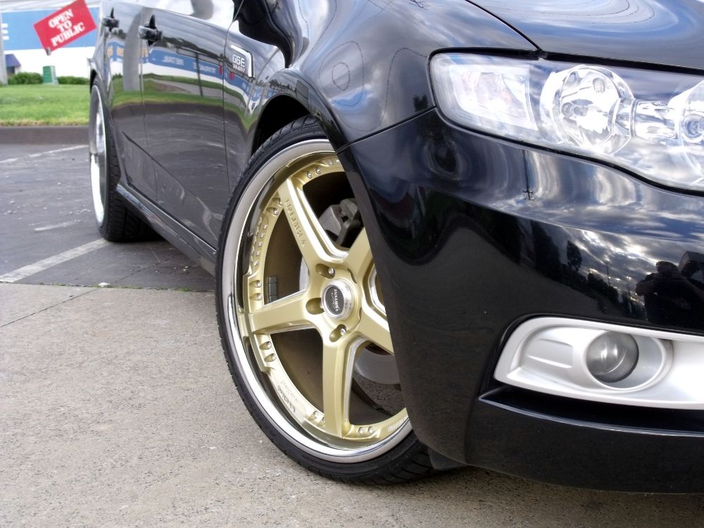

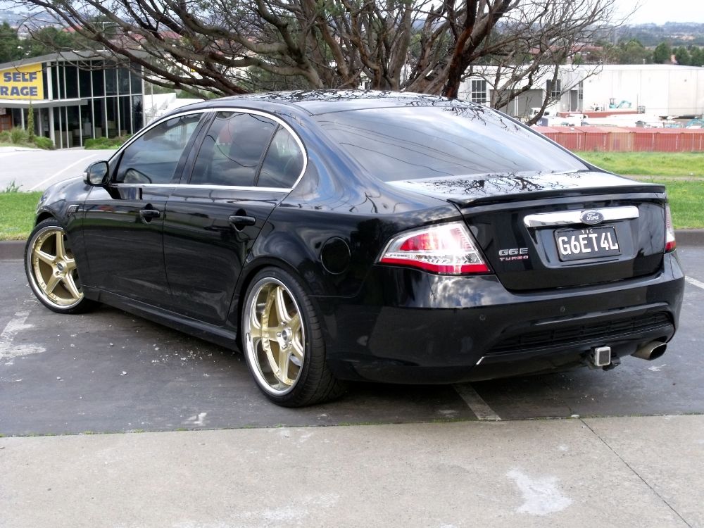

Postby SLY5LT » August 25th, 2013, 8:36 pm : Bipolar, fordpatto, nstg8a, XHBrad Likes this post
WOW !!!!!
i've only had this thing a month now.....and it all seems to be falling into place :yahoo:
i scored some new...(2 week old) VERTINI "DRIFT" rim's/tyre's last week 20X8.5".... 245's front, 20X10".... 275's rear.
i also got and fitted the kings SSL spring's last night, here's a couple quick snap's....

Postby nstg8a » August 25th, 2013, 8:47 pm : SLY5LT Likes this post
That is porn. :drinks2:

Postby icachn » August 26th, 2013, 12:54 am : SLY5LT Likes this post
looking good. :grin:

Postby justa6 » August 26th, 2013, 5:30 am : SLY5LT Likes this post
Wow. Looks perfect.

Postby NUT347 » August 26th, 2013, 8:29 am : SLY5LT Likes this post
That's awesome!

Postby SLY5LT » August 27th, 2013, 12:38 am
cheers guy's, gold rim's were never on the shopping list....i was thinking more black/chrome like i was going to put on the LTD, but they came up at the right time at a good price :grin:
if i was to buy them new i'd get 9.5" on the back so the tyre's fit better as i'm not into the stretched tyre look.
i've just got the grill's and fog light's to do....then the outside is done.

Postby justa6 » August 27th, 2013, 5:40 am
I think that amount of stretch looks good. It's not like your trying to put a 235 on it. Can always put a 295 on too.

Postby Bipolar » August 27th, 2013, 8:37 am
Was going to ask what you're doing with the grills, buy I'll just wait and see.
Always wondered what they'd look like in chrome to match the bezels/surrounds.
