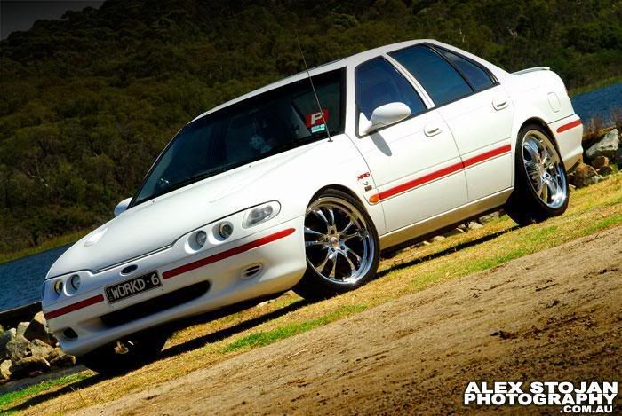

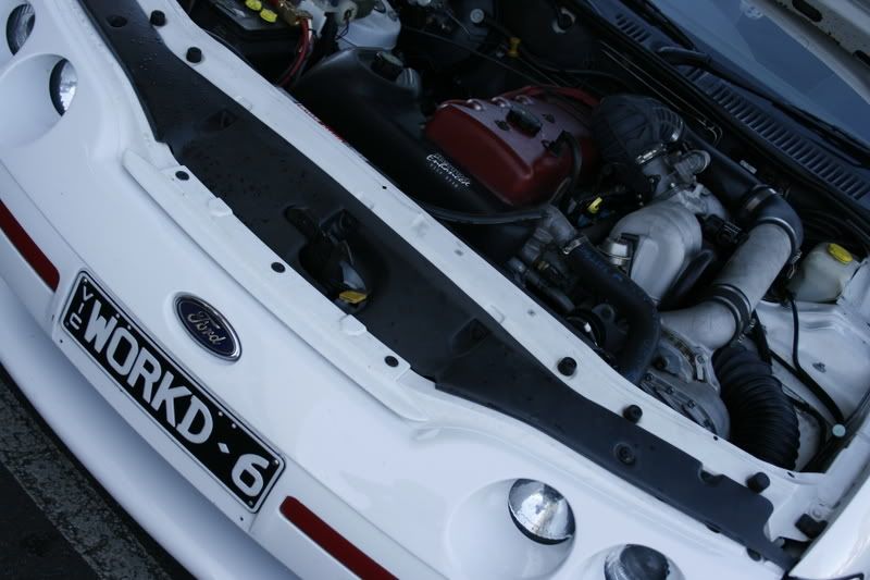

Postby obriza » July 13th, 2007, 7:11 pm
This is my supercharged EF XR6
it has a powerdyne supercharger. Last time it was put on the dyno a few months ago it pulled 190.3rwkw @ 10psi running very lean and in bad need of a tune.
heres some pics
enjoy
Mods still to come are a custom 3inch exhaust and extractors, venom kit, gangster tinting, C9 auto with stage 2 shift kit and 2500rpm high stall and a pearlescent black/plum respray

One question though: Why the C9 with a powerdyne?
Re: WORKD-6
Postby obriza » July 14th, 2007, 1:27 pm
the c9 is just cos i can... i was offered a c9 from a mate for $350 and it already has a 2500rpm hi stall and stage 2 shift kit in it. Its been strengthened to handle around 300rwkw so should be good... The only bad thing ive been thinking about with it is that its only 3 speed. Anyone think this is enough of a downfall to turn it down? to have it installed and everything it adds up to around $1200 including major service and everything.
