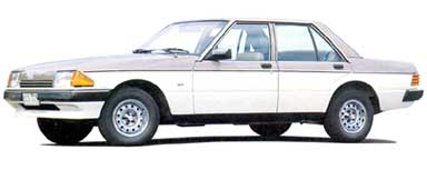

| How do I know it's an XE? Bonnet wraps over to meet small two-bar grille. Headlights are rectangular, tail lights have more flutes. Fairmont Ghia has wider headlights and snowflake alloys. All XEs have black door handles. | |||||||
