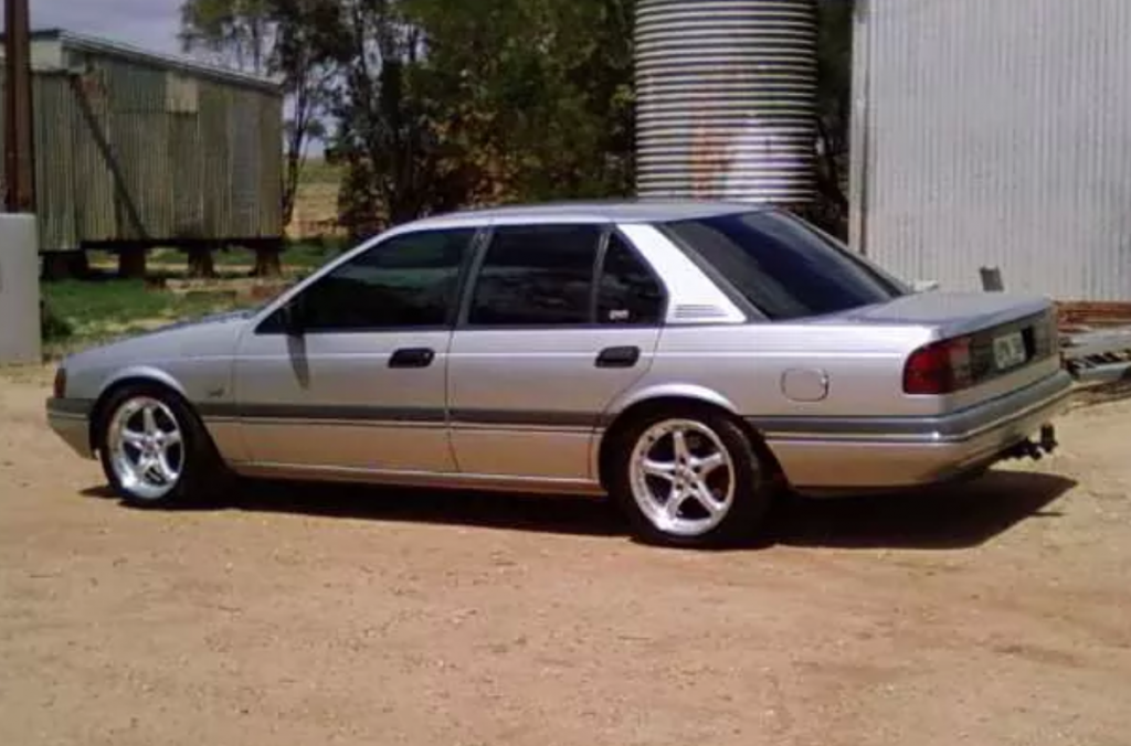

1988 ea fairmont, had it for 6 years, currently going through a full build after a bit of a hard life from the usual bits of fun... atm the car has been on jack stands for the last 18 months, been building the running gear as funds and time permits... heres a list of parts so far:
-ef reco bottom end
-eb xr6 head reco, port and polish, 35 thou off)
-222825 crow cam and vernier cam gear
-xh serpentine conversion
-ed btr with shiftkits adjustable shift kit
-dc ltd 3.27 lsd
-king superlow springs and monroe shortened shocks
-au upper control arms and adaptors
-all wiring and dash is now ed fairmont ghia front to back
-advance extractors
-100cpsi walker cat with custom mandrel bent 3" zetti exhaust
-shiftkits smart lock cheater
More parts to come in the next few weeks but atm im having enough headaches with the last of the wiring. Hoping ti have it all finished this weekend. Then its time for the stereo and make sure everything that's in there is all good, theb it comes off the road and i have a garrett gt3540 lined up, a ems stinger and some boost for it to chew on...
This is what the car will be back to when im finished paint and panel, atm its slightly sad.
