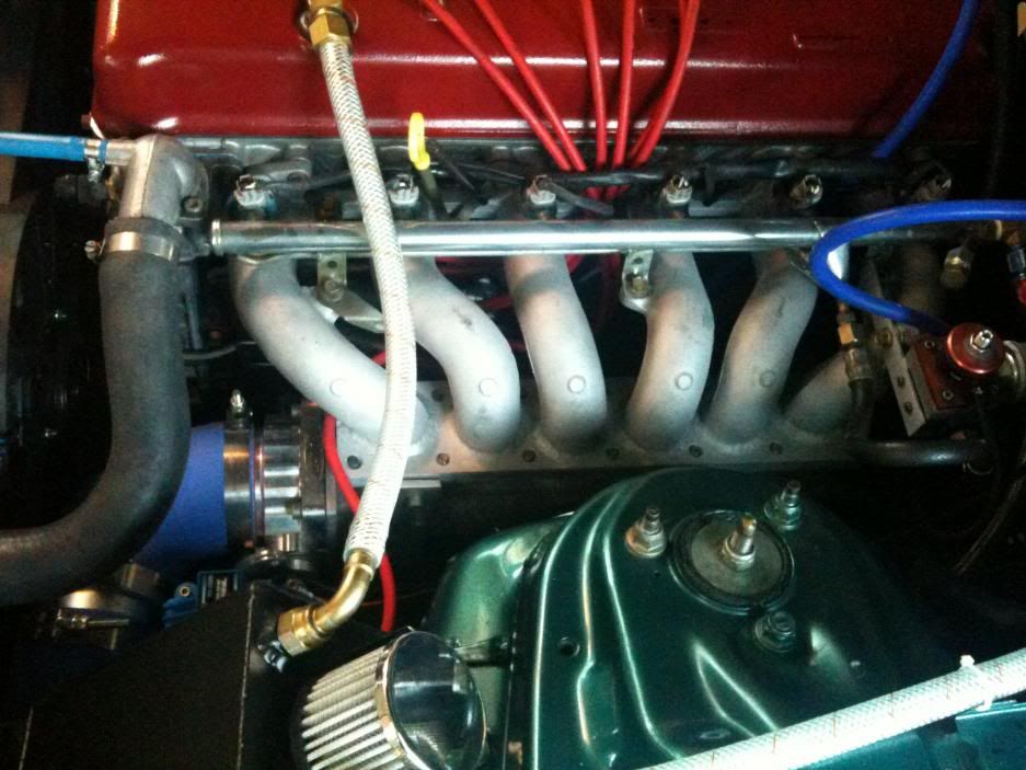

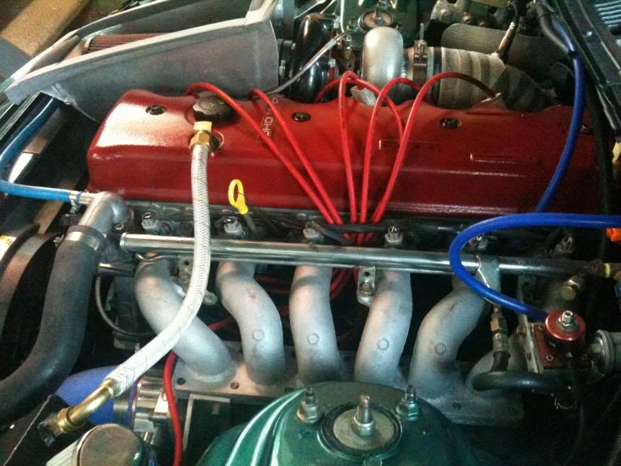

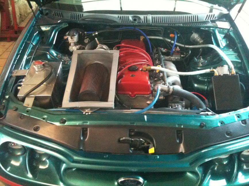

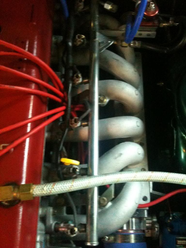

Postby Hiboost » July 3rd, 2010, 12:59 am
this is the current engine pics of Rods car. look like a heavily modded manifold to me.

Postby EFFalcon » July 3rd, 2010, 7:51 am
lol Hiboost, i think you're spot on there.
Hard to say a plenum is a waste of time when its being compared to modified manifold that is pretty much an 'upside' down plenum.
Re: 8 second 4.o litre info on fullboost
Postby misk » July 3rd, 2010, 8:11 am
lol very shifty!
interesting though, i wonder when a complete standard manifold was last used.
really without seeing one of those close up pics anyone would think its 100% standard
i wonder whats been done to the insides..

Postby Dansedgli » July 4th, 2010, 6:15 pm
He mentions what was done on fullboost.
Postby needfordspeed » July 4th, 2010, 6:18 pm
Exactly right on the flanges (runners cut in order to port entire length!) but plenum is still standard with a new throttle body-flange welded in place of original.
