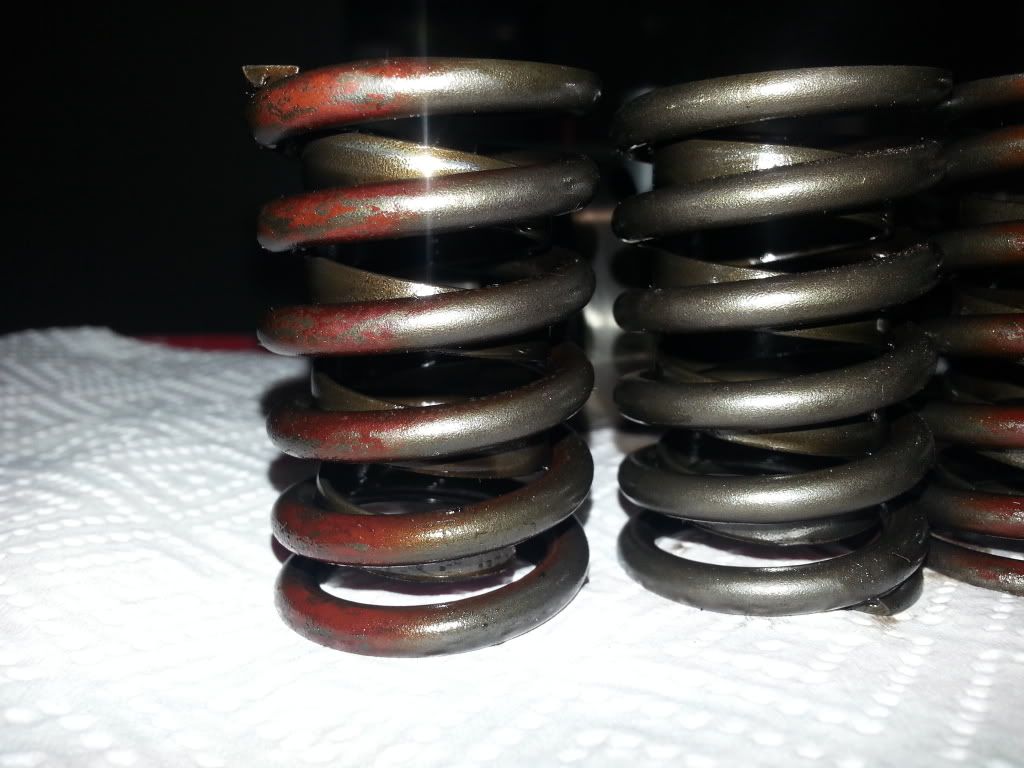

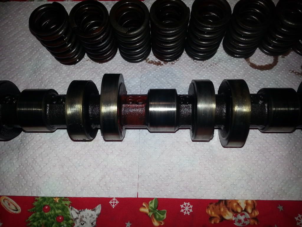

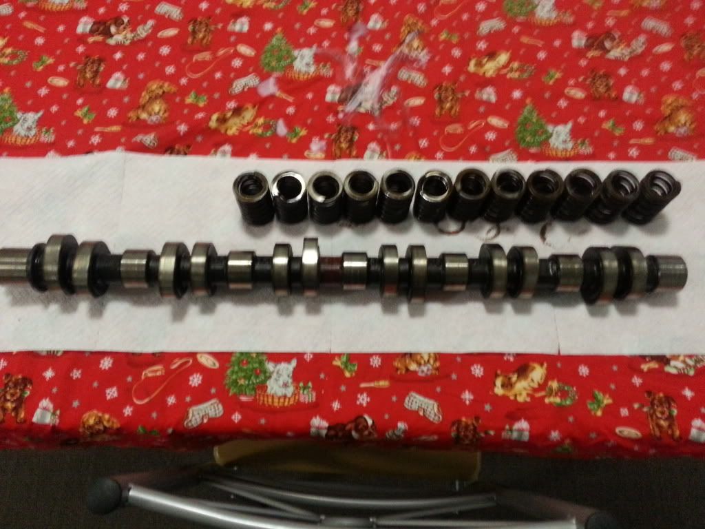

Buy these off me !
Xr6 valve springs, xr6 cam - ea/el
Originally from el xr6 head.
