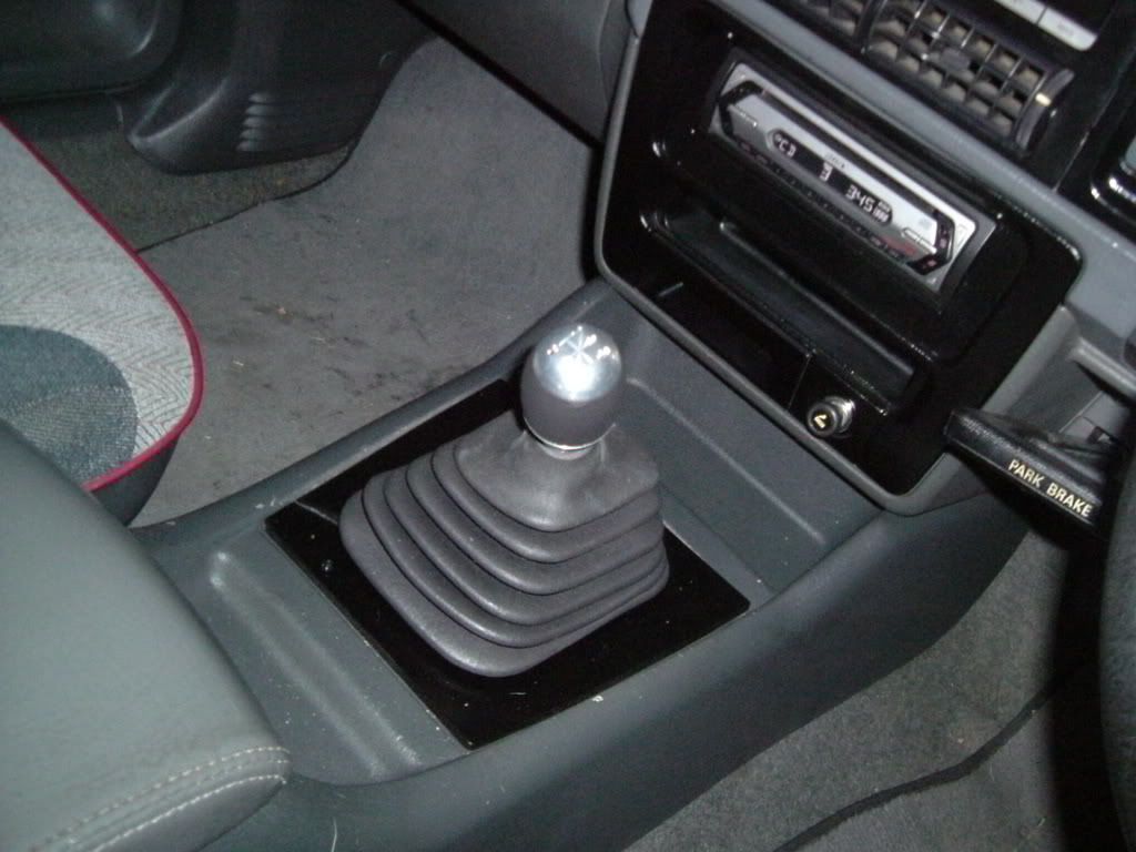

Yer mate i did the manual conversion all by my sellf it took me 3 days just takeing it easy and having to wait for a spigot bearing and oil slowed me down a day.I found while doing the manual pedale box is a shit you wont like doing that but when your finished its a good fealling :P seeing a clutch pedal there :P Umm when doing the manual pedal box you will have to bring the dash forwards, and i took my drivers seat out to make room and i completely droped the colum on the floor.Do the pedal box first so you got the shit thing out of the way because fiting the box is easy,Doing the thermo fans was a peace of piss to do if you have the right radiator with the mounting points on it.Remember when takeing the clutch fan off it a left hand thread :P .let me no if you want to no anything else about the manual conversion ;)

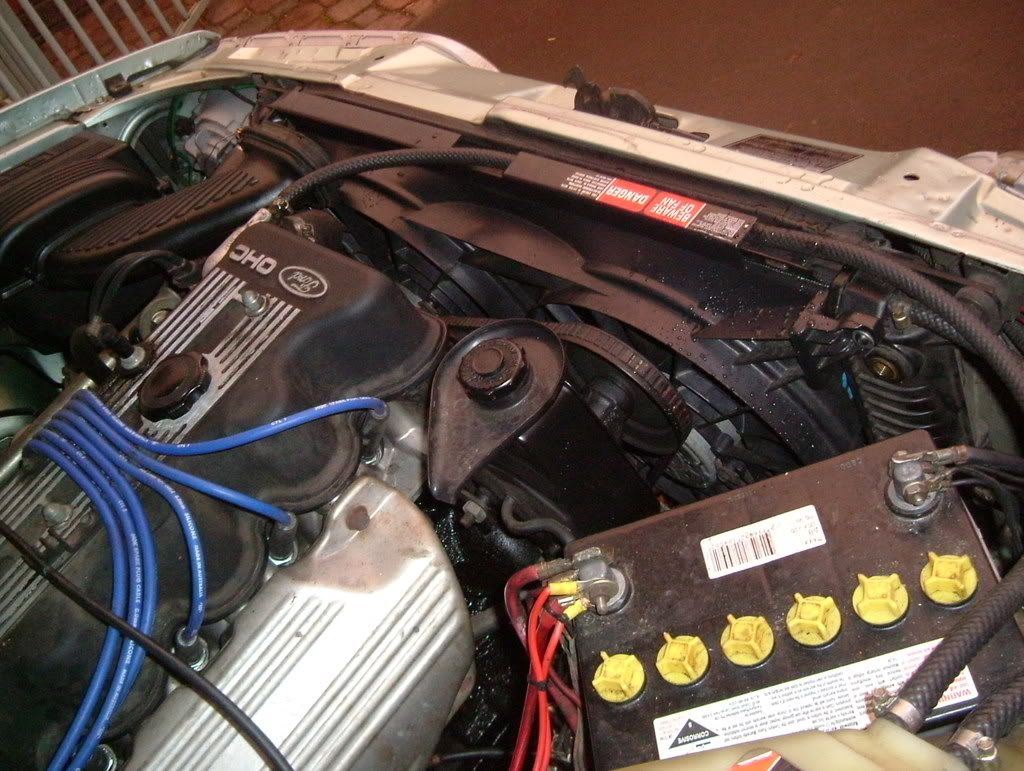

Hey mate well i put el thermo fans in mine i think the ef ones are 2 speed but that doesnt mater umm i when to bursons and brought a davies craig thermatic switch kit for 50 bucks and 2 40 amp relays and 2 30 amp fuse holders and i had the wire try and make sure you get some decent shit because they do draw a bit.For performance side of thing well yes i did definently notice some diference it acelerates alot quicker now and sound so much like a newer car now and all you here now is a nice exhaust note :P .you need any pics just ask mate ;)

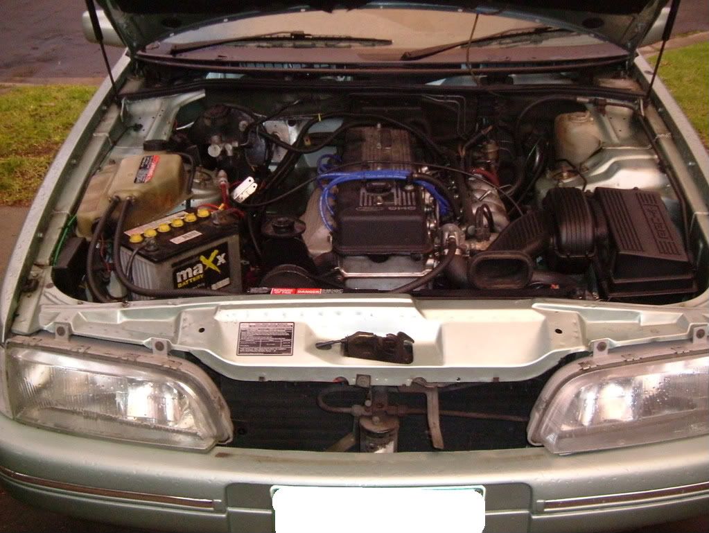

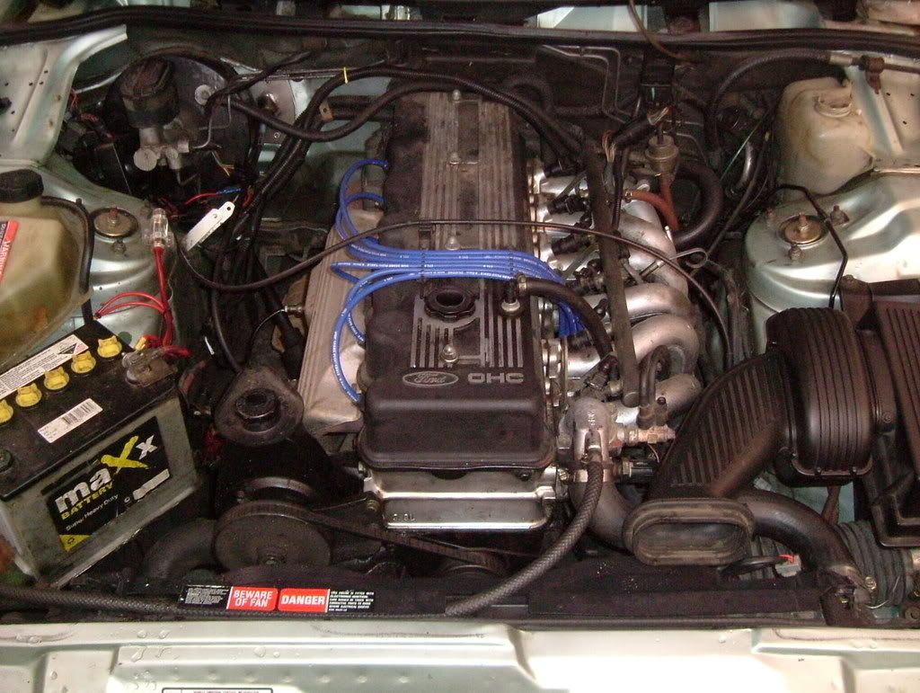

cheers heaps dude ill let you know but an engine bay pic wouldnt hurt if you put one up

Postby travs ea-xr6 » July 25th, 2008, 8:49 pm
yer no worries mate i will get some for you tomoz to dark now ;)

Postby travs ea-xr6 » July 31st, 2008, 9:17 pm
Sorry Ea-Falcon i will take them pic of my engine bay for you,what else do you want me to take a pic of on the car ;)

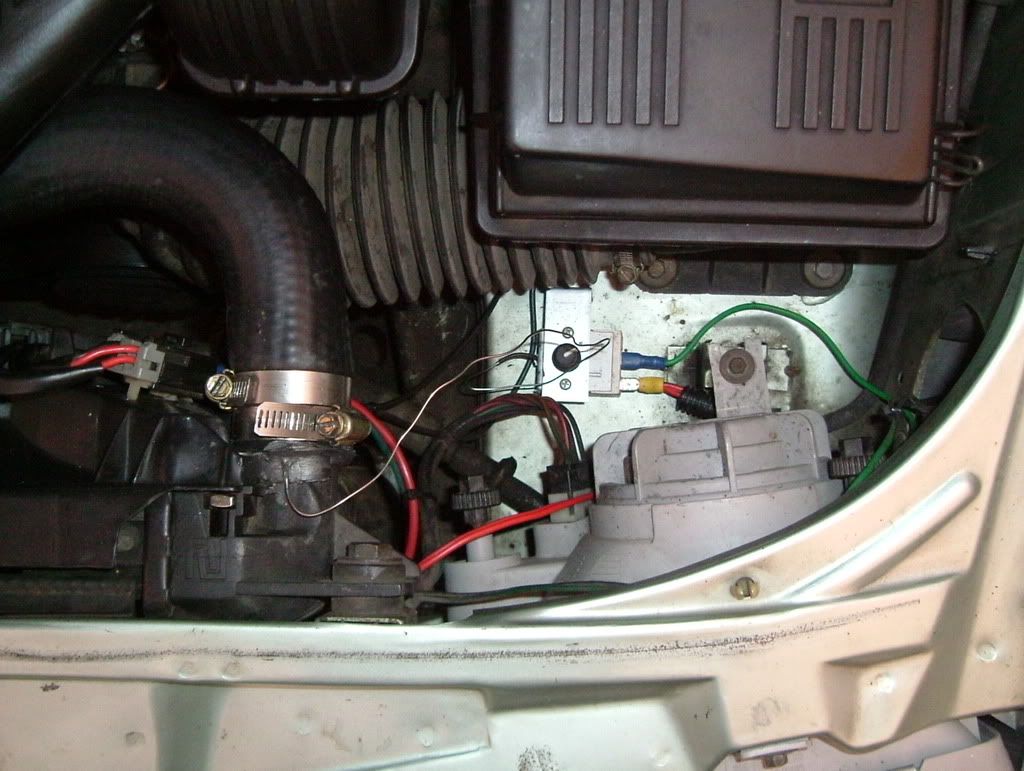

Postby huggiebear » August 5th, 2008, 7:43 pm
looking at your thermo wireing makes me wanna redo mine...

Re: MY EA S PACK
Postby travs ea-xr6 » August 5th, 2008, 7:56 pm
haha really mate show us a pic of your themofan wireing.
