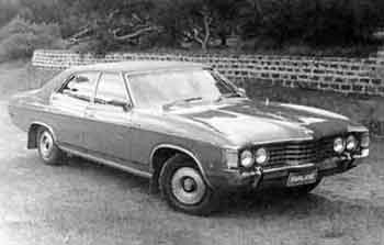

| Ford ZG Fairlane / P5 LTD/Landau | |||||||
| On Sale: November 1973 - May 1976, LTD: August 1973 - September 1976 | |||||||
| How
do I know it's a ZG? Update of ZF brought egg-crate grille, Ford badge
in right side of grille, Fairlane badge in centre of bonnet. How do I know it's a P5? Headlights hidden by full width grille, vinyl roof, parking lights in bumper, side indicators on rear guard, squarer boot. |
| Models available: | |||||||
| Whats new? Four wheel disc brakes, equipment upgrades | |||||||
| Firsts: LTD, LTD most expensive car produced in Australia | |||||||
| Prices at introduction: Custom sedan - $4491, 500 sedan - $5201, LTD - $7770, Landau - $6950 | |||||||
| Total ZGs built: 19556, LTDs: 7003, Landau: 272 | |||||||
| Transmission: 3 speed automatic | |||||||
| Engines: 4.1 250 cubic inches (4.1L) 6 cyl Bore and stroke: 3.68 x 3.91 inches Power: 155bhp (116kW) at 4000rpm Torque: 240lb-ft (325Nm) at 1600rpm Pushrod overhead valve, 2 valves per cylinder Fuel system: Single throat carburettor Compression ratio: 9.1:1 |
5.0
302 cubic inches (5L) V8 Bore and stroke: 4 x 3 inches Power: 240bhp (180kW) at 5000rpm Torque: 305lb-ft (414Nm) at 2600rpm Pushrod overhead valve, 2 valves per cylinder Fuel system: Two barrell carburettor Compression ratio: 9.4:1 |
| 5.8
2V 351 cubic inches (5.8L) V8 Bore and stroke: 4 x 3.5 inches Power: 260bhp (194kW) at 4600rpm Torque: 355lb-ft (481Nm) at 2600rpm Pushrod overhead valve, 2 valves per cylinder Fuel system: Two barrell carburettor Compression ratio: 9.1:1 |
5.8
351 cubic inches (5.8L) V8 (LTDs only) Bore and stroke: 4 x 3.5 inches Power: 290bhp (216kW) at 5000rpm Torque: 380lb-ft (515Nm) at 3200rpm Pushrod overhead valve, 2 valves per cylinder Fuel system: Autolite 4300 4 barrell carburettor Compression ratio: 11:1 |
| Fuel consumption: 13.5mpg (LTD 351, Motor magazine) | |||||||
| Performance
(Fairlane 500 2V 351, 3 spd auto): Top speeds in gears 1st: 65mph (105km/h) 2nd: 88mph (142km/h) 3rd: 111mph (179km/h) 0-60mph (0-97km/h): 10.1 seconds Standing quarter mile (402m): 17.9 seconds |
(Landau
351 V8, 3 spd auto): Top speeds in gears 1st: 50mph (80km/h) 2nd: 82mph (132km/h) 3rd: 118mph (190km/h) 0-60mph (0-97km/h): 9.8 seconds Standing quarter mile (402m): 17.4 seconds |
| Suspension: Front Independent angle poised ball-joint type, heavy duty coil springs with hydraulic shock absorbers, torsion bar ride stabiliser with antidive geometry. LTDs have wish-bones and anti-roll bar. |
Rear Live axle, semi-elliptic, assymetrical, variable rate leaf springs. Diagonally mounted hydraulic shock absorbers, rubber bushed shackles and iso-clamp axle mounting |
| Brakes: Front Floating caliper type power assisted discs, ventilated 11.25 inch diameter. LTD servo assisted. |
Rear 10 inch drums with bonded linings. LTD servo assisted 11.25 inch discs |
| Steering: Recirculating ball, variable ratio power steering standard on Fairlane 500 and LTDs, optional on Custom | |||||||
| Wheels: Pressed steel disc 6JJ wheels with safety rims. LTD: 15 x 6 wheels, die cast wheel covers | |||||||
| Tyres: 7.35 x 14. LTD: E70HR x 15 whitewall | |||||||
| Dimensions
(Fairlane - see ZF Fairlane)
LTD: Length: 203.8 inches (5177mm) Width: 74.8 inches (1900mm) Height: 54.3 inches (1379mm) Wheelbase: 121 inches (3037mm) Front track: 60.5 inches (1537mm) Rear track: 60 inches (1524mm) Kerb weight: 3950lb (1792kg) Turning circle: 42.2ft (12.9 m) Fuel tank: 17.5 gallons (80 litres) Boot space: 31.3 cubic feet (890 litres) |
Interior
dimensions (LTD): Front headroom: 38 inches (965mm) Rear headroom: 36.5 inches (927mm) Front shoulder room: 60 inches (1524mm) Rear shoulder room: 60 inches (1524mm) Front hip room: 60.2 inches (1529mm) Rear hip room: 60.2 inches (1529mm) Front legroom: 40.7 inches (1034mm) Rear legroom: 42 inches (1067mm) |
Features: Legend
| Awards: | |||||||
| Fairlane
Rivals: Holden HQ/HJ Statesman, CJ/CK Chrysler. LTD Rivals: Holden HQ/HJ/HX Statesman Caprice |
