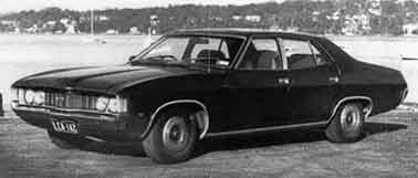

| How do I know it's a ZF? All new rounded body based on XA Falcon. Horizontal dual headlights in full width grille (eight rectangles, bulging centre, badge in centre of grille) with wraparound clear indicators. Fairlane Custom has name on front guard, Fairlane 500 has chrome strip below doors and along wheel arches. | |||||
