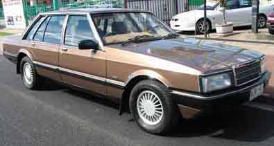

ZL Fairlane / FE LTD Photos (photos are cropped, click to enlarge)
Ford ZL Fairlane / FE LTD
On Sale: October 1984 - May 1988 (Unleaded update: January 1986; Update: October 1986)
How do I know it's a ZL? Larger grille with chrome surround, two horizontal bars and Ford badge in bottom right corner, wide rectangular headlights, wide tail lights with horizontal line dividing indicator and brake. January 1986-: indicators in front bumper surround. October 1986-: snowflake alloy wheels, brighter grille, body-coloured sill
How do I know it's a FE? As for Fairlane, plus: LTD grille (vertical bars), bonnet ornament, body-coloured mirrors, C-pillar window louvres, flush-design alloy wheels, LTD boot lock.
