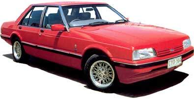

| How
do I know it's an XF? Rounded front nose. Rounded slimline headlights
with clear indicators, grey grille has Ford badge in centre with 2 horizontal
slats on either side, mirrors are curvier. XF 1/2: Body-coloured grille and bumpers. |
