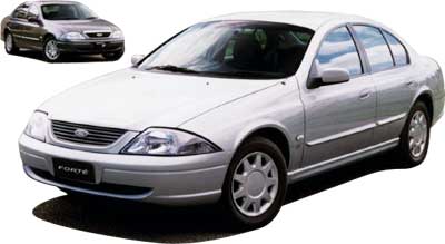

| Ford AUIII Falcon | |||||||||
| On Sale: November 2001 - October 2002 | |||||||||
| How do I know it's an AUIII? Visually very similar to Series II. Series III badges, standard body-coloured mirrors and side strips, side skirts, clear side indicators, darker shade headlights. | |||||||||
| Whats new? Equipment and styling tweaks, REX | |||||||||
| Falcon Firsts: ABS brakes standard across the range. | |||||||||
| Prices at introduction: Falcon Forte auto sedan - $32515, Fairmont sedan - $39290, Falcon XR8 manual - $48420 | |||||||||
| Total AUIIIs built: 31320 | |||||||||
