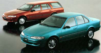

| Ford EF Falcon | ||||||||
| On Sale: August 1994 - October 1996 (Series II: October 1995) | ||||||||
| How do I know it's an EF? Evolution of EA design. Slimline headlights, body-coloured door handles, semi-circle taillights, curvy mirrors. GLi and Futura: No grille, body-coloured mirrors & bumper strips (Futura). XR6, XR8: Based on Futura, with quad-headlight design, alloy wheels, body kit. Fairmont, Fairmont Ghia: Fake grille, rear chrome applique, alloy wheels, chrome highlights. | ||||||||
