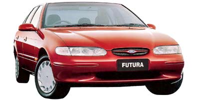

| How do I know it's an EL? GLi and Futura: Oval-shaped grille with Ford badge, bulging bonnet, rear amber indicators (wagon has clear rear indicators). XR6, XR8: Like Futura, with new quad-headlight design, spoiler, body kit, with red or black side stripes. Fairmont, Fairmont Ghia: Formal chrome grille, chrome stripes, sedans have rear number plate surround. All models have new badges. | ||||||||
