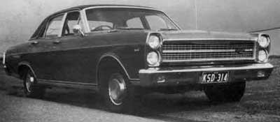

| Ford ZD Fairlane | |||||
| On Sale: November 1970 - March 1972 | |||||
| How do I know it's a ZD? Fairlane now has one grille instead of two, with an egg-grate design, tail lights have horizontal divisions. Fairlane Custom has chrome side strip with vinyl insert, Fairlane 500 has rear chrome strip across boot. | |||||
